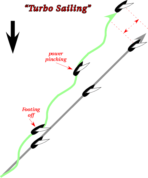

The simplicity of footing off is using the sails and the momentum of the boat to accelerate to a higher speed using the extra POWER that is generated from the maneuver. (For those with math and science backgrounds this is changing potential energy into kinetic energy.) The essence of footing-off is that you are 'artificially increasing' the apparent wind across the sails !!!!!

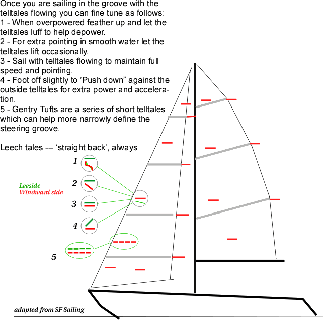

Footing off can be done by several options - by trim changes (Don's example of dropping down towards a close reach) or by simply bearing off slightly with the rudder and loading up the windward side of the sails with the sail trim held constant.
Footing off increases the apparent wind speed. When beating footing off results in faster boat speed due to the increased apparent wind but the angle to the 'destination'/mark also widens .... so you wind up going faster but need to sail more distance; hence a 'wash'.
However, the 'ultimate masters' of sailboat racing use footing off to good effect .... they continually foot off to accelerate to higher speeds at more open sailing angles and then use the increased boat speed, increased apparent wind speed and the built-up momentum to then 'point up' even higher, ... until the boat speed begins to drop, and begin all over again in a cycle between footing off and pinching up .... ...... and you usually see the 'masters' never sailing in a straight line 'beat'.
What happens with the faster speed is the keel gives better lift, their boats seemingly 'climb up to weather' (in comparison to those who sail 'straight') during the end of the 'pinch up' phase until the boat speed begins to fall off then they go back to a 'foot off' to regain speed and momentum AND increased apparent wind across the sails !!!! This puts the boat on a gentle but constant "S" course - alternating between footing off and power-pinching up. These are the folks who ARE ALWAYS first at the the 'mark' and the ones who ultimately win races and/or arrive at far distant destinations way before anyone else.
In flat water and constant winds this footing off/power pinching "S" course is called 'turbo sailing' and results in average higher sailing angle 'result', and is much faster than sailing in a straight line when beating ... its nothing more than footing off with the sails held constant (allowing the leeward luff tell tales to begin to 'rise' or begin to separate stall), accelerate to higher boat speed (which causes the apparent wind to go further aft !!!!!!) and then using the gained speed and momentum to 'pinch up'.
For simplicity sake for 'turbo sailing' simply alternates between #2 & #4 in the above 'pic'.
Turbo Sailing is illustrated in the below 'pic'. Your choice if you re-trim the sails .... or simply steer with very slight rudder movement while watching the TELL TALES alternate between #2 & #4 ..... 'best' seen on the row of 'gentry or steering' tell tales.
Note - power pinching: when the boat is at max. accelerated speed after footing off, power pinching can be 'enhanced' by slightly over-trimming the mainsheet which causes the leech shape to slightly 'hook-up' to weather shape during the initial phase of the 'power-pinch'. Doing so is like putting the 'flaps down' during the landing of a large aircraft .... you get tremendous 'lift' at lower speeds by the increased angle of attack and increased draft.
