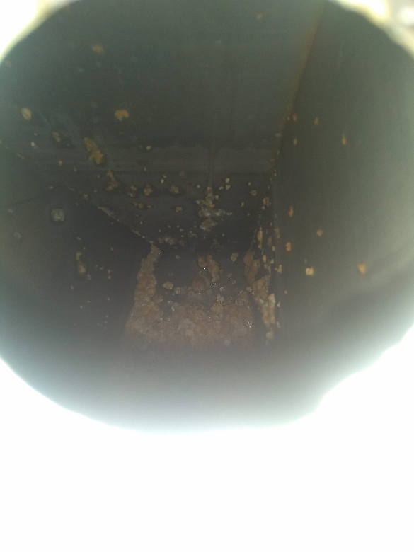

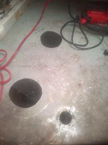

Ok started working on the forrepeak. Tank inspection is top of the list so I got everything dismantled and purchased a large inspection cover from Poo Marine. Outside of the tank appear solid which is good! I took out the fill level gauge to take a peak and I had forgotten about the baffles. There are at least 2 one running fore and aft and another amidships. So Im trying to figure out if Im best served by getting 4 smaller ones or cutting directly in the center, notching the cover plate to fit around these and having reduced access. Already asked B757Captain if he recalls what it looks like on the inside.
Heres a peak inside through the fill level gauge hole.

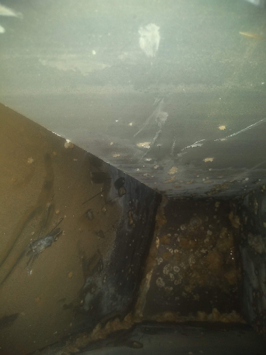

Well the sediment in the tank turned out to be corrosion :( So this weekends job is pretty much going to be sticking my arm down through small holes and wire wheeling by feel!! Joy
