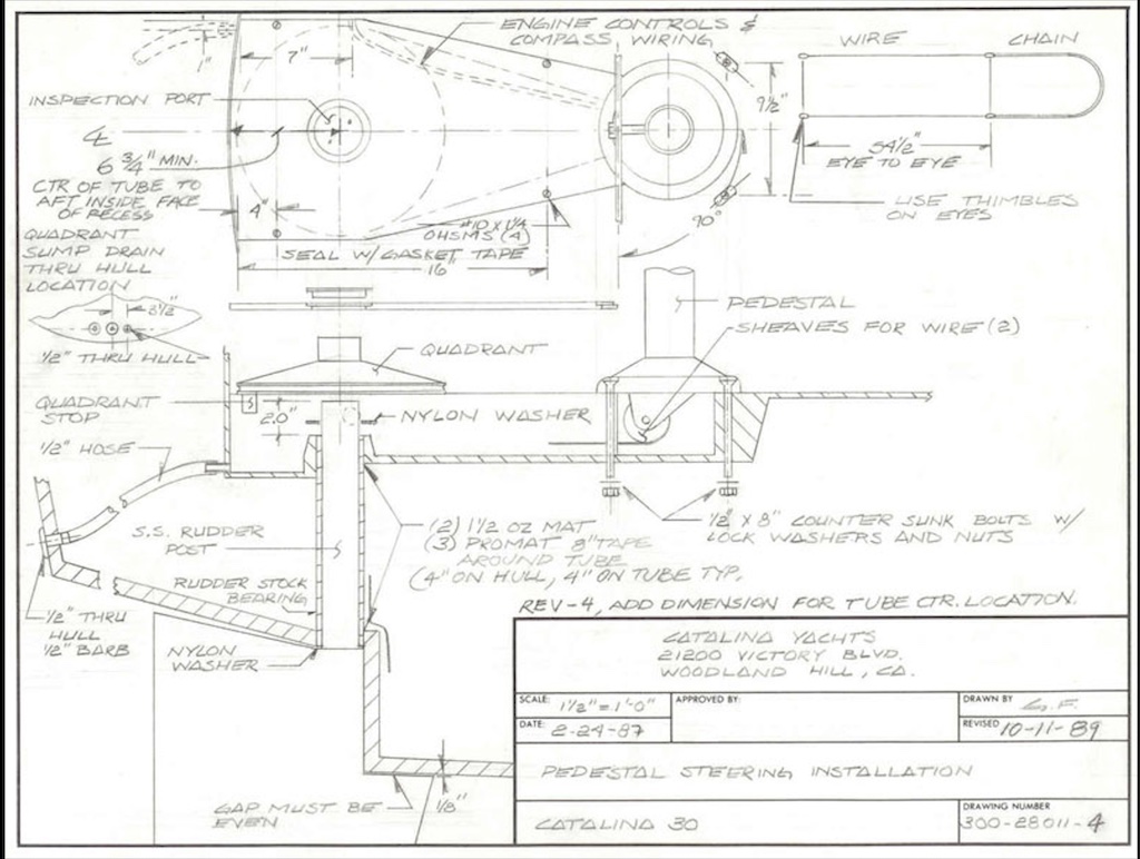

Hi Ralph,
I know on my 93 and on a friends 95 and according to the attached diagram from Catalina, the rudder tube extends above the water line into the steering mechanism compartment. There is no packing at the top of the tube that can leak.
That compartment has a drain in the bottom at the aft wall. You can barely see it because of the radial wheel. Dirt can easily plug that drain. I back flush it from the stern with a hose to clean it out. If the compartment fills with water it could make its way to the bilge but that wouldn't leak just when running.
Since you only get the water when running I'd take a look at the two lower stern thru hulls and the exhaust exit fitting on the stern. Under power they can be at or slightly below the water line. Failed sealant could allow water to seep in around one of the fittings, into the stern and make it's way forward.
On my 93 there is a removable teak panel, about 12 x 12, on the aft bulkhead of the quarter berth. Remove that panel and you have pretty good access to view that area of the stern. I think the 95 also as compartment lids on both sides of the helm seat that may give you a good view of that area.
Attached is diagram of the steering system from Catalaina.

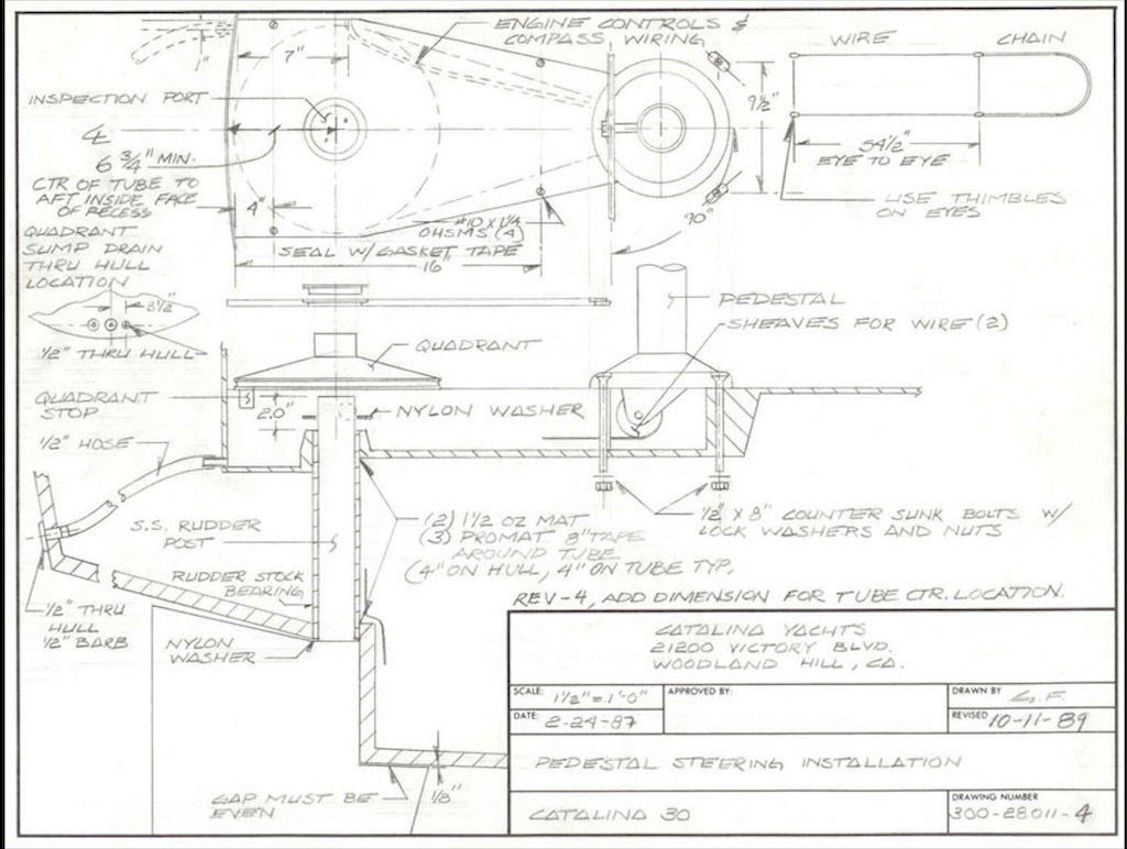

Hi Ralph,
Thanks for the heads up Ward. I will examine it when I am able to get to the boat over the next few days. I do keep the drain clean, but am concerned about the 2 nylon fittings top and bottom….. more about the bottom one.
