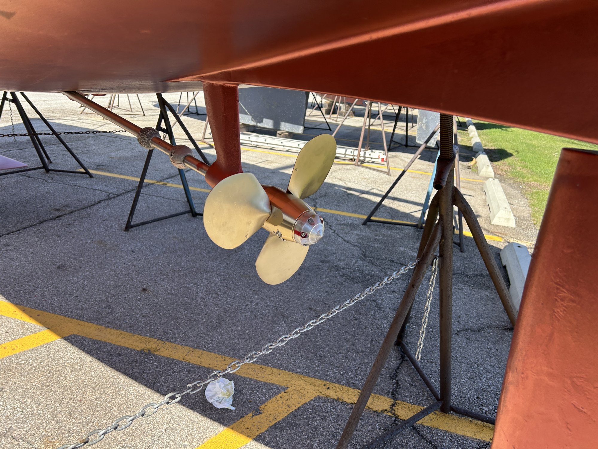

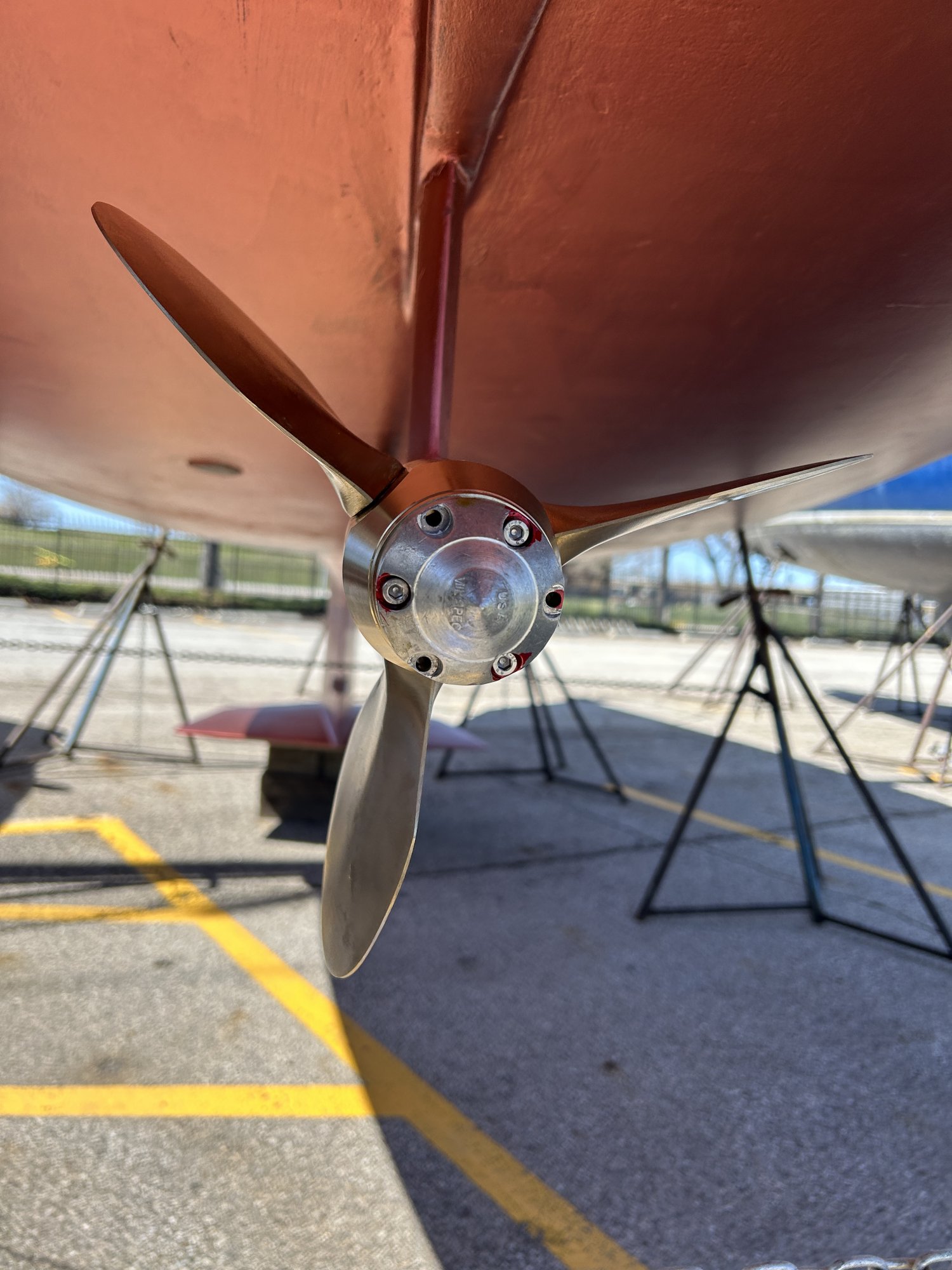

Not sure which is better…folding for feathering. I debated for a while and finally bit the bullet and bought a 3-blade MaxProp feathering prop. I was sold on the reverse thrust. And the fact that I can adjust the pitch if I need to. But my buddy out sails me some days, and he says it is because he sails a folding prop (but 2-blade).
Fred Hutchison at PYI can give you a quote on the right size prop for your boat. He was very helpful.
I am going to be launching my boat soon, and I am going to tweak the pitch 1 or 2 degrees before I splash to see if I can get a little more speed with out bogging the engine down. I could even adjust the pitch in the water if I had to (but don’t plan to!).
They are a thing of beauty!
