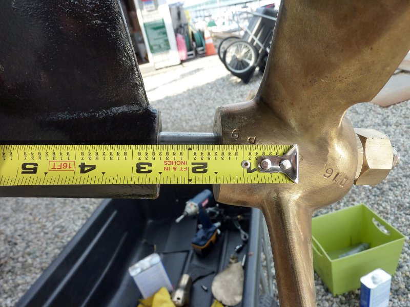

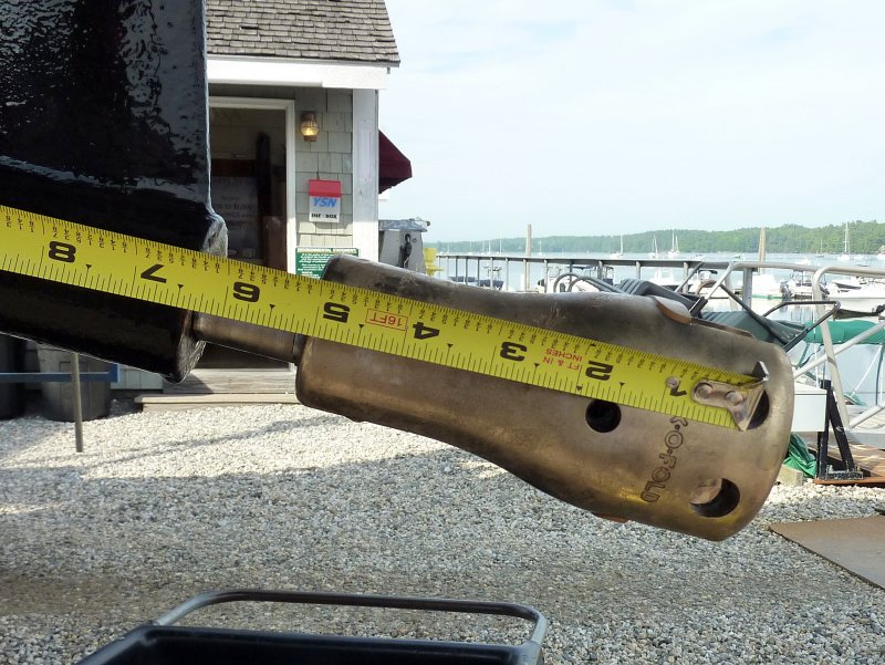

Here's where I feel the problem of shaft whip gets greatly compounded. This is the difference between the fixed prop blade centers, beyond the bearing, and the folding prop.. The difference in overhang between the fixed prop and folding, beyond the cutlass bearing, is a full 3 3/4" ! :eek:
This is the Flex-O-Fold hub. Sorry, but I was hanging in the slings and did not want to tie up the yards lift for long. This was literally a ten minute swap out. Unfortunately before I remembered to snap the shot I had taken the blades off the FOF. Does not really matter though the "pin hole" is where the blades are centered. This is about 6 3/8" beyond the cutlass bearing.
This is the Campbell Sailor which is about 2 5/8" from the bearing to blade centers...:

The hub of a folder moves the blades aft. This aft placement, beyond the cutlass, can cause shaft whip. Fixed props keep the blade centers closer to the cutlass bearing. Some feathering props and all folders move them considerably further aft which can lead to vibration problems especially on longer shafts...
With the CS prop the blade centers are about 2.75" from the cutlass with the FOF the blade centers were closer to 7" from the cutlass..That is a huge difference.
