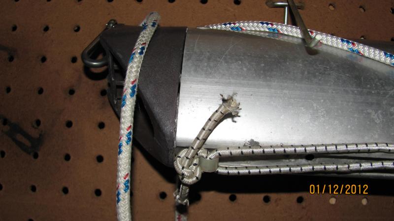

For sail ties, I adopted this method several year ago: http://www.cncphotoalbum.com/doityourself/sailties/sailties.htm Many thanks to Colin Jarman for this neat idea.
Unlike the way Colin Jarman has his bungee attached at both ends of his boom, I use two bungee cords and tie each end to an eye strap at each end of the boom. This way, I can remove the slack in the bungees a lot easier at either end as the bungees stretch out and sag in time.

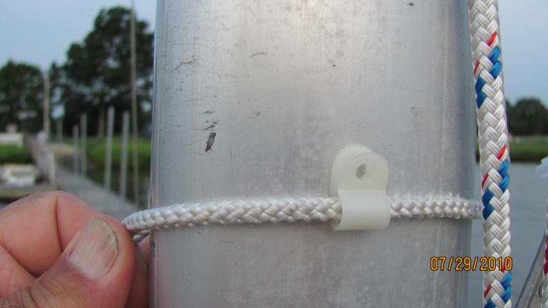

Sail slides in a mast can present a problem when you lower the sail. They have a tendency to slide out of the sail track. They make these doo hickies that fit into a sail track and can be secured with a knob that's on it. Personally I think they are a pain in the butt. What if you lose it?

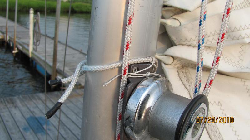

Fortunately for me, I have a mast winch just above my sail slot feed through opening and I'm able to use a 3/16"X15" piece of braid and tie it around my mast under the sail slide.
If you encounter this problem and have no mast winch, you could always use a nylon wire clip screwed to the mast. I usually tie a slipped reef knot in this braid line and it works like a champ for me.
