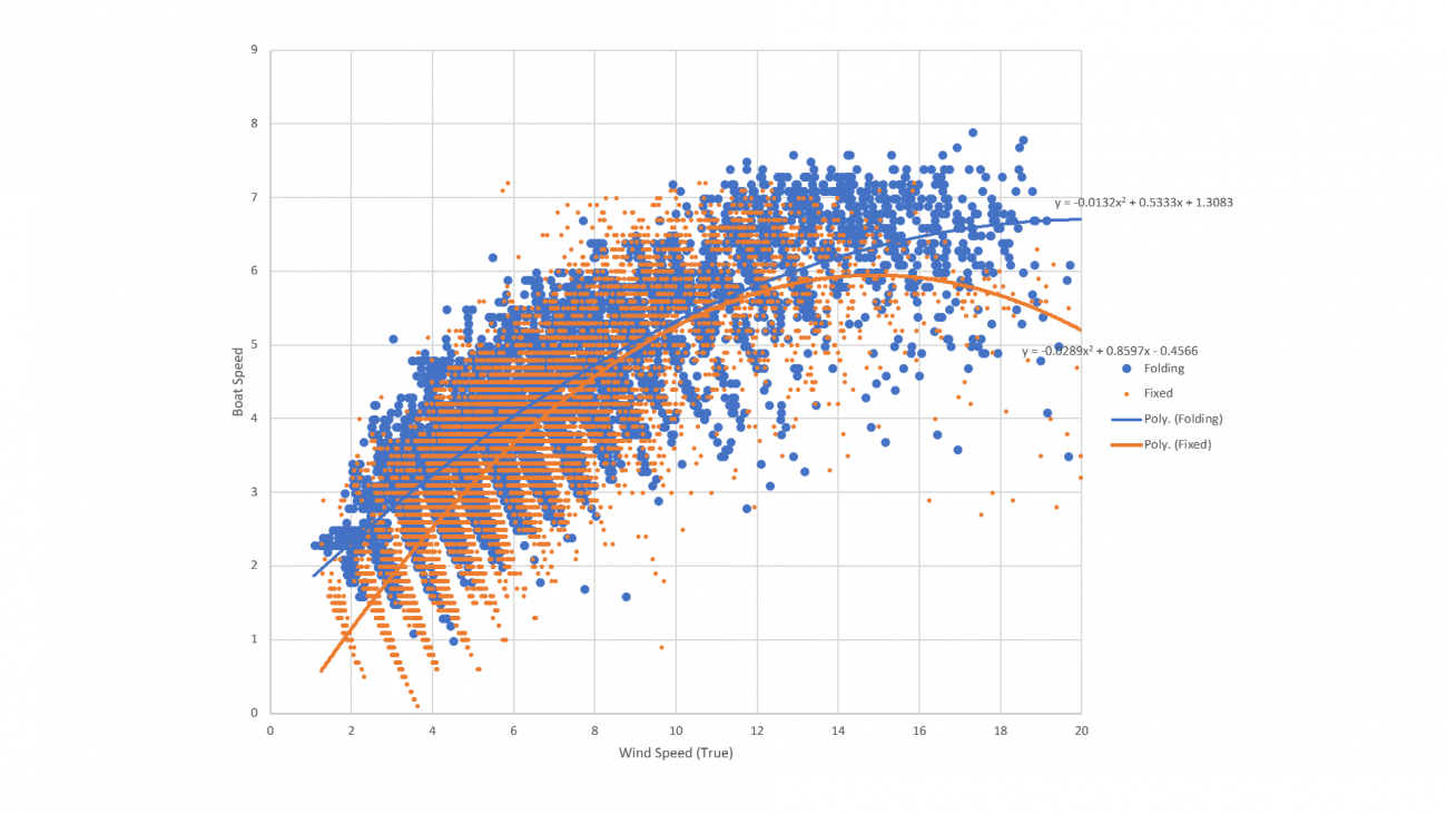

Third'ed. We went from a fixed 3 blade to Flexofold 3 blade and picked up at least half a knot at low wind speeds, maybe close to a full knot. Also we picked up some speed in high winds, when the fixed prop's turbulence caused rudder stall.
Here's a comparison of our boatspeed with the fixed (orange dots) and FoF (blue dots). The solid lines are the best fit trendlines.
