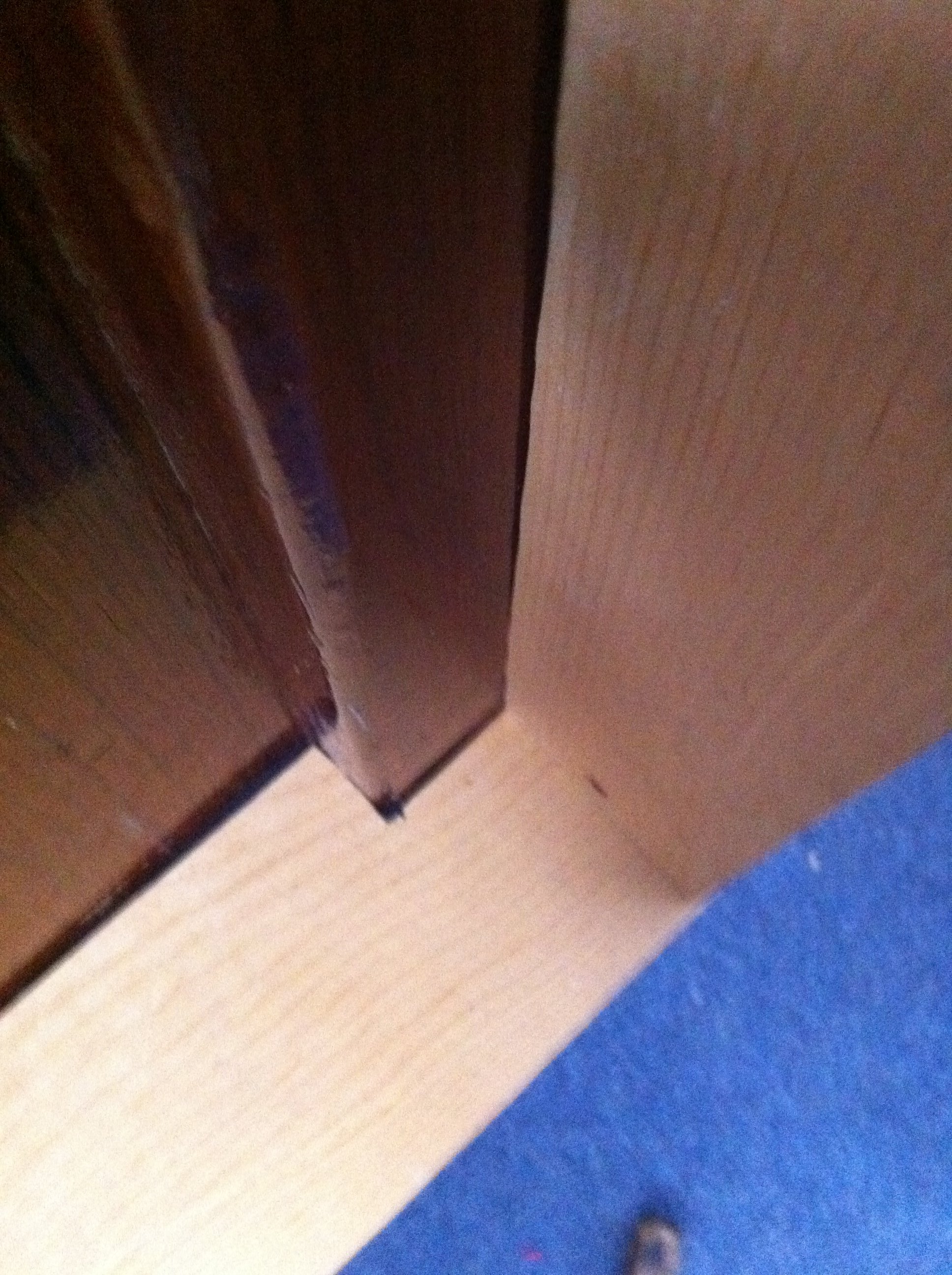

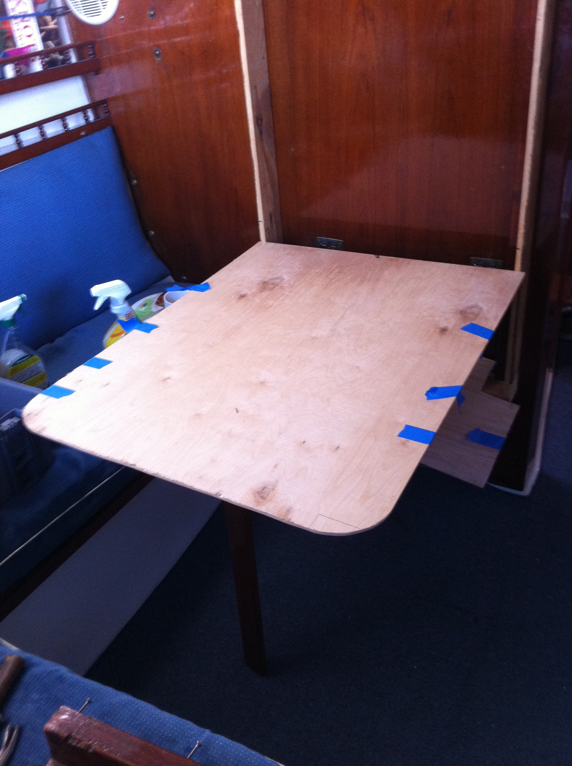

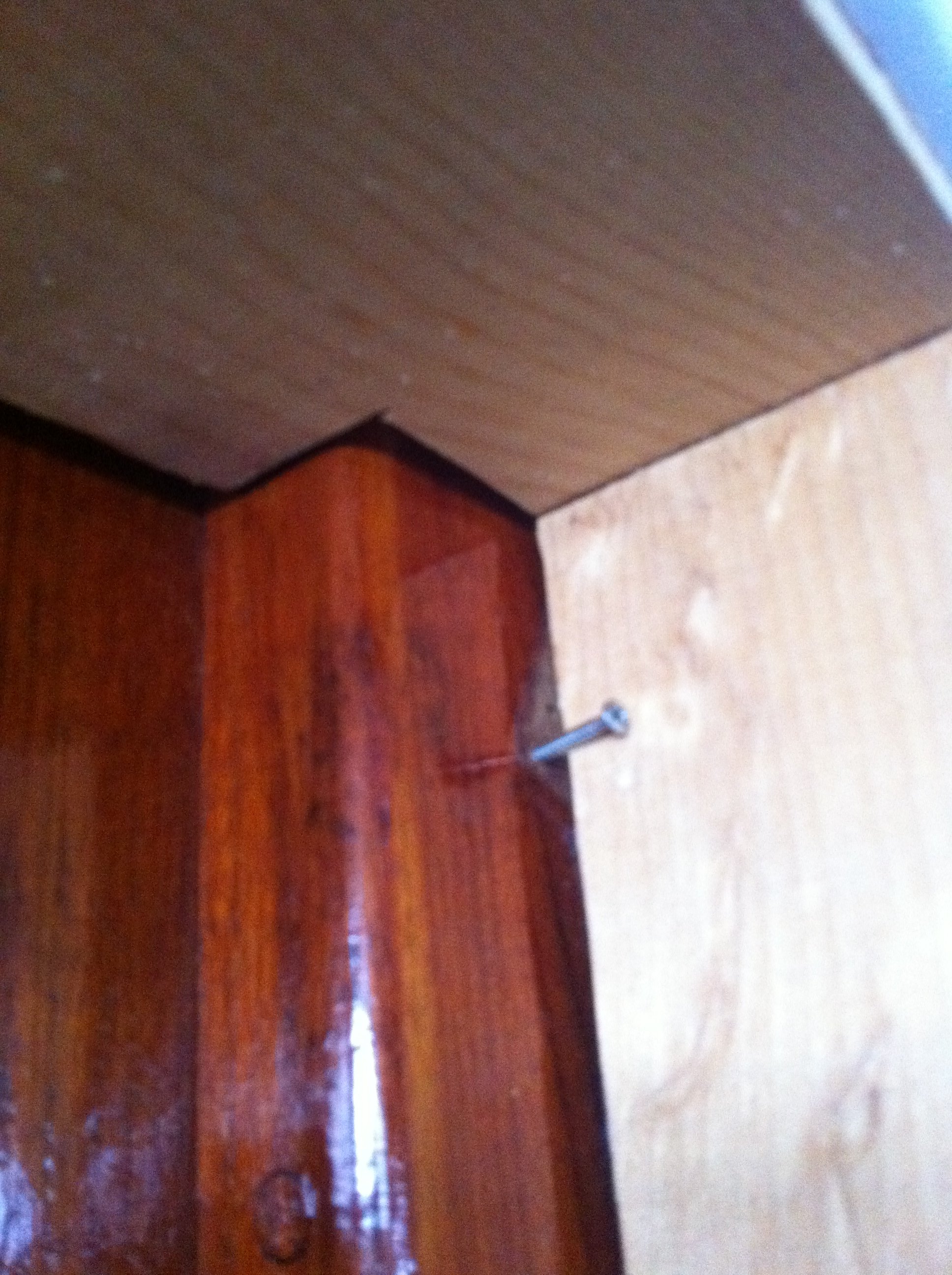

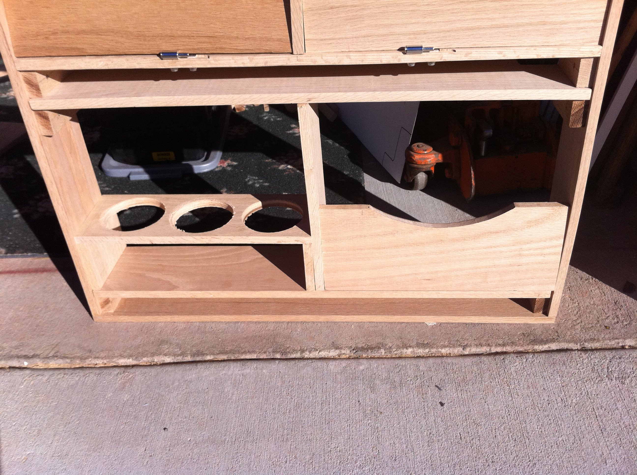

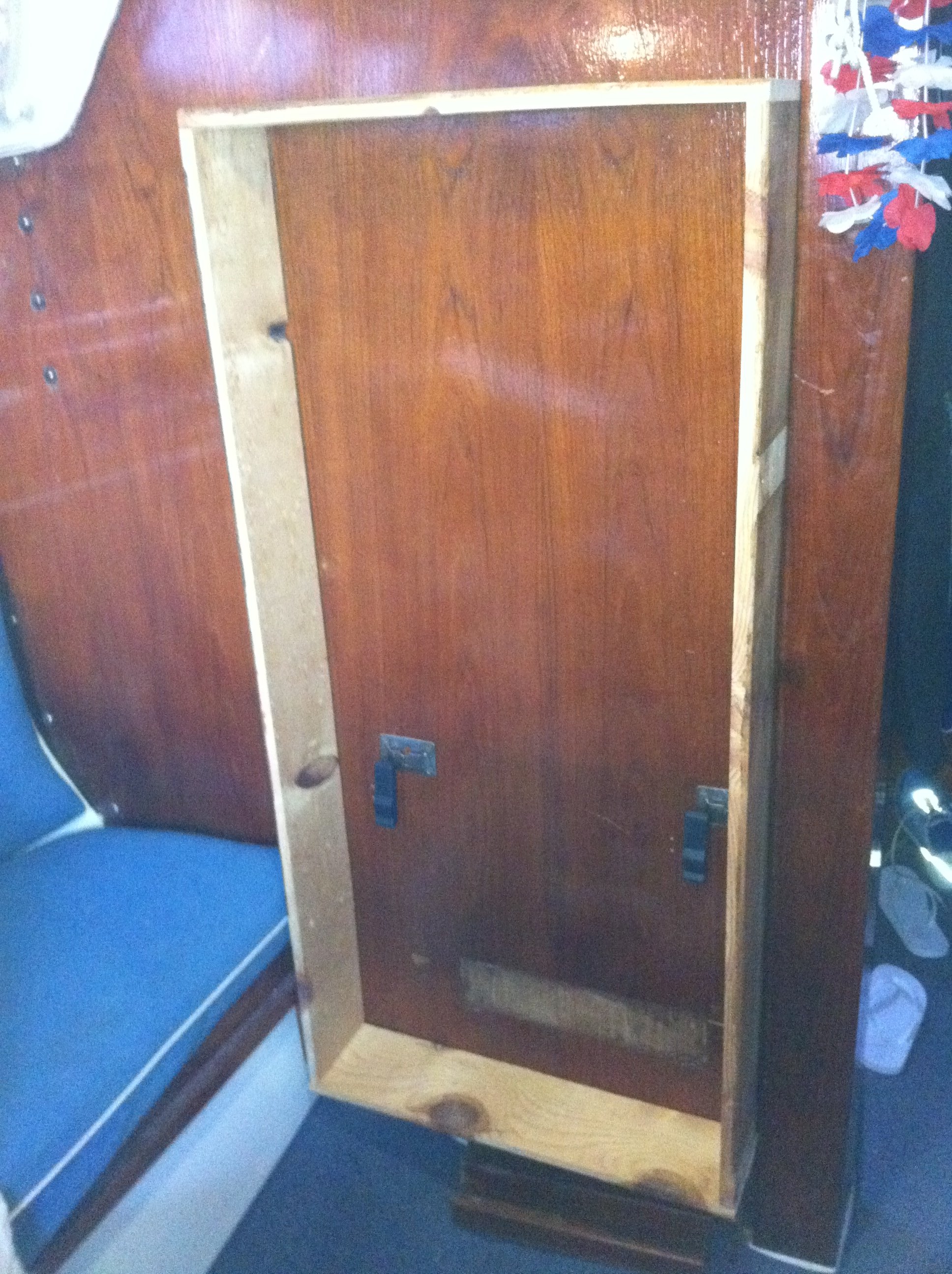

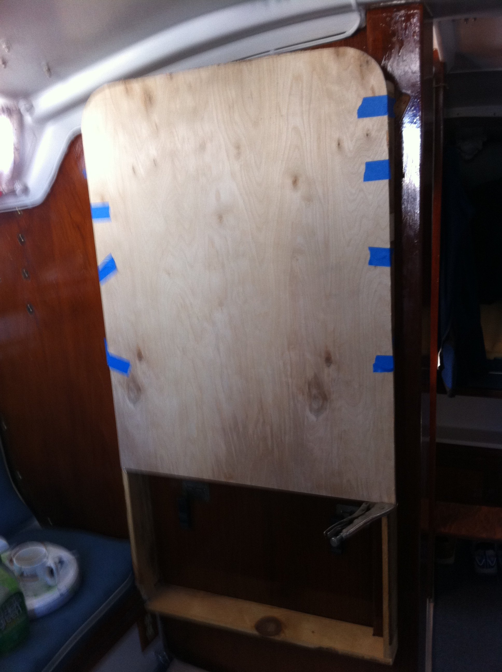

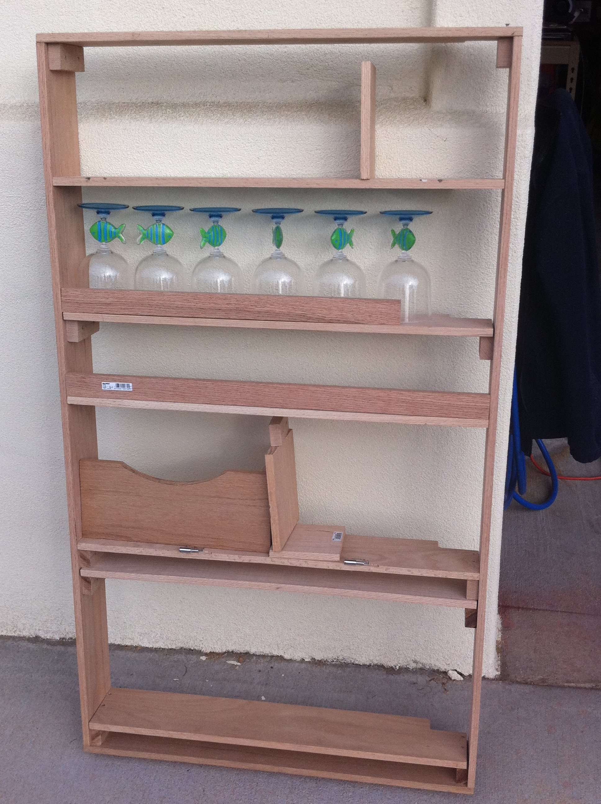

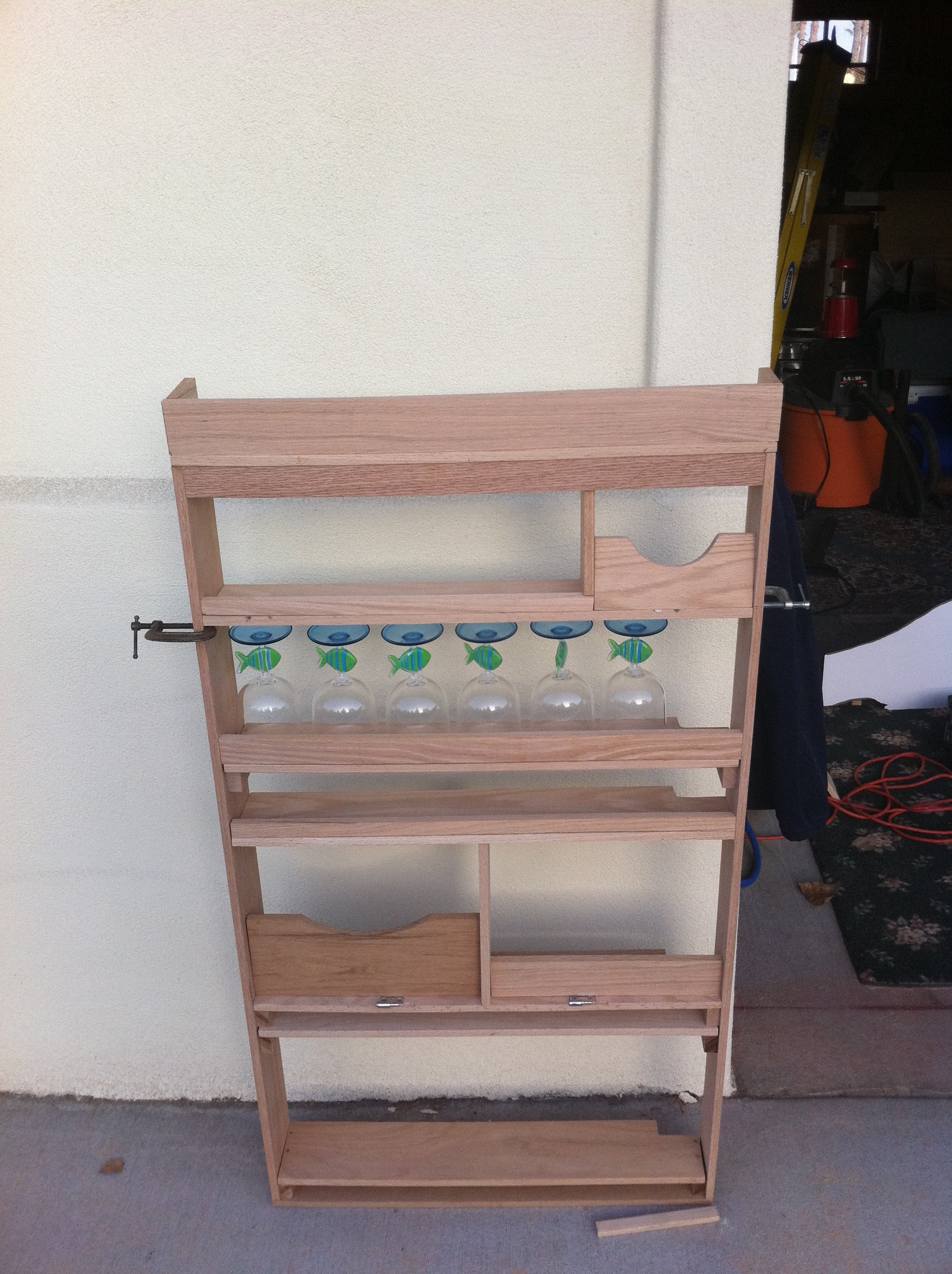

I'm posting some photos of the fold down table mod I produced in case someone needs some details. I used hinges that can be easily separated (pins) on the table top so that it can be removed and used as a berth like it was originally. I went thru several templates using thin plywood and cheap throw away pine lumber that was easy to work with. As with any early boat nothing was square or plumb. I made a few minor mistakes that given more time I would have changed but overall the results have been spectacularly received by the Admiral. I added a 12 volt lighter plug to the outboard edge to allow for a cell phone charger.
