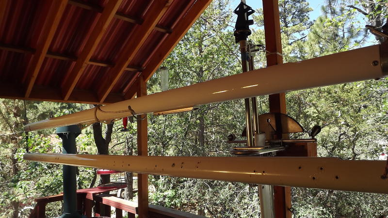

P.S. Finally got around to replacing my old boom. It doesn't whistle like a flute like the old one that was full of 37yrs of old mount holes!

That old boom looks like Swiss cheese. Curiously it has an elliptical cross section. Mine is rectangular.

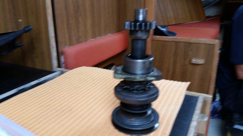

Hi,my Yanmar is YA8(i'm told it is similar with YSM8,built for japanese internal market).
If it does not start because i'm not turning it fast enough,the moment I release the compression lever,it stops,like hitting a solid wall,hence the compression is still very good.When I manage to go over first compression,it starts straightaway.
For who is curious,attached are picks of starting shaft assy,I dismantled to clean the sprocket of hardened oil(it needs oiling regularly).To pull out this shaft undo three bolts which hold the flange.
