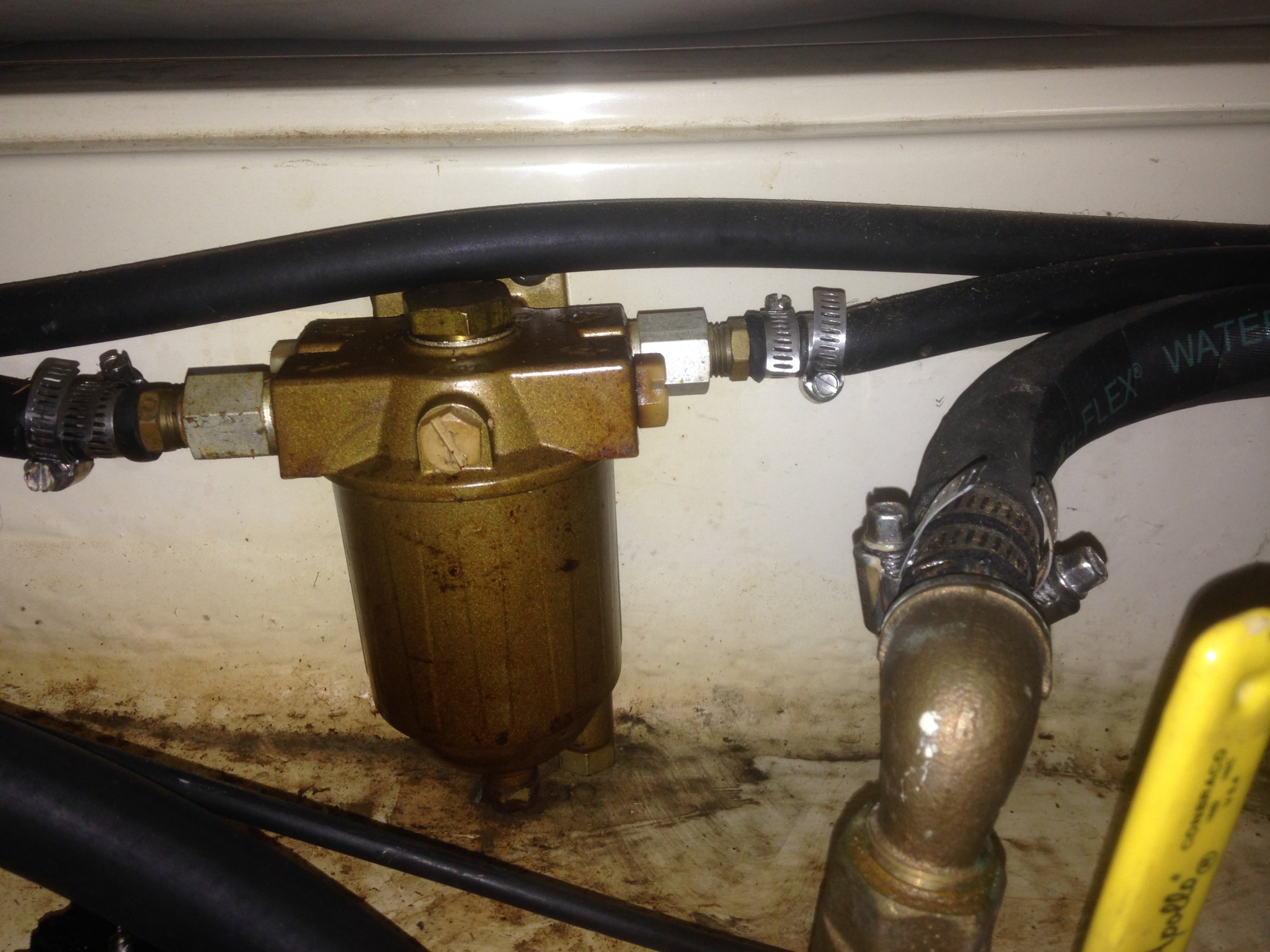

Hi everybody I've had a bad time this summer (in the ol '90 Hunter 27 w/ Yanmar 9hp diesel) with my engine cutting out due to water and sediment in the tank. So I've just siphoned everything out of the tank and am about to back flush the lines in an effort to put all this behind me.
Couple questions...
There are 2 lines that come out of the top of the fuel tank that lead toward the engine. One goes through the fuel filter/ separator (under the rear birth) and the other bypasses it and goes straight to the port side of the engine. It routes to the side of the engine next to the bathroom wall and I can't see where it goes to. What is this second line for and how necessary is it that I get to it to be able to back flush it into the fuel tank?

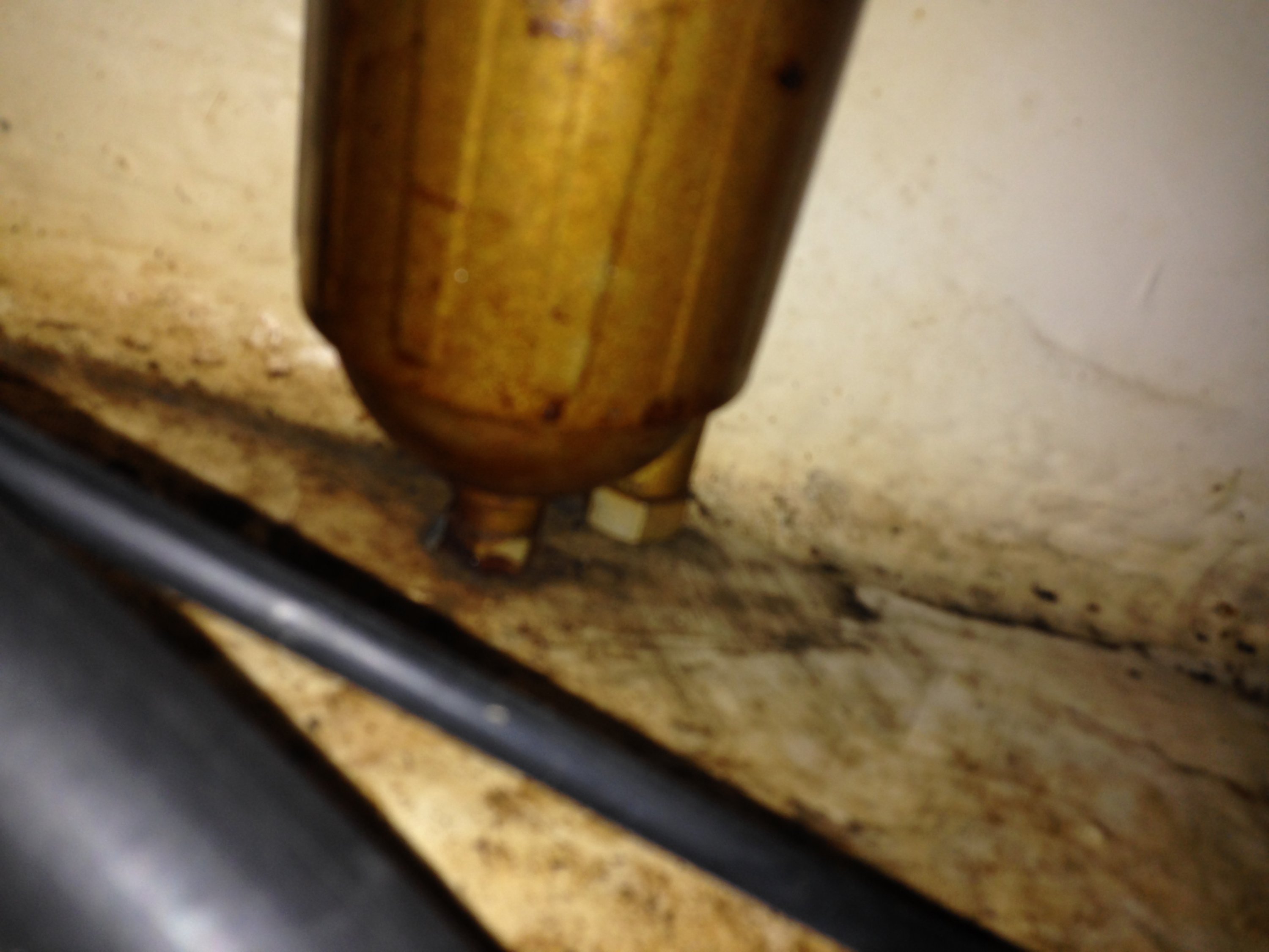

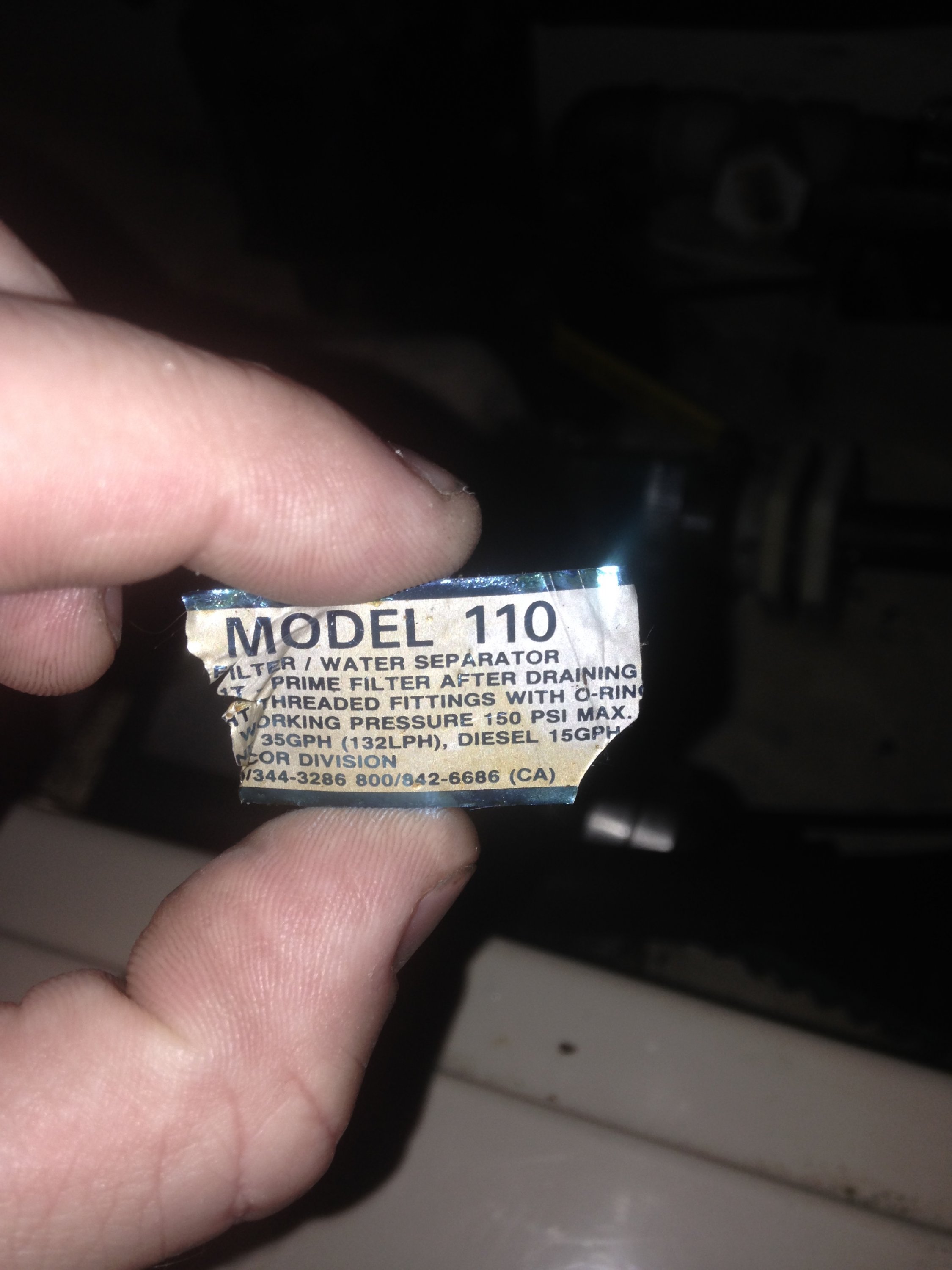

And second...the label on my fuel separator/filter is broken and missing information. Anybody know based on the pictures what sort of filter I need to order? Tag that came off the filter says Model 110.

The fuel line that is connected to the fuel filter is the supply line going to the engine, the second is the fuel return line where excess fuel is returned to the tank.
I would not flush / clean anything other than the fuel tank as the filter will get any crud that's in the line between the tank and the filter and anything past the filter is clean.
Then again, depending on the age of the fuel lines, this may be a good time to replace them, as the hoses are fairly cheap.

I'll second PY26129's suggestion and replace the fuel lines at 27 yrs old. The lines are relatively inexpensive and it can't hurt.
Here's the filter you currently have .................

When you upgrade to a new filter, pay attention to the ready availability of replacement elements. Some of the Racor elements are much more available than others. For instance I chose the Raycor 215R filter and learned later that the R15S, R15P, and R15T are NOT commonly available. The 110 filter with its metal bowl means you can't see water and crud in the bottom of the filter. I changed mine out during my first year of ownership.
