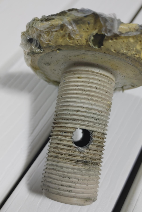

1. All Marelon thru-hulls were in pretty good shape when I removed them.
2. A broken handle on one of the Marelon valves in a process of very careful "exercising" of it and a minor leak as an unpleasant "side-effect".
3. One valve completely broke in half on a very minor force applied while I was removing a hose. (Good for me that this happened while she was on the hard. Otherwise .... <insert your imagination here>...).

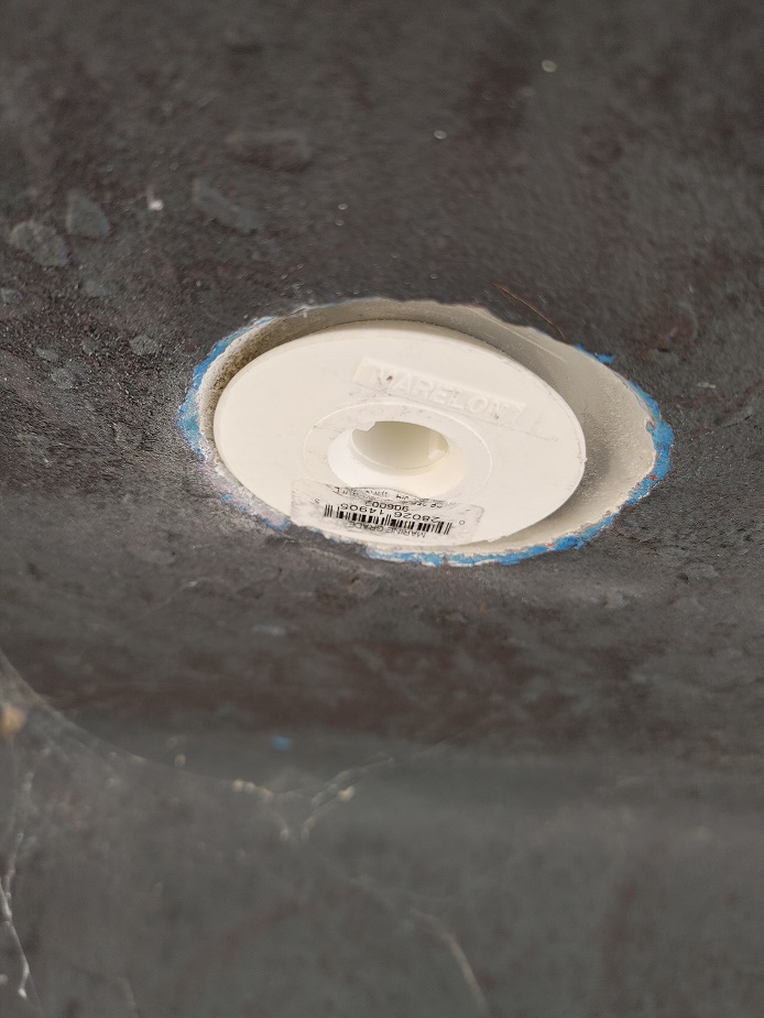

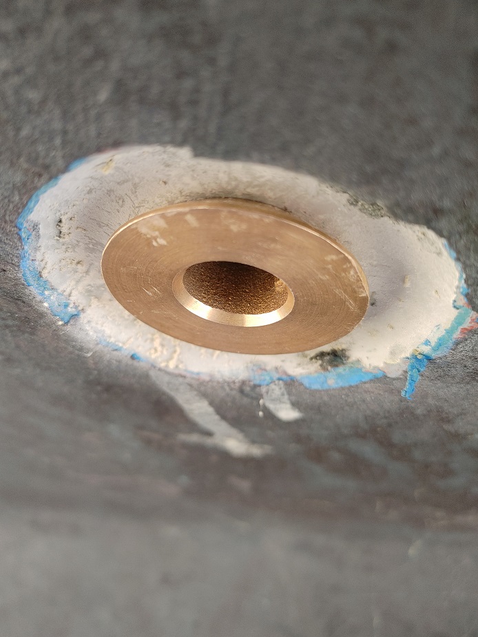

With Croco valves I am having another problem: Catalina has the "flush thru-hulls". Only Forespar has thru-hulls with a flange/head of that size (please see the images). Bronze flush (or mushroom) thru hulls' flanges are smaller.

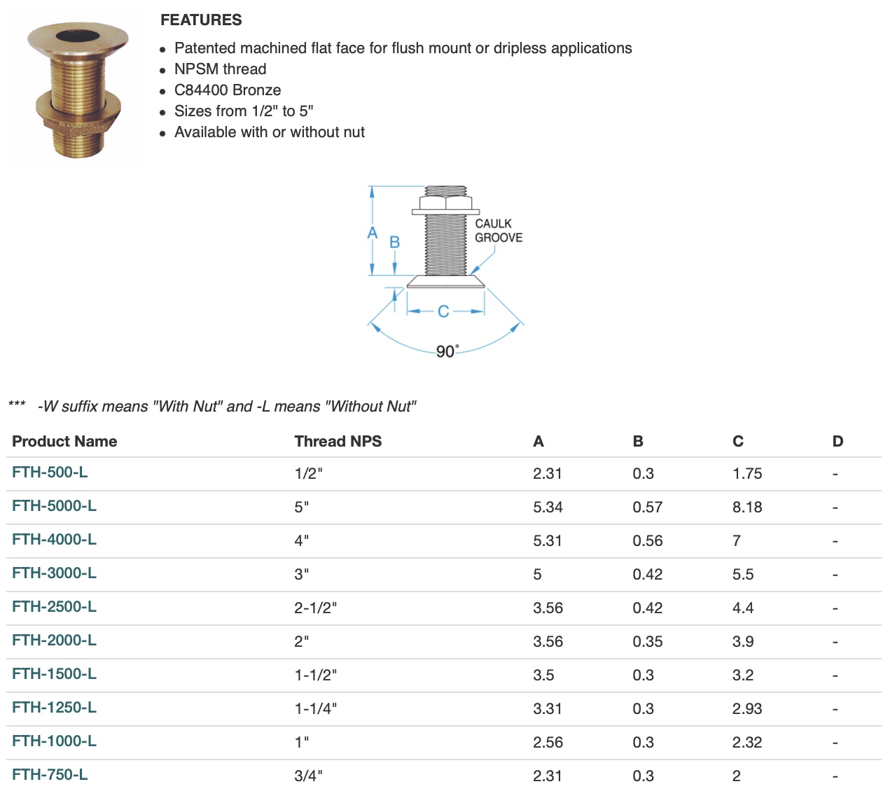

- Forespar is 2.430(61.72mm)
- Groco is 2".
I feel not very comfortable with a smaller one but was unable to find a bronze flush or mushroom 3/4" thru-hull with the similar flange size as Forespar.

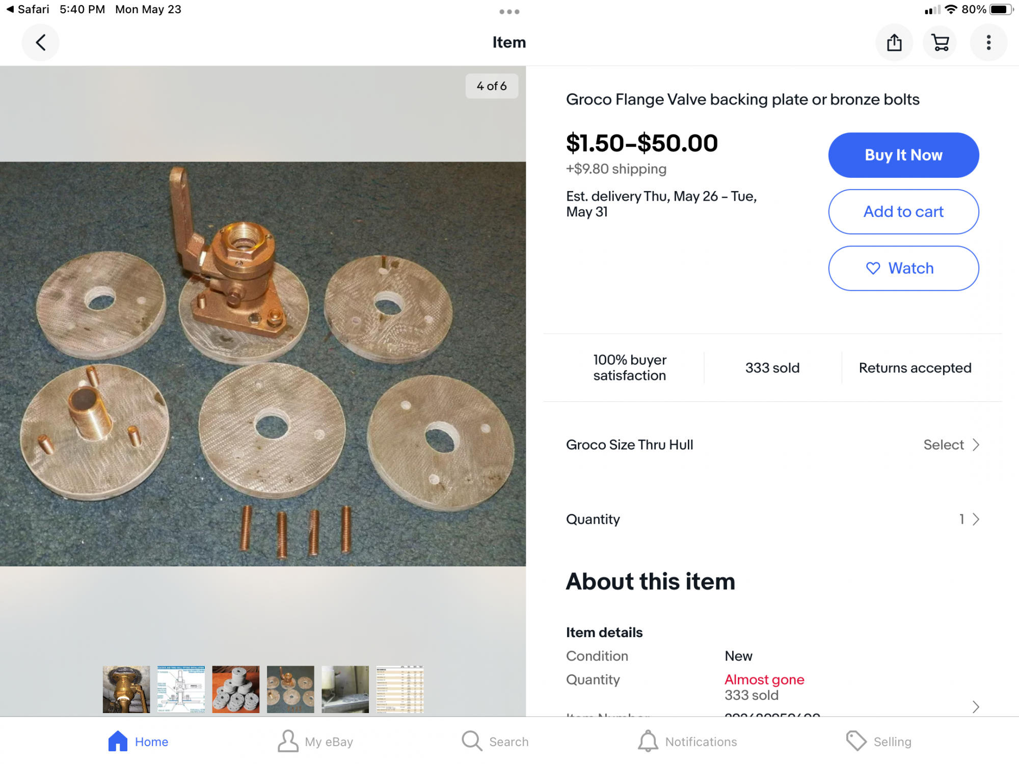

P.S. Some other related thoughts. I ordered one backing plate from Groco and I didn't like it at all. This is an overpriced cut made of PVC panel that look similar to what I see in Home Depot. I honestly not sure how it will bond to an adhesive but have some doubts about any "epoxy-based" one.
Got these instead Groco Flange Valve backing plate or bronze bolts | eBay instead.
- Groco is 2".
