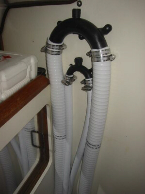

But that's not all you need to do. Whoever installed the toilet failed to install a vented loop in the toilet intake line...see "FIGURE 2 Below Waterline Installation" at the bottom of page 3 in the owners manual for the correct location...which is NOT in the line between the thru-hull and the pump, but between the pump and the bowl. It has to be at least 6-8" above waterline AT ANY ANGLE OF HEEL, not just when the boat is at rest, which on most sailboats puts it 2-3 FEET above the bowl see the drawing and also the photo below (you only need the small one that's tucked under the one that would go in the discharge line if your toilet were plumbed to flush directly overboard.) That means you'll replace the short piece of hose that connects the pump to the bowl now.

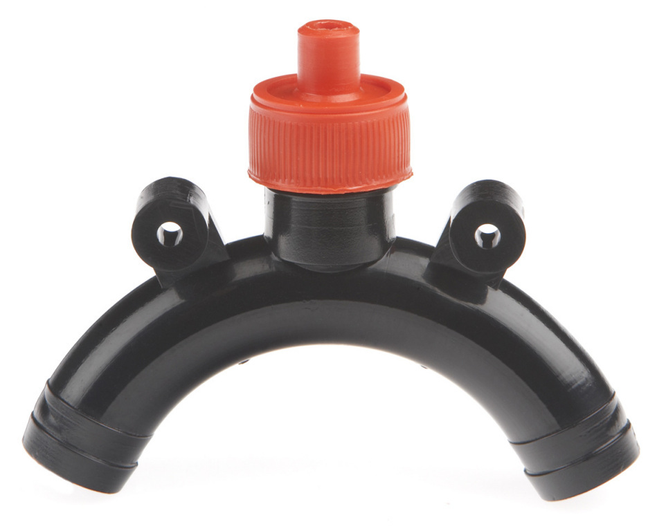

Gunni, people are fallible...they can forget to leave the toilet in the dry mode or forget to close a seacock...vented loops are fail-safe. They PREVENT flooding, eliminating any need for an "instant fix" when someone notices the bowl has overflowed And they don't stink--or squirt--unless the air valve (it threads into the nipple on the top of the loop...see photo, they aren't all red, btw) is missing. Because air valves are parts that need occasional cleaning and do wear out, they're sold separately, so most boat owners--you apparently included--don't know they exist.
