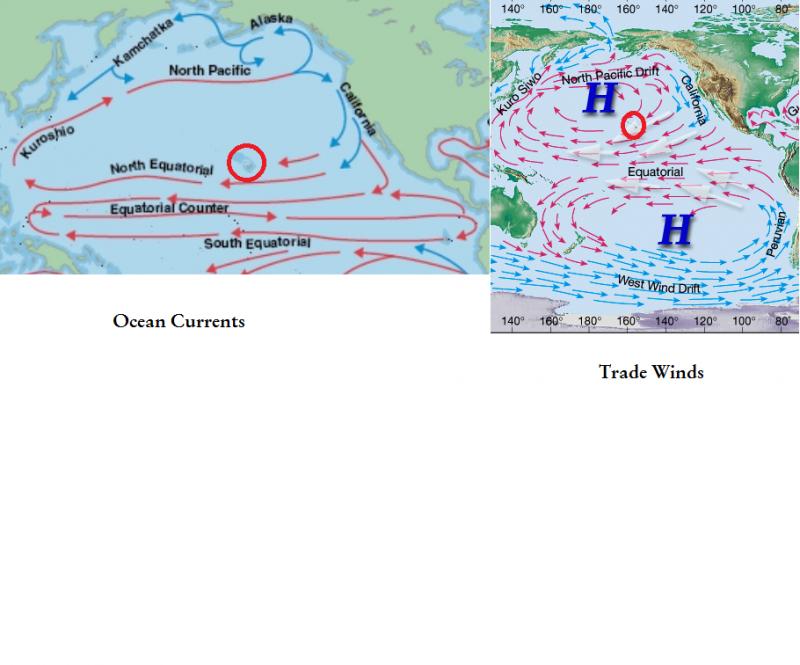

I got curious about what Sum said regarding going to HI first.... so I did a bit of digging.
The trip up the coast is 4037 nm in a best case (direct path) scenario (see screen shot from Active Captain) but you would have to buck the currents and the trade winds the entire way (see pic of ocean currents and trade winds). So I'm guessing you would actually sail a bit more than the prescribed 4037 nm. On the other hand... you might get some relief from the trades if you stayed close enough to shore to take advantage of shore breezes.
If you go to HI first, then Oregon, the total distance is 6643 nm (best case scenario).
On the leg from panama to HI (4538 nm), you would have the trades mostly on a reach to close reach and the current would be pushing (aiding) you west. You should make good time on that leg. From HI to Oregon (2105 nm) you would be close hauled and/or have to beat 2105 nm. however there is very little ocean currents in that leg until you get close the the mainland coast.
I guess there would be a lot of other variables to consider ... but it is an interesting idea. It seems quite plausible that you would make very poor progress bucking the currents and trades all the way up the coast... and perhaps you would make comparable time by going to HI first even if this adds 2000+ nm. And it might be a much easier ride... and then there is the bonus of going to HI:dance:
