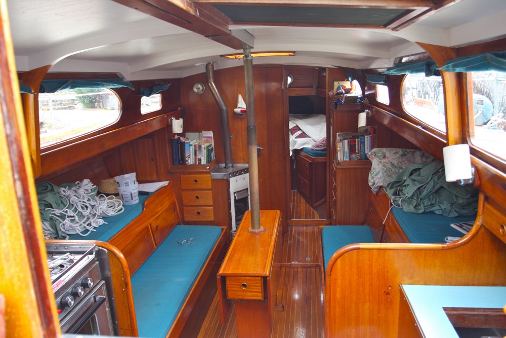

A good question. My boats original sole (8-10 section pieces), was built in strips of glued up teak and holly. The strips looked to be slightly over 1/2" thick (you have to engineer thickness to spans beneath). It was left raw (for grip) in 1961.
When I bought the boat, the sole was about 35 years old and nearly black from dirt, but still sound.
I broke the rules and sanded it reasonably clean. I decided the wood needed some protection, so I coated it with standard gloss spar varnish(no grit). We find there is plenty of grip as the gloss was quickly foot worn, to a satin. It has 'tooth'.
After 15 heavily used seasons, with a family of four (and two dogs) onboard, the varnish - nearly flat gloss - is still protecting the wood.

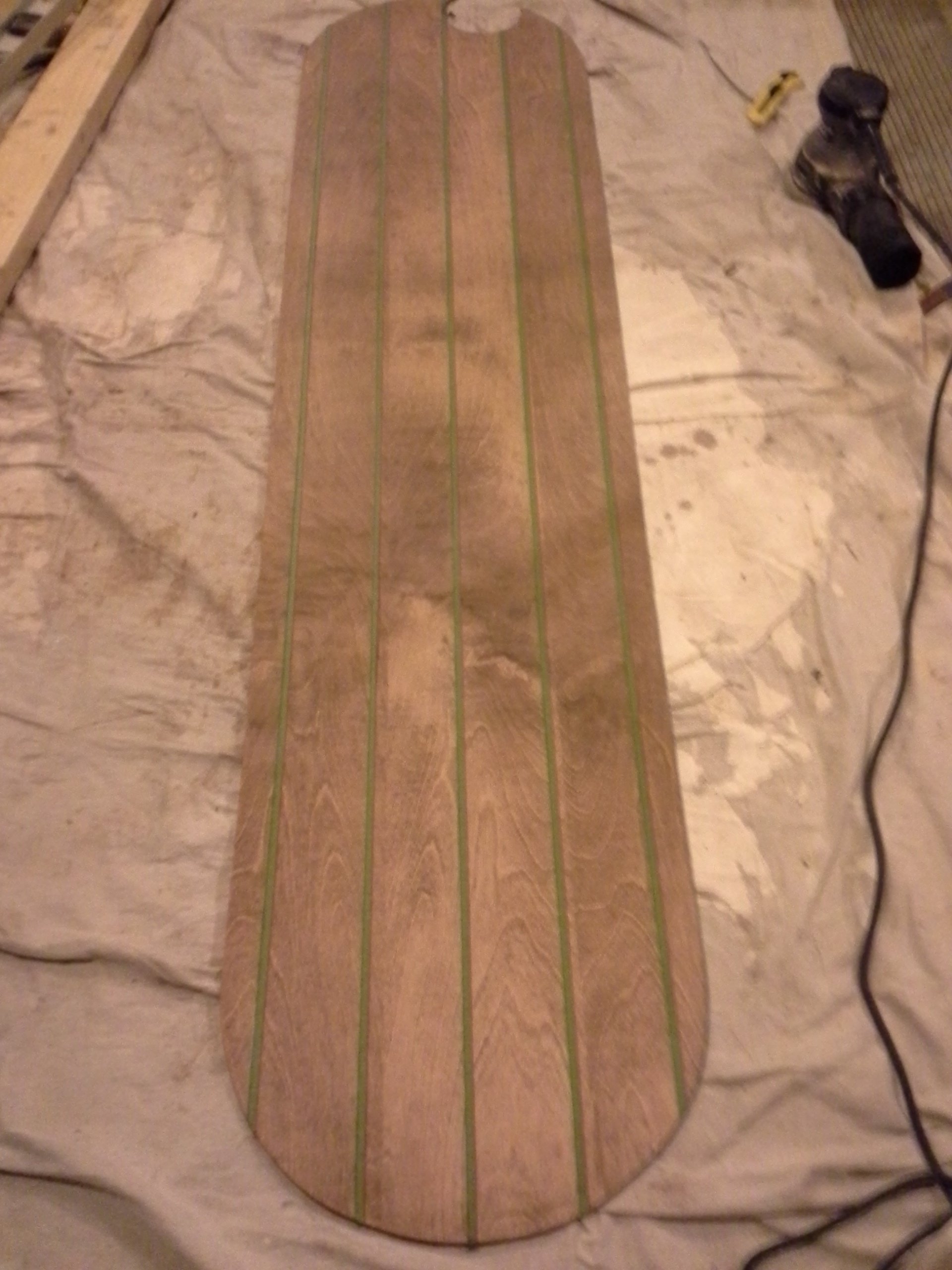

I replaced the teak and holly ply on the floor of our boat a couple of years ago. Marine teak and holly is few and far between where I live, and shipping a sheet is ridiculously expensive, so I made some "faux" teak and holly using some birch plywood and some creative staining.
Here's the piece before I peeled off the tape (you have to score the tape edges when taping to keep the stain from creeping)

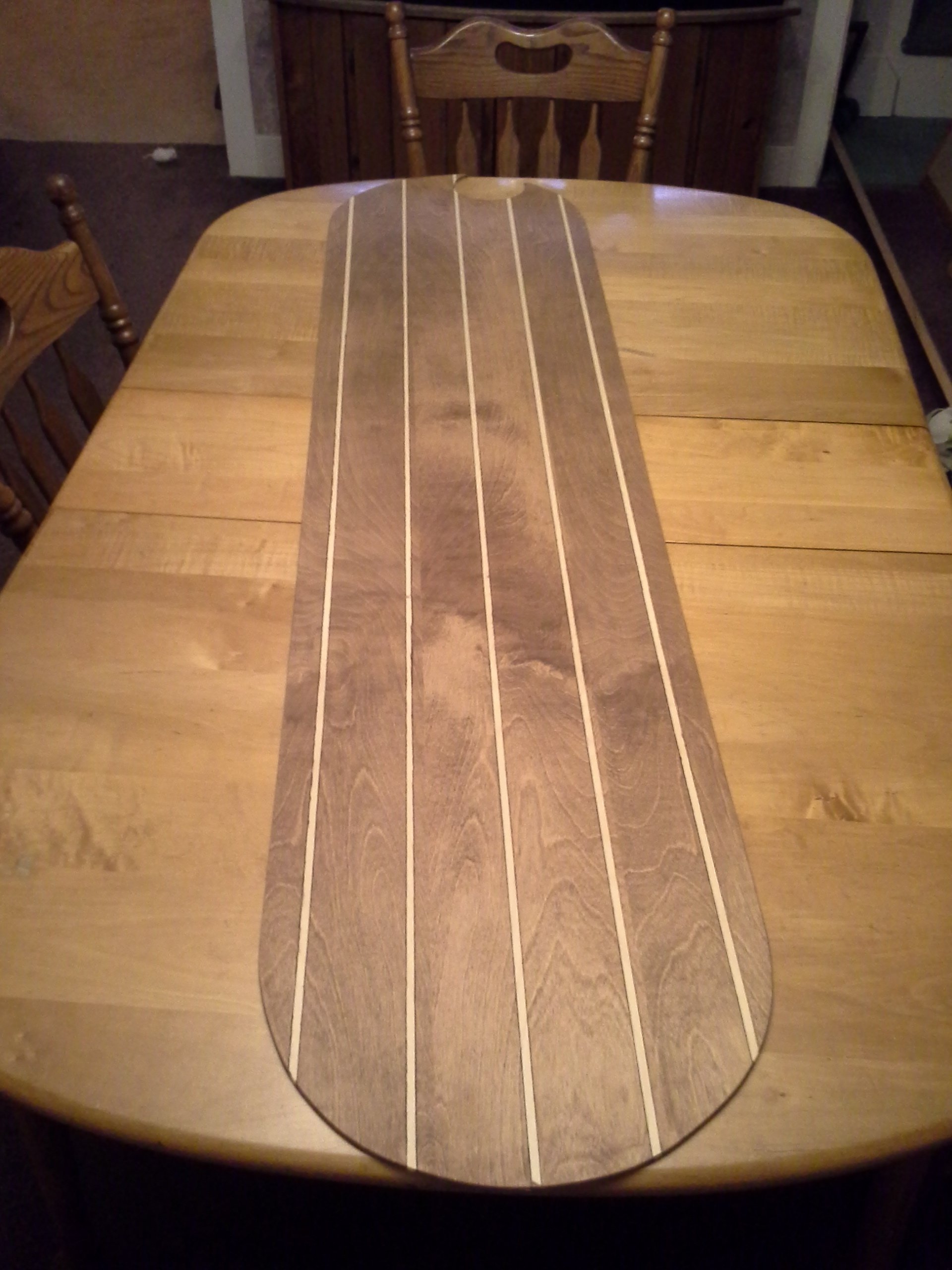

After peeling the tape:

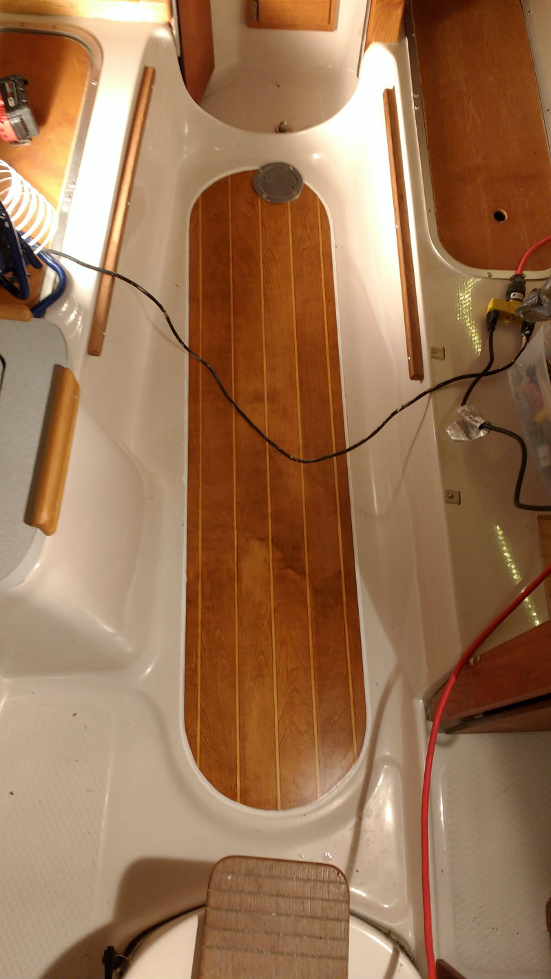

Finished floor. Sealed it with a couple of coats of epoxy, and several coats of polyurethane:
We've had it in a couple of years now with no issues.
