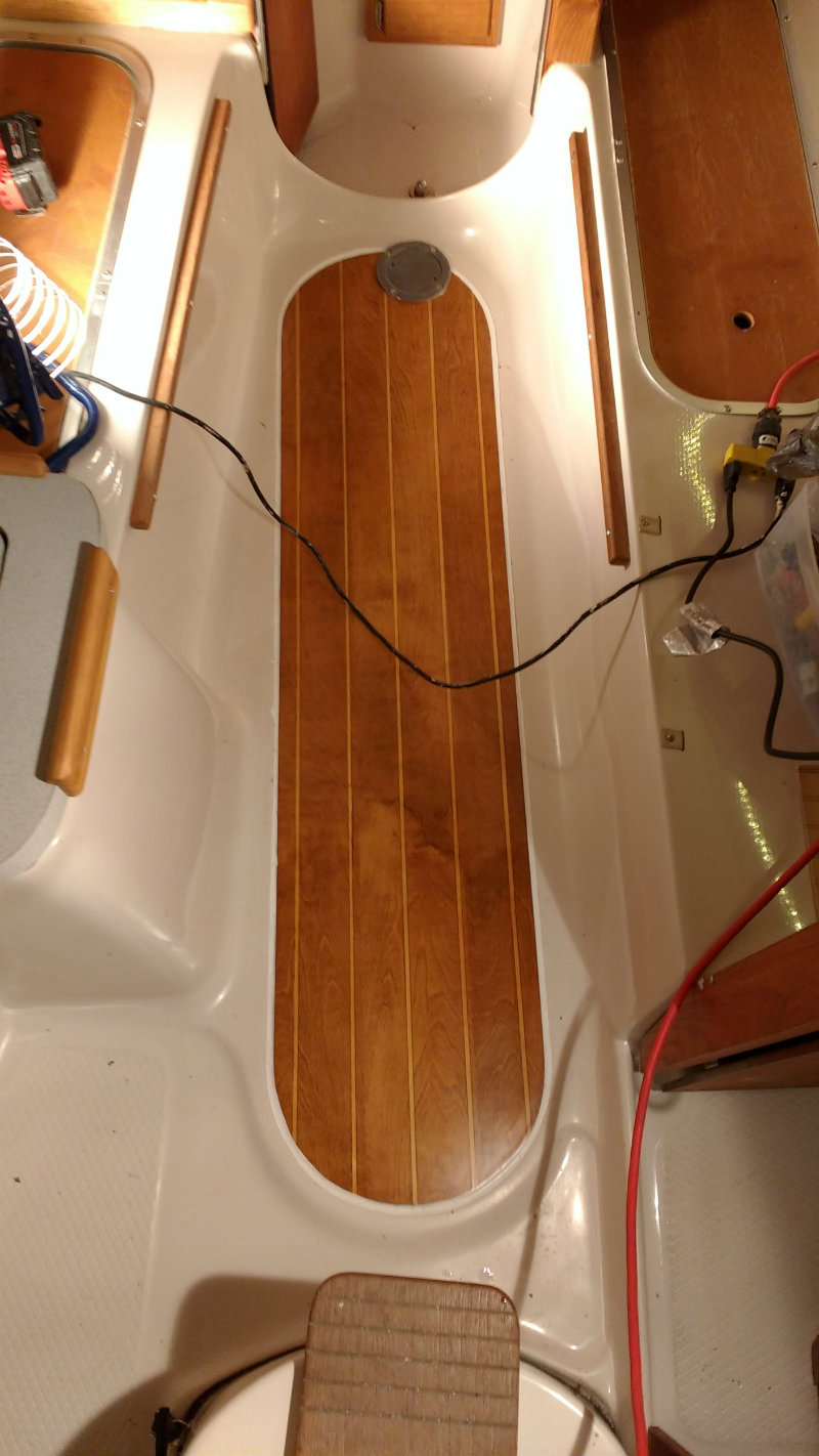

I replaced the teak and holly ply on the floor of our boat a couple of years ago. Marine teak and holly is few and far between where I live, and shipping a sheet is ridiculously expensive, so I made some "faux" teak and holly using some birch plywood and some creative staining.

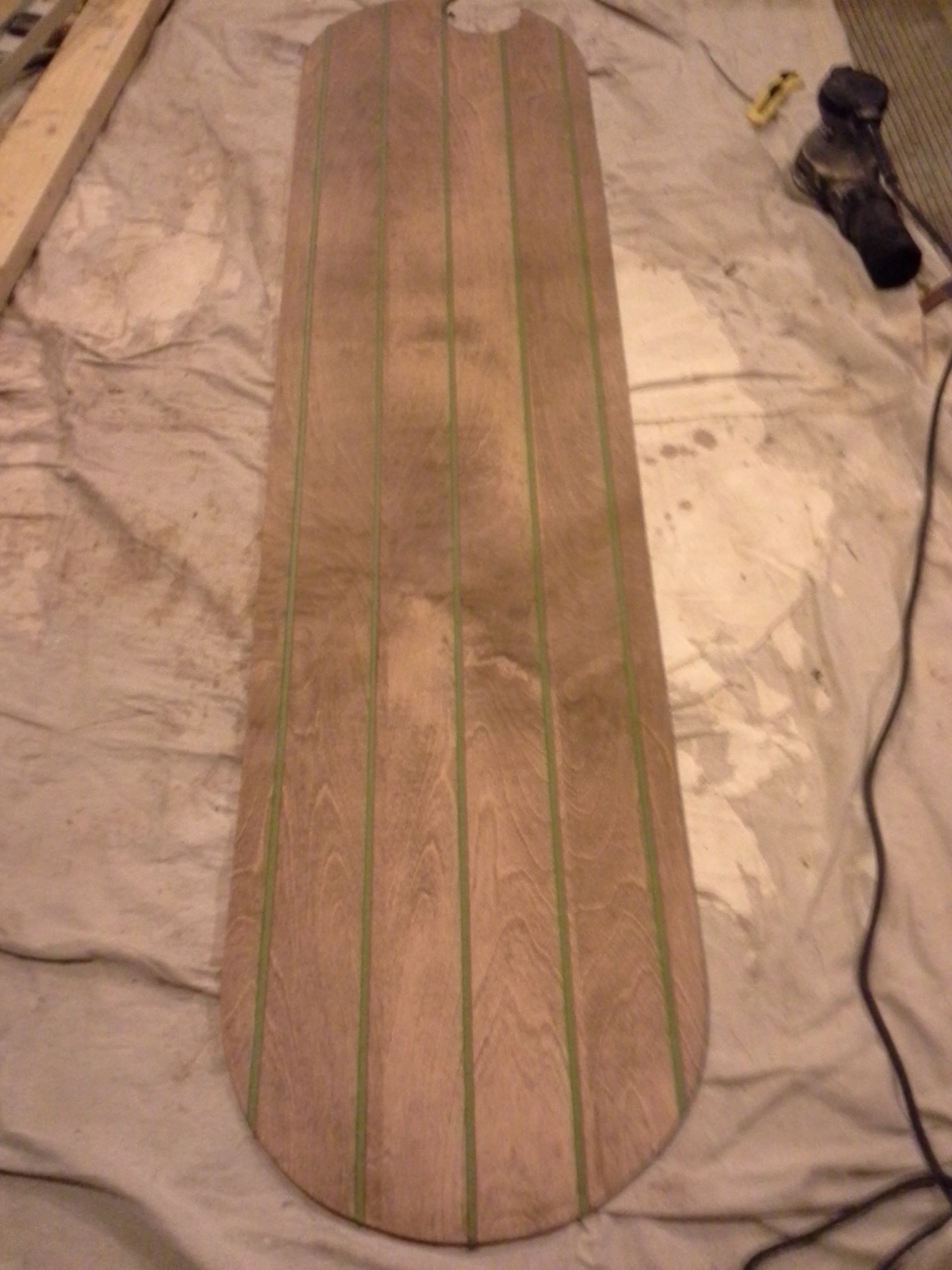

Here's the piece before I peeled off the tape (you have to score the tape edges when taping to keep the stain from creeping)

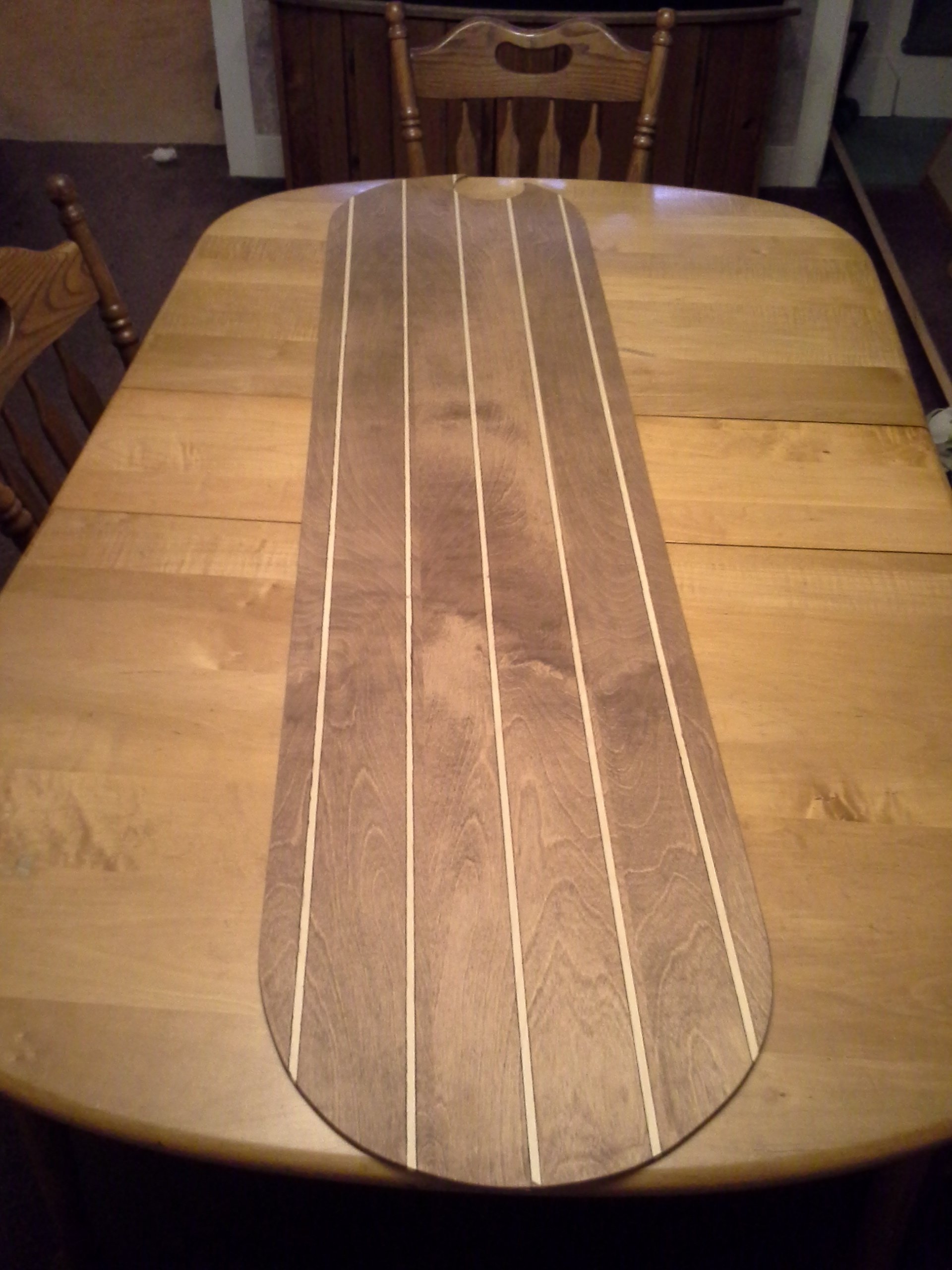

After peeling the tape:
Finished floor. Sealed it with a couple of coats of epoxy, and several coats of polyurethane:
We've had it in a couple of years now with no issues.
