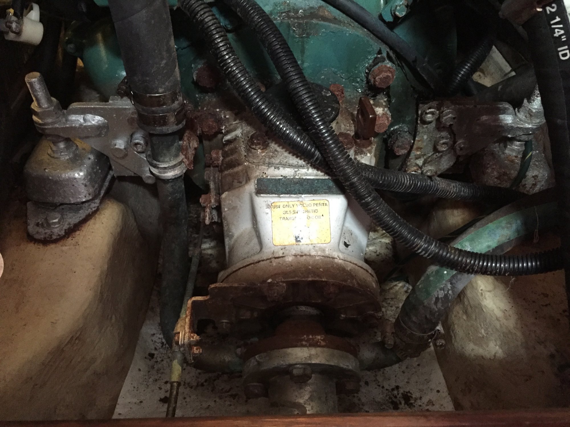

Trying to piece together some clues based on what we (me and surveyor) have seen on this 20 year-old boat:
1. Bilge isn't super clean. Steel plates under the keel bolt nuts have minor corrosion. It didn't look alarming to either me or surveror. (didn't take picture)
2. Bilge pump runs, but float switch didn't operate (after all the defense I have offered for Rule - it's a Rule :(). Even found a new one in a package in one of the lockers.
3. Galley floor has been painted. Scum line observed about 2 inches up the bulkhead next to engine compartment.

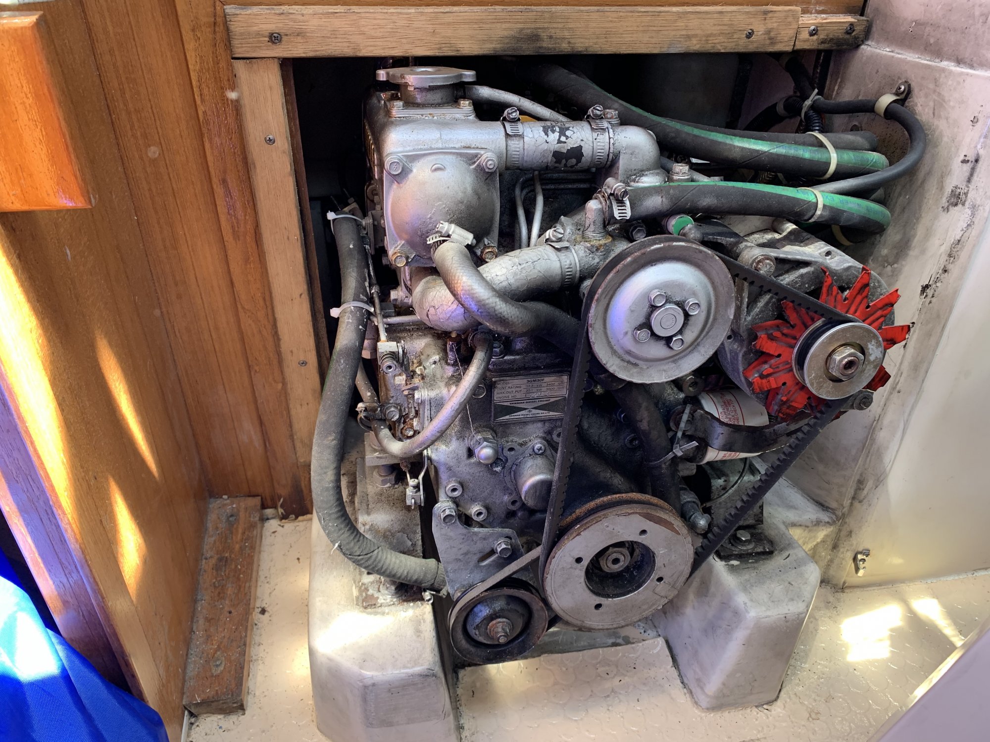

4. I noticed an odd amount of rust on the engine pulley - just now realizing it can correspond to the scum line on the wall right next to it (when the pulley is turned to the right orientation).
5. Owner describes replacing the PSS bellows in 2017.

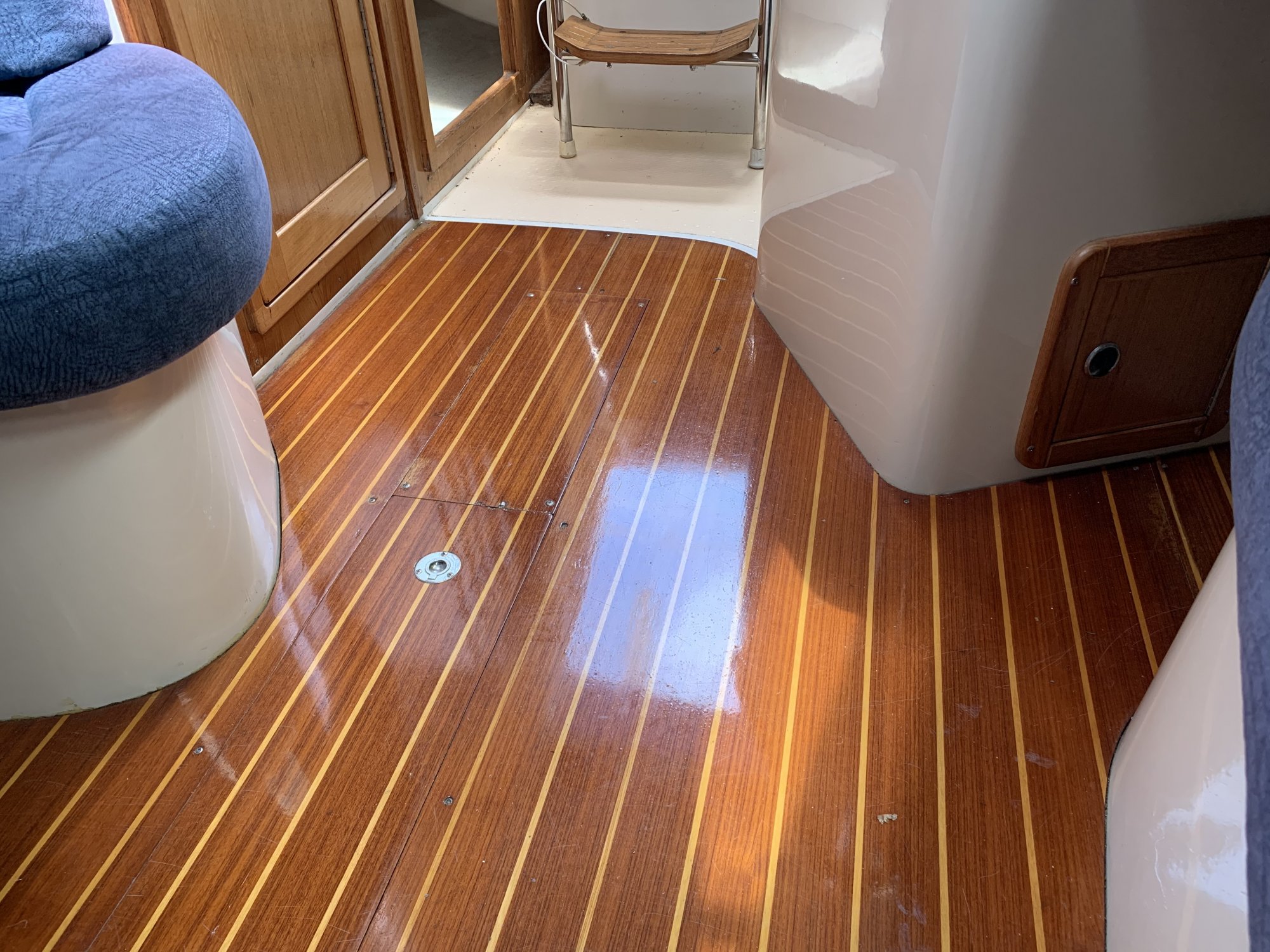

I'm wondering if there was an event that led to water over the floor boards. The flooring looks pretty good for 20-years in my opinion. I don't see any sign of floor damage. Just wondering if such an event should cause me significant concern, or if it nothing to worry about.
Flooring looks fine to me. Access to bilge is under that floor ring.
It just dawned on me that the rust on the bottom pulley would be very near floor level, if it was turned that way while the floor was flooded. You can't see it in the photo, but there is a very faint scum line on the fiberglass just to the port side of the engine (in the galley). Also, the floor has been painted.

do any of the through hulls or piping looking new? i'm certainly no expert, but if the boat flooded up to the level of the crank pully, it doesn't seem likely it was rain water. and even if it was, the plywood walls would show punkiness at the bottoms. it seems resonable to hypthosize that a thru-hull let loose and it was caught early on, which would led me to believe the scum line around the hull and (if) the plywood being okay
capta
Jun 4, 2009
4,952
If the water got to the bottom of the bulkheads then you will probably have some wicking up the plywood and that could lead to some structural weakening and problems with the veneer. In the bottom pic the wood next to the engine stringer is dark, indicating what I said above and the batten from the floor to the wall is probably not OEM, but a result of water in that wall/floor joint weakening the connection.
The floors are most likely veneer on plywood and damage could be underneath. Perhaps that's why the floors were painted?
Also, if the water, especially saltwater, got to the underside of the engine, there is a good possibility that it is rusting badly. Eventually that could require a new oil pan and/or engine removal for repairs.
I doubt any of this would make the boat unacceptable for a day sailer or near-coastal cruiser, but I probably wouldn't want to put her through a norther in the Gulfstream. Any damage also might become more evident as time passes, lowering her resale value, but those are choices only you can make. I'd certainly try to get the price down a bunch if it was worth the haggle to you.

When I look very closely at magnified photos of the teak & holly flooring, I see some areas at the edges that look slightly stained or the varnish is slightly damaged, as if moisture caused it. But there is not nearly enough evidence to make it really obvious. That leads me to my question about whether or not a one time flood for short duration should cause any concern. I don't have any concern about the integrity of the floors and bulkheads. There isn't evidence of any permanent damage to wood. Wood is never really affected by short periods of water or moisture (only the finish might be affected). It takes much longer exposure to water for any kind of permanent damage to occur to the wood, and by then it would be very obvious. My only concern is about the extent to which the engine could be affected. I'm concerned that rust, once started, is more affected by moisture in the air that continues to cause corrosion long after the initial wetting, especially if it was never completely cleaned from the exposure to salt.
2,960
Catalina 320 Dana Point
The plywood floor panels are 3/8", except for the sections over the bilge which are 3/4". The floor actually looks amazing, "like new", on every Cat I've owned the holly strips turn dark from exposure to light over time and the teak lightens a little so colors are reversed.

Dec 28, 2015
1,915
The pulley would not have that perfect line where the paint ends and rust begins from submersion. The paint would be heaved at the line from rust underneath it. It looks like the paint was removed for some reason then surface rust come on. Coincide that with the cabinets and doors show no sign of long term submersion (bowing, failed joints) I'm thinking the idea of submersion isn't a solid one. Plausible but not likely. The floor looks replaced. Floors get replaced on sailboats.
