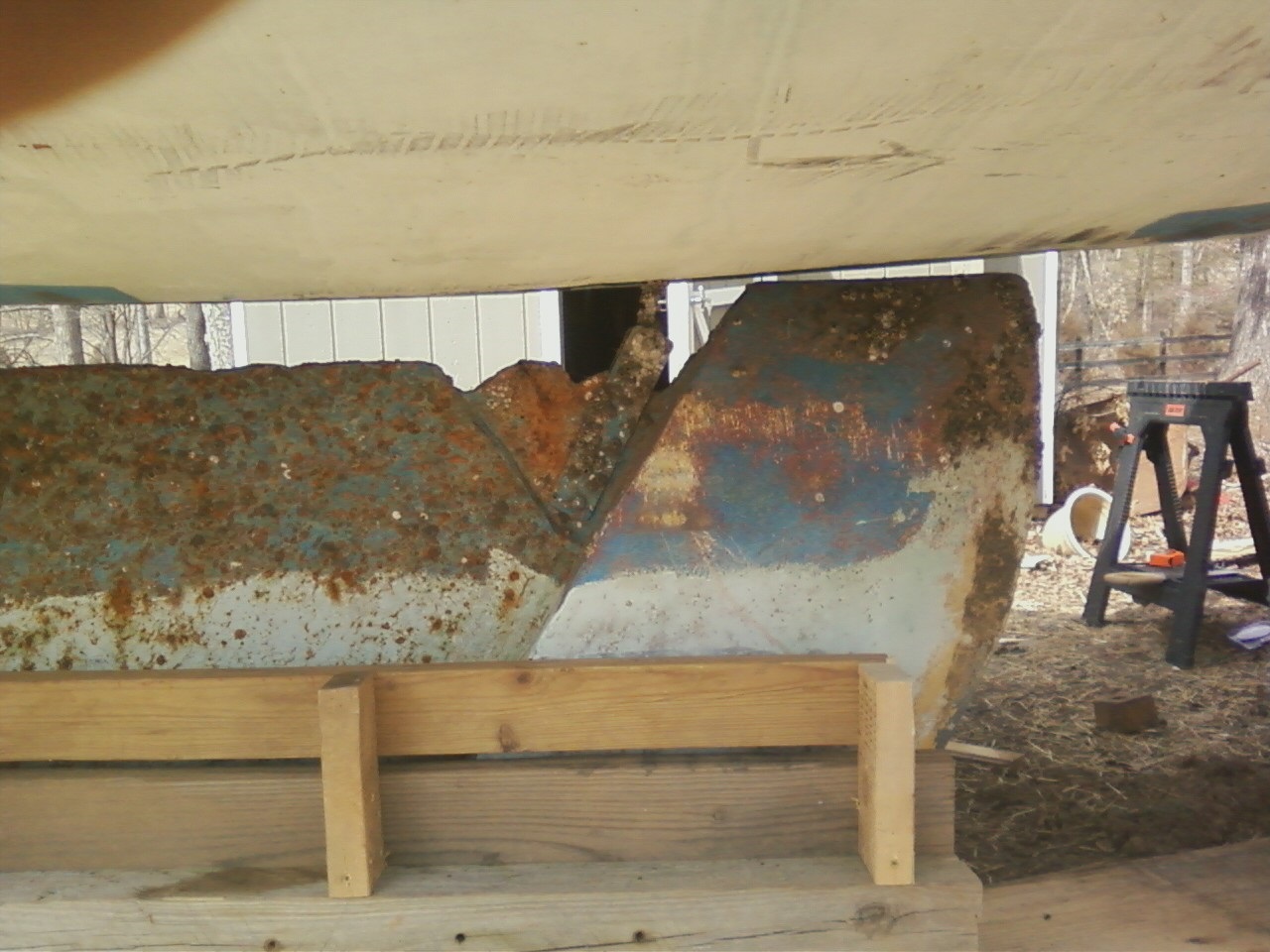

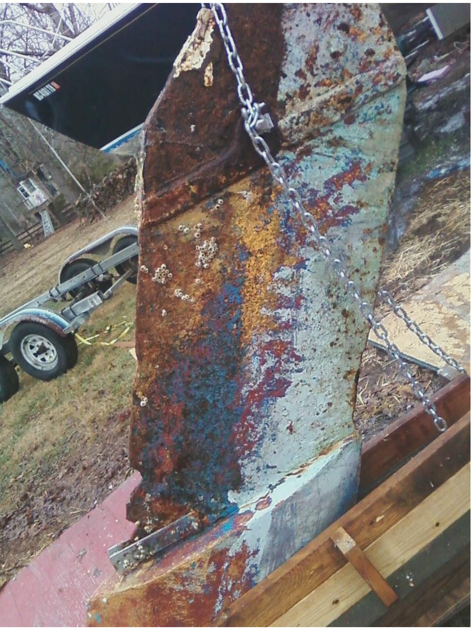

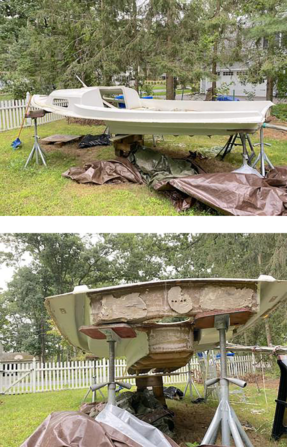

I am guilty of this seven times over (I've done this seven times already) and here are a few photos from various boats I've rebuilt to prove it... none of these were sound "investments"...:yikes:
The first is a Coronado 23 I purchase with busted stringer and many cracks in the hull...
The next three are of a keel I repaired on a Balboa 26

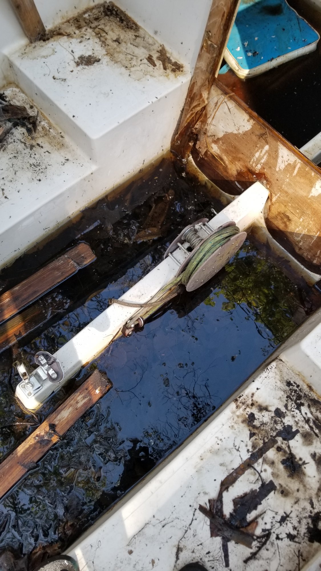

She was moored for some time on LI Sound so it is very possible I did not notice navigation lights on deck. I did note a few lamps and some hanging wire and it's quite possible this was a PO addition - one is barely distinguishable laying on its side, top-center in the second picture, below.

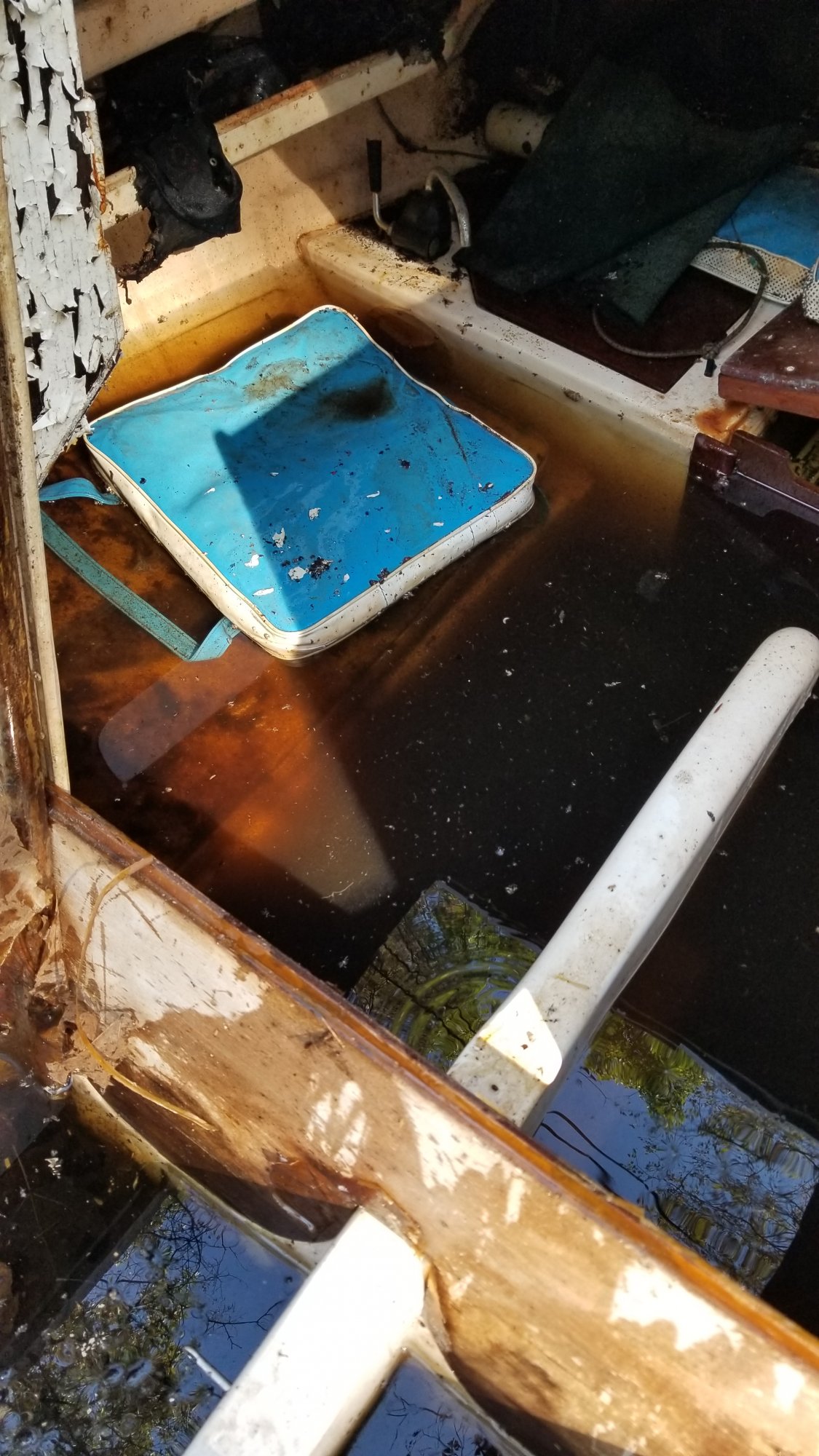

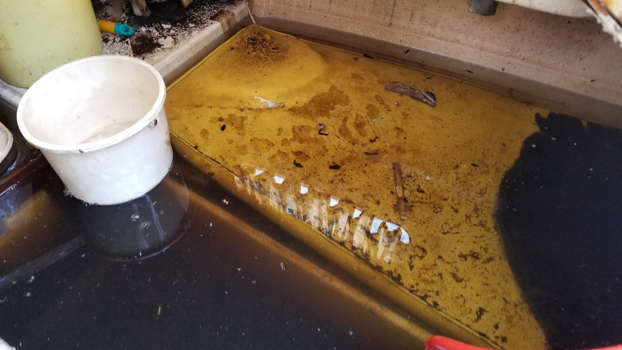

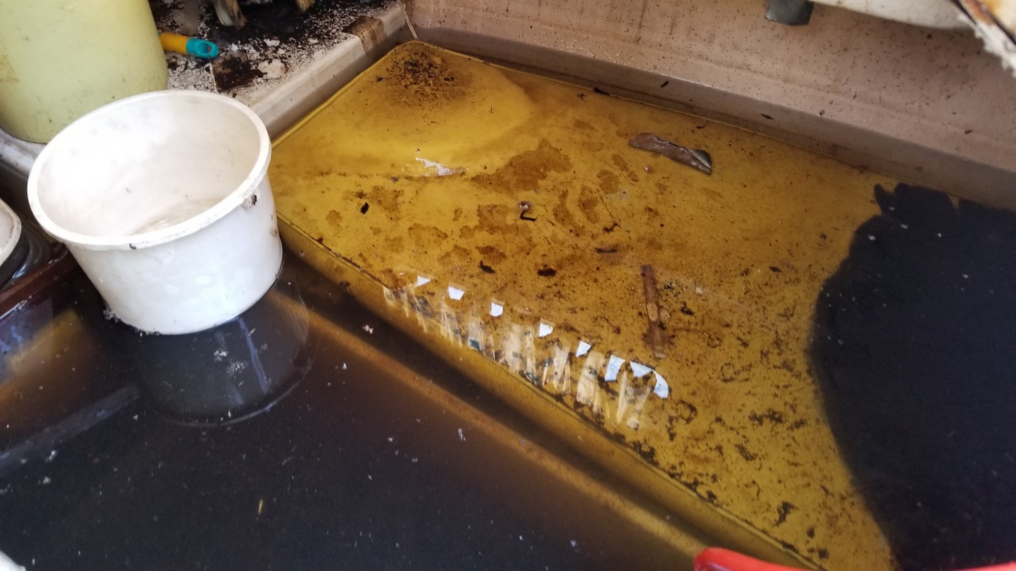

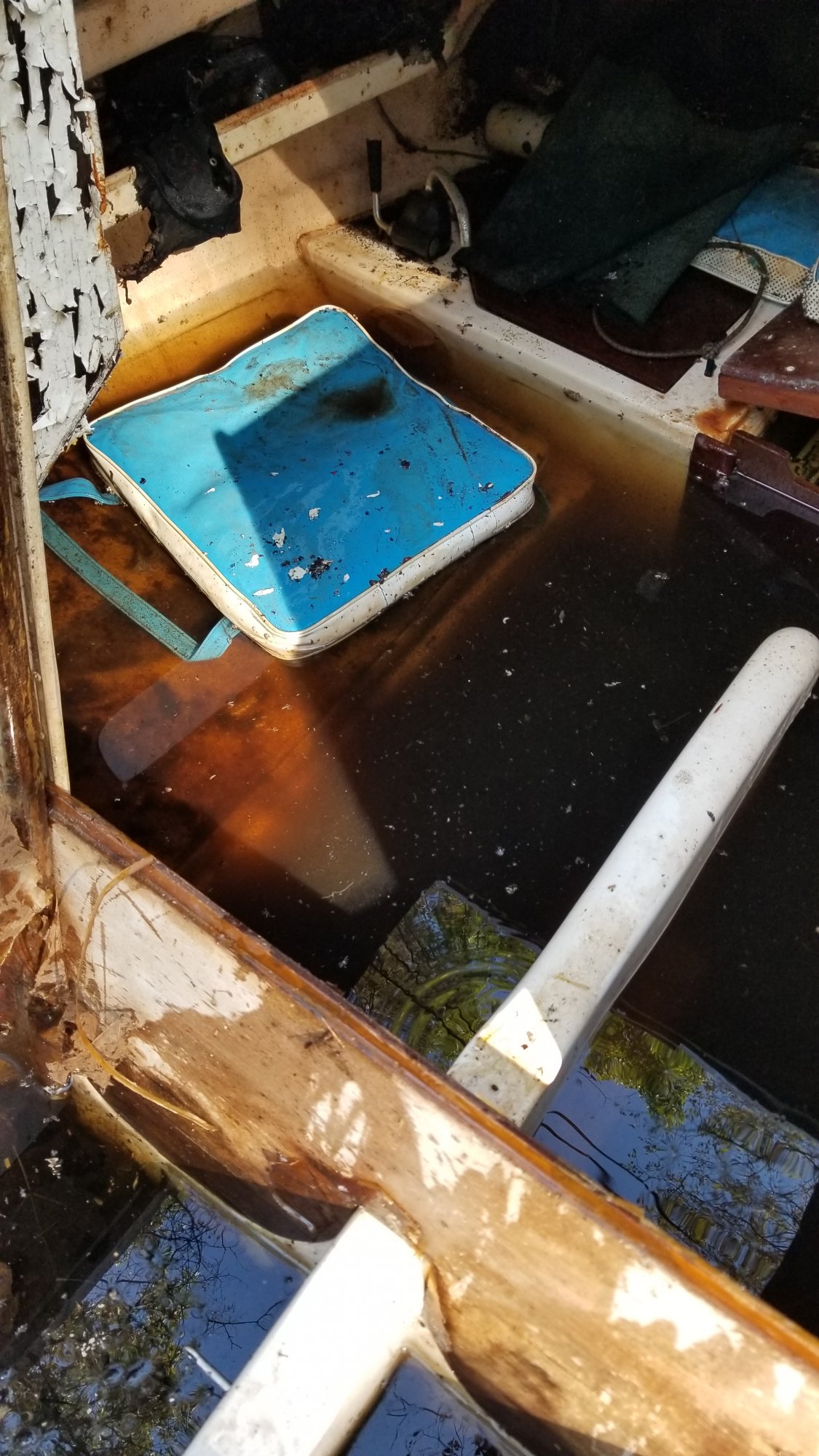

As for pics, ask and thou shall receive! I expect nothing but laughter and responses such as "Buddy, are you feeling all right?" or "Perhaps you should lie down and think this one through a bit more." I should have taken pictures of the hull and topside as these would at least somewhat explain my interest!
Starboard settee: waterbed edition. Naturally, I haven't been able to see what's under this cushion: if it's all fiberglass, I'll be a happy boy; if it's not, I'll just have to hope O'Day was more liberal with their resin applications than MacGregor was...
Port cabin from the companionway: keel trunk is visible as is the galley. This area is of the greatest concern to me since it's hard for me to picture this being 100% glass and without core. Note that I had stirred up the water in a pathetic attempt to bail some of it out with the bucket that's floating in the picture above. I was able to see right through to the bottom just before this was taken.
Cockpit and companionway: due to how the keel trunk continues into the cockpit, there is a scupper on either side up against the cabin. Assuming flooding occurred (as Will mentioned earlier) when these clogged from leaf debris and the water had no means of egress. I've walked around all over the cockpit benches and was surprised to find that everything felt solid under foot, including the sole (I was in sandals and braved the muck to test this theory). The boat was covered with some medium-duty tarps which, of course, have a very limited life span so it wasn't long before water found its way inside.
Final thoughts: It's a mess; an utter disaster. It'll be a couple more weeks before the owner is home and I look at her again. As many have noted, there is a grave concern about any core within the cabin as it is surely rotted through IF it is present. The best I can do right now is wait for her to be drained and then I can get inside and do a proper inspection. As I've been saying, I have no qualms about applying a heavy dose of elbow grease to clean up the mess. All the accessories that have been lost to the moisture are of little concern to me since I am only interested in getting her out on the water.

That boat is a biohazard. I hope you didn't contract anything fatal while taking those pictures.

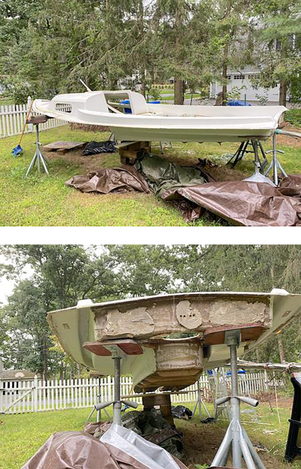

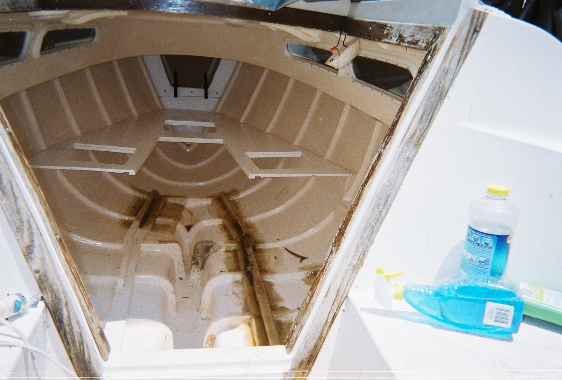

Early Mariners used a lot of plywood as core underneath the fiberglass. My concern would be -- after all that time as a bird bath -- that most of that plywood is rotting, underneath otherwise-fine-looking glass. It's not a simple or time-effective repair to cut that wood out, re-glass, and re-skin. Beyond that, there are wood reinforcements down below that are pretty-much inaccessible that might also have rotted during the long soak...
Mariners are great boats. But almost 5,000 of them were built and most of those are still being sailed. The masochist in you should be aware that about the time you're figuring out how to un-sandwich the hull from the deck on your way to spending hundreds of hours and thousands of dollars on your project, you're going to see beautiful, ready-to-sail Mariners up for sale (for less than the cost of their recently-replaced sails). For perspective, I found a 1989 Stuart Mariner (no more plywood, no cast-iron centerboard, other improvements) for $1,900 about six months ago. It was ready to sail and in great shape. I suspect the cost to bring your boat up to the same condition would be much greater than $1,900, even with all your labor coming for free.
This is not my image, but it'll give you an idea of what you might be in for.

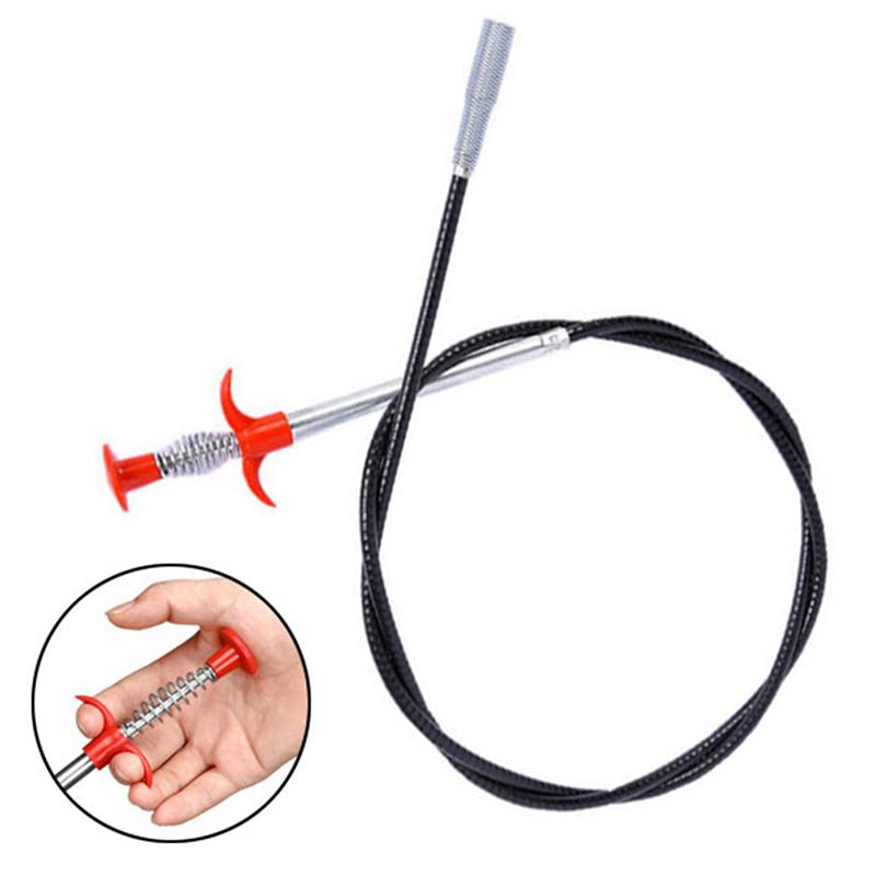

Use a small wire drain snake
to clear the scuppers. There have been Mariner owners who actually drilled a drain hole in the bilge just ahead of the CB trunk and put a plug in it. I wouldn't go that route. Pull the scupper hoses. Cut access ports into the bottom of the v-berth and quarter berths, run a heater and fan for a couple of weeks to get the foam to dry out or just pull it all out. Install water tight ports in these areas and if the rotted core becomes a problem when you stand or lay on it, just fix that area by opening it up or reinforcing it.
