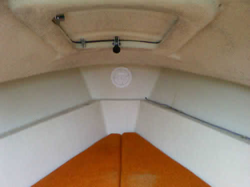

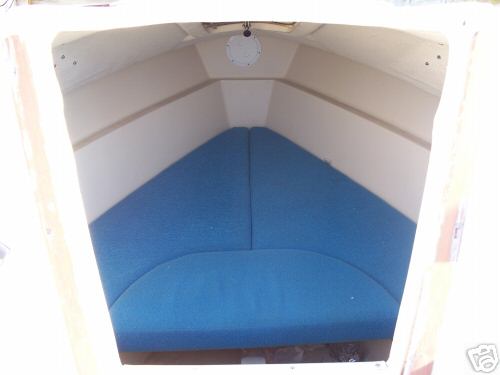

I have a few pictures of how other owners installed an inspection port at the forward end of the V-berth to access the bow-eye for repair/replacement, that may help. But. That won't give access for bailing out the water. Also, I'm confused what part of the boat you are refering to when you mention the "anchor well" as a location for the inspection port..... I don't remember any of the 19' O'DAY models having an "anchor well", so I can't comment on whether that would be a good idea.

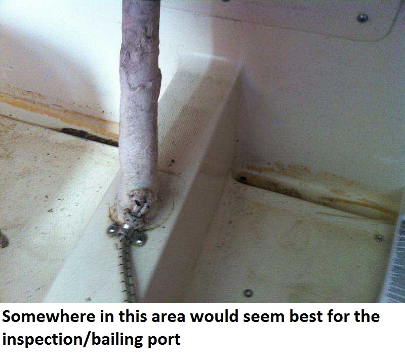

If you need to bail out under the V-berth, I would think that you could install an inspection port on the top of the V-berth, although I don't think that area is actually sealed off from the rest of the bilge and should water get in there it should drain aft to the area under the cockpit. You would then be best to install the inspection port in hte cabin sole (floor). I know another owner mentioned water collecting there. That would seem to be about the lowest point in the bilge with the boat floating normally, and so the best place to bail from. Perhaps anohter O'DAY 19 owner could comment.

Under the V-berth is a pretty odd location for a dedicated anchor well, most boats would have the anchor well compaertment on the foredeck. Does your boat match the pictures that I posted? I didn't think there was any stwage compartments under the V-berth on those boats from the factory. Perhaps your anchor well was added by a previous owner. Especially since under the V-berth is the last place I'd want to stow my primary anchor, 1) hard to access if I need the anchor in a hurry 2) I don't want to have a stinky anchor and rode under the berth as I'm trying the sleep..... PEEUH! Fresh or saltwater, it doesn't take much mud or such to produce an odor.

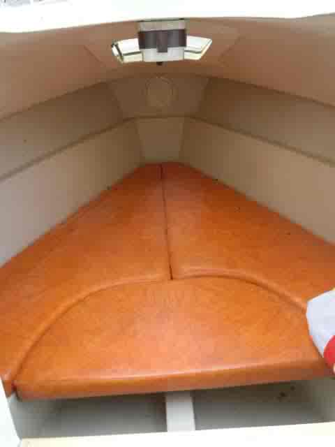

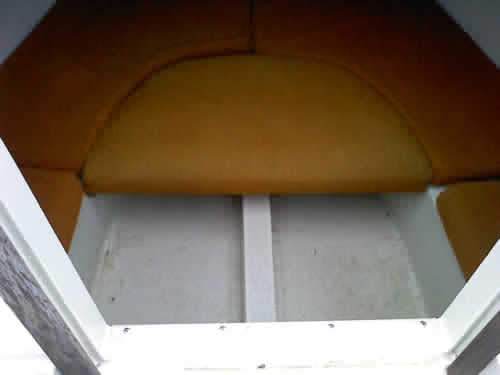

The trapezoidal storage compartment in the V-berth under the cushions is an appropriate size for a small anchor. But it is not a convenient location. It is a dry compartment with no drainage.
I needed to access the bow eye and pulpit bolts. First I cut a round access port. Later I cut out a large section to give me encumbered access to the bolts. I like the access and will later cover it with a plywood panel similar to the one on my Capri 22. (I like easy access to all mechanical and electrical parts.)
The compartment was full of styrofoam chunks. I removed these pieces. It is just a small part of the whole floatation foam.
