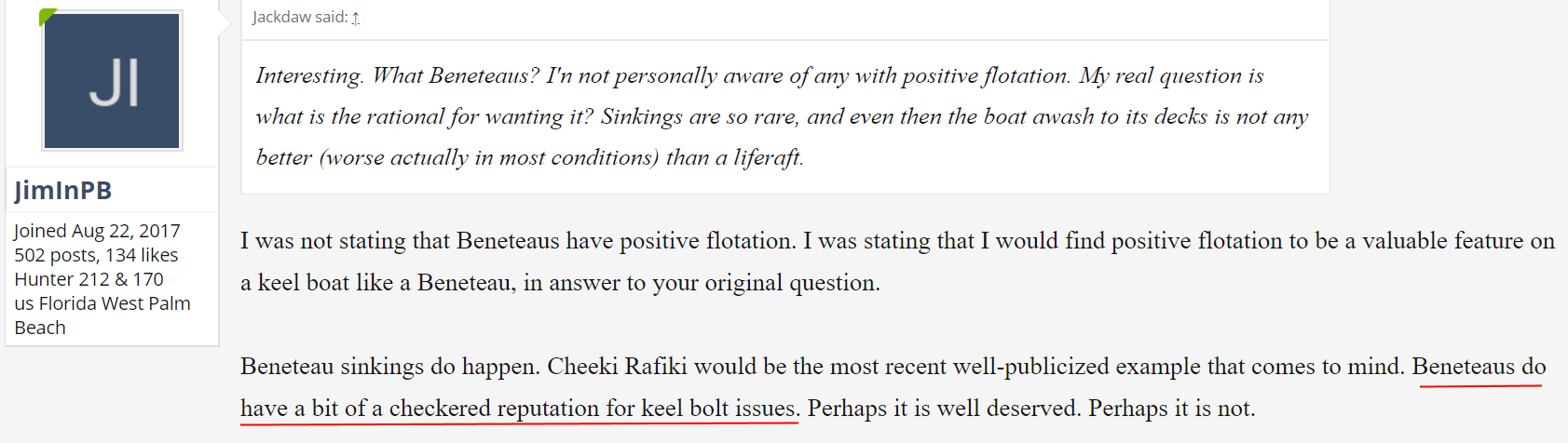

Interesting. What Beneteaus? I'n not personally aware of any with positive flotation. My real question is what is the rational for wanting it? Sinkings are so rare, and even then the boat awash to its decks is not any better (worse actually in most conditions) than a liferaft.
I was not stating that Beneteaus have positive flotation. I was stating that I would find positive flotation to be a valuable feature on a keel boat like a Beneteau, in answer to your original question.
Beneteau sinkings do happen. Cheeki Rafiki would be the most recent well-publicized example that comes to mind. Beneteaus do have a bit of a checkered reputation for keel bolt issues. Perhaps it is well deserved. Perhaps it is not.
