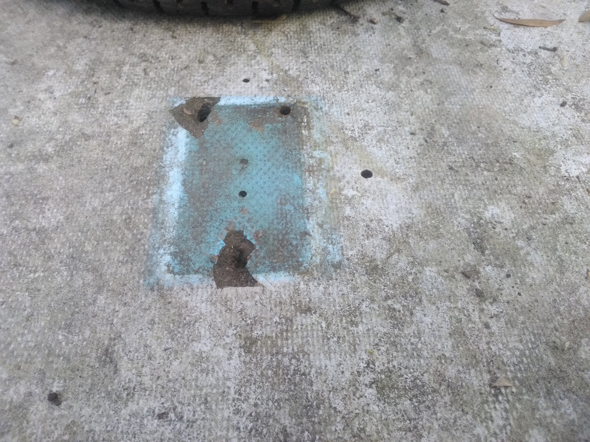

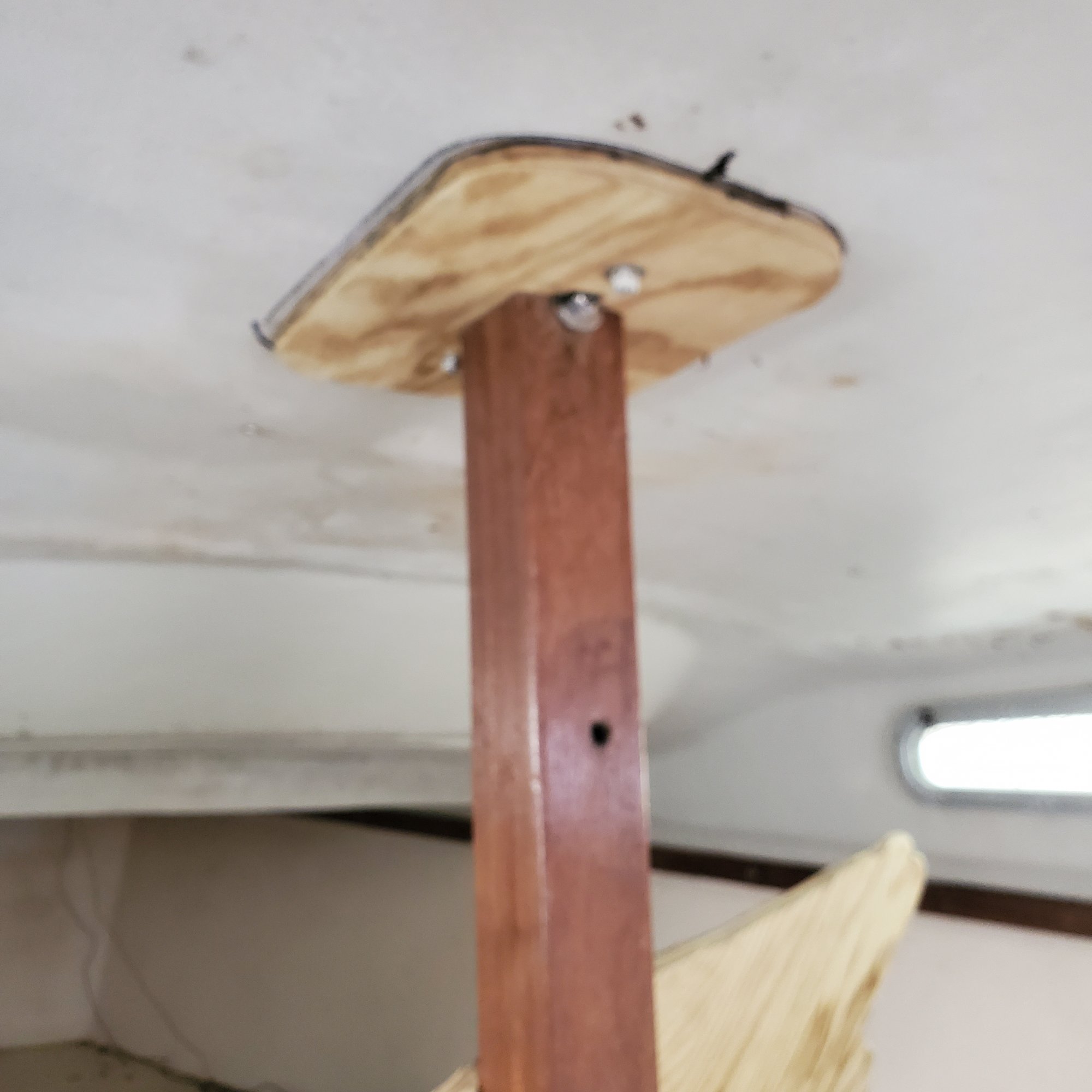

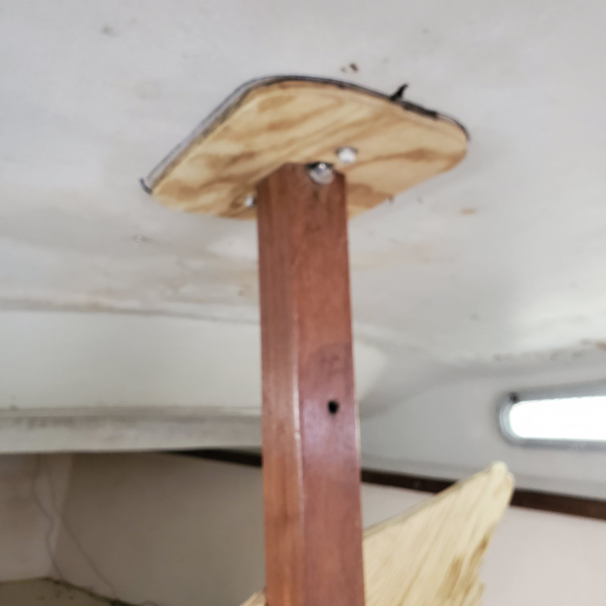

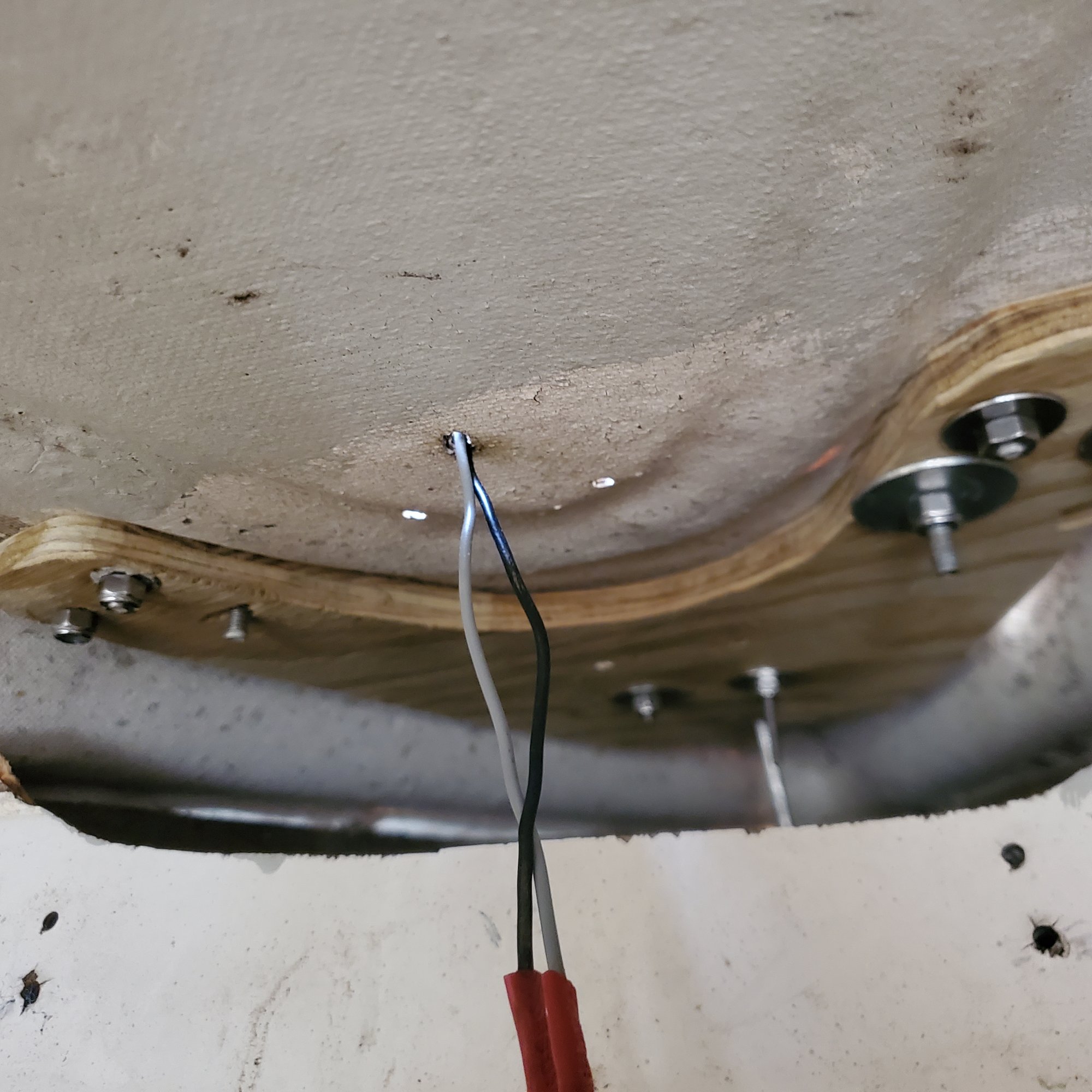

Flimsy deck and bow cleat. Post n bow backplate needed. The po had cut a 1.5" by 1.5 hole in forward bow, probably for shore power and the cleat and bow rail were dangerously flexing. This 1975 beauty is worn and only a thin sheet of original fiberglass was holding the hardware. The tabernacle was also in question the 3 holes were wallowed out and cracked. I'm installing a bulkhead so when the compression post came out the deck flex was incredibly scary. Here are pics of what I did. What do you think? Should I resin the plywood? I know a sheet of ss or aluminum where the washers are would be optimal but cost of stainless is a problem.

Is there plywood inside the boat's fiberglass? If so, you need to find out if it's rotted before doing anything else. You can try tapping the area and listening to the sounds. Rotted areas usually have a duller sound. But that isn't a guarantee that what you hear is accurate. It's more of an indicator in my opinion. My deck sounded and felt solid but low and behold, it had a lot of rot in the same area as yours. This often happens when holes are left unsealed or sealant has failed.

Thanks Project Mahem good point. There is no core or multi layers its just fiberglass. There are 2 stringers running a beam fore of the compression post. You can imagine the flex without the post installed. It's a pop top so just behind the tabernacle the shape is formed with a lip that adds strength moving back to the coaming.

The proper thing to do would be to use marine grade plywood and laminate it in epoxy. The next best thing would be to use outdoor rated plywood and laminate it to your boat.
Now with that said, your boat has survived nearly 50 years without this extra material. Assuming that there is nothing else wrong I'd like to propose a different approach. I tore apart the bottom of my foredeck last summer. Grinding away at old fiberglass and balsa was by far the most miserable boat project I've ever tackled. Laminating yours requires removal of paint before hand so it wouldnt be as bad. What I'm proposing is to get some outdoor 1/2-3/4" grade plywood, give it a good coat or two of epoxy to seal it and then install it on the boat. Double up on fender washers for your hardware and be sure to use some Bed-IT to seal all the hardware. Stronger than new!

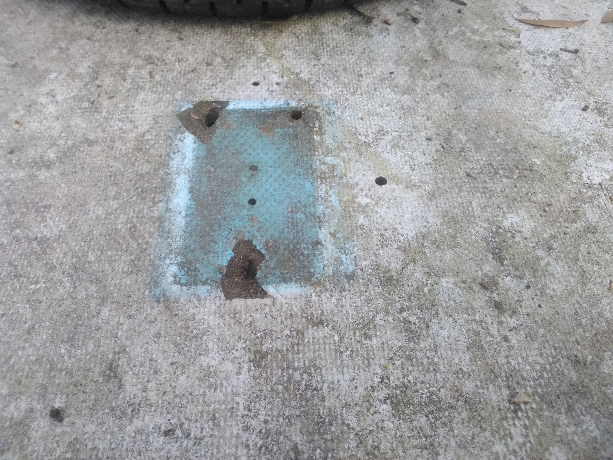

How does one go about repairing a rotted core. It has taken me time to figure my deck has a core in select areas. It is a pop top and it appears most of that is with core. There 2 narrow areas sloping down away from the pop top away from center that may have a core. Other than that nothing forward of the tabernacle has a core.
I'm concerned because one repair day I had a pot of wet epoxy and duct tape, to seal the hole bottom, and I sealed every hole I could reach. Most glued up nicely but a few just sucked up the epoxy and took more. They never completely topped off like the single layer holes.
There's a few different techniques depending on the application. West Marine's fiberglass manual is considered by many to be the holy grail. BoatWorks Today also has some excellent material. If memory serves me correctly, West's manual usually states to tear out the rotten material, clean it up, wipe it down with solvent, apply a couple layers of epoxy and 1708 cloth, add balsa and then some more fiberglass cloth
Use more thickener. Sometimes multiple applications are needed. Syringes to inject the epoxy help make application easier. You can also use products like Thixo or Adtech P100 (available from Express Composites)

I'm almost sure the second application will finish sealing the hole. It's amazing how the mixed resin retains surface tension even though I'm using slow cure hardener. I wish I had anticipated hollow space cause I have large volume syringes. This boat does not have a liner above the rub rail and it's a mystery where there is core and not. The areas that were 1st attention "bow rail/cleat and tabernacle" are just a single layer an 1/8 inch or less. Backing plates resolved those concerns and sealing the top deck will grant a stopping point.

One little tip... If you need to keep resin on the outer skin of the fiberglass while reducing the absorption, put a piece of tape on the top of the filled hole. It's useful when the resin just keeps seeping inside a cored deck and you're just trying to seal off a hole. Yes, filling it in entirely or ripping up the deck is the correct way but some boats have a lifetime supply of projects. I also do this same trick to reduce sanding when filling in small holes as the cured resin ends up being pretty flush with the surface
