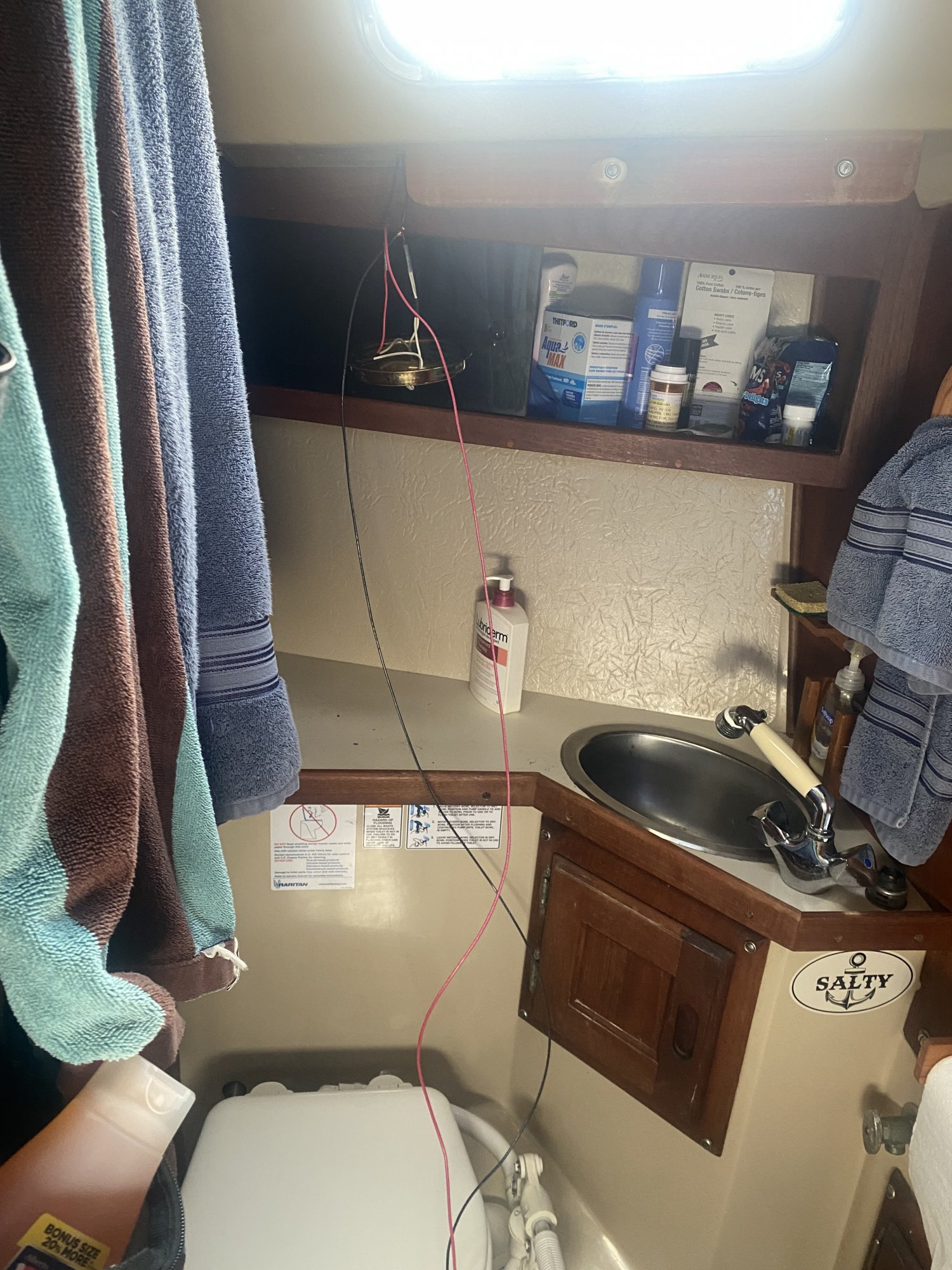

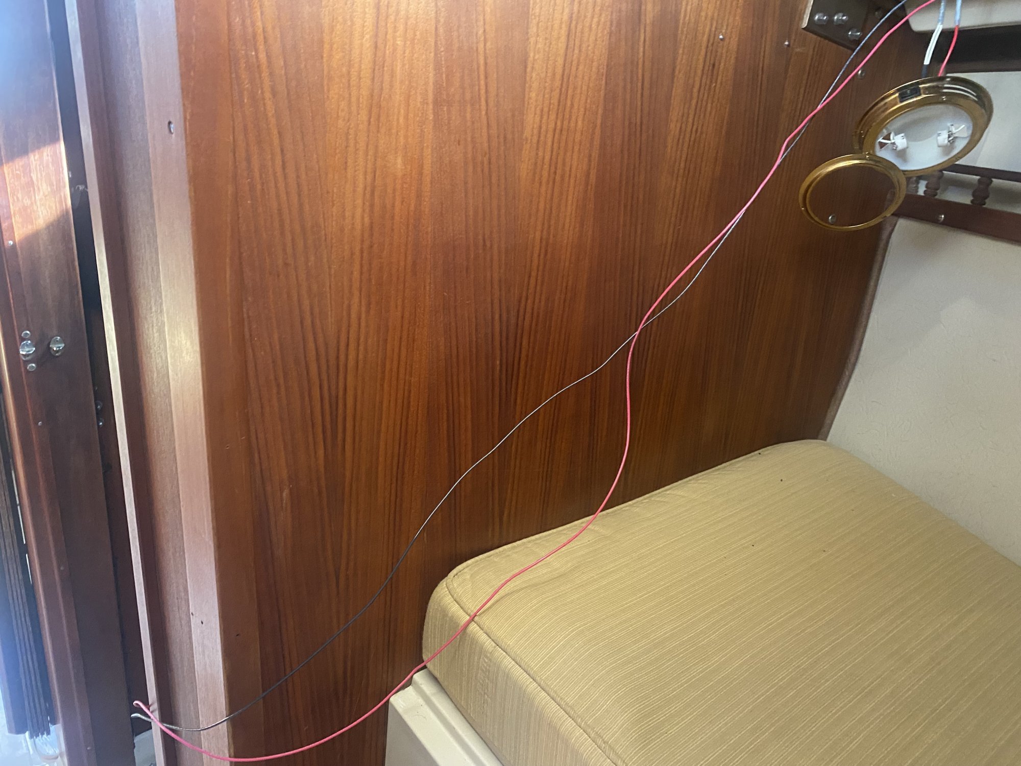

Hi all just and update. The cabin lights are in parallel. Used just a little common sense and followed where the last light was working and the next one was not. lights on in the head and failed in the V-Berth. So I just manually wired the head light to the port V-Berth light. Wires outside the head just to see if it worked. By passing original contact between head light and V-Berth light. All lit up!!!! Now to find an aesthetic way to wire them together. Thanks for all your help :)cabin light test one.jpgcabin light test 2.jpg

Pete. Did you find any corrosion on the connections at either the head or the V-Berth? I would suspect the moisture in the head could have caused corrosion on the contacts in the head or a poor wire crimp on a fastener. Clean the contacts, spray a little "Corrosion Block" on the contacts, and then test. A lower possibility would be a pinch or a cut in the wire. Sometimes caused by a screw penetrating the wire or chafe where the wire has moved frequently over a sharp edge.
If you find the wire showing corrosion on the strands, just clip off 1/4 inch. Upon finding fresh wire, crimp on a connector and put the lights back together.

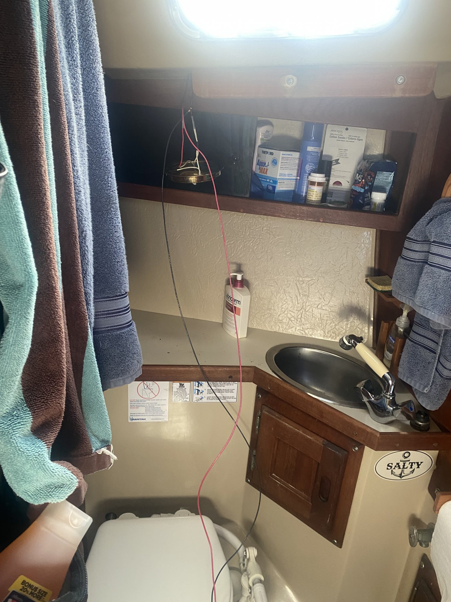

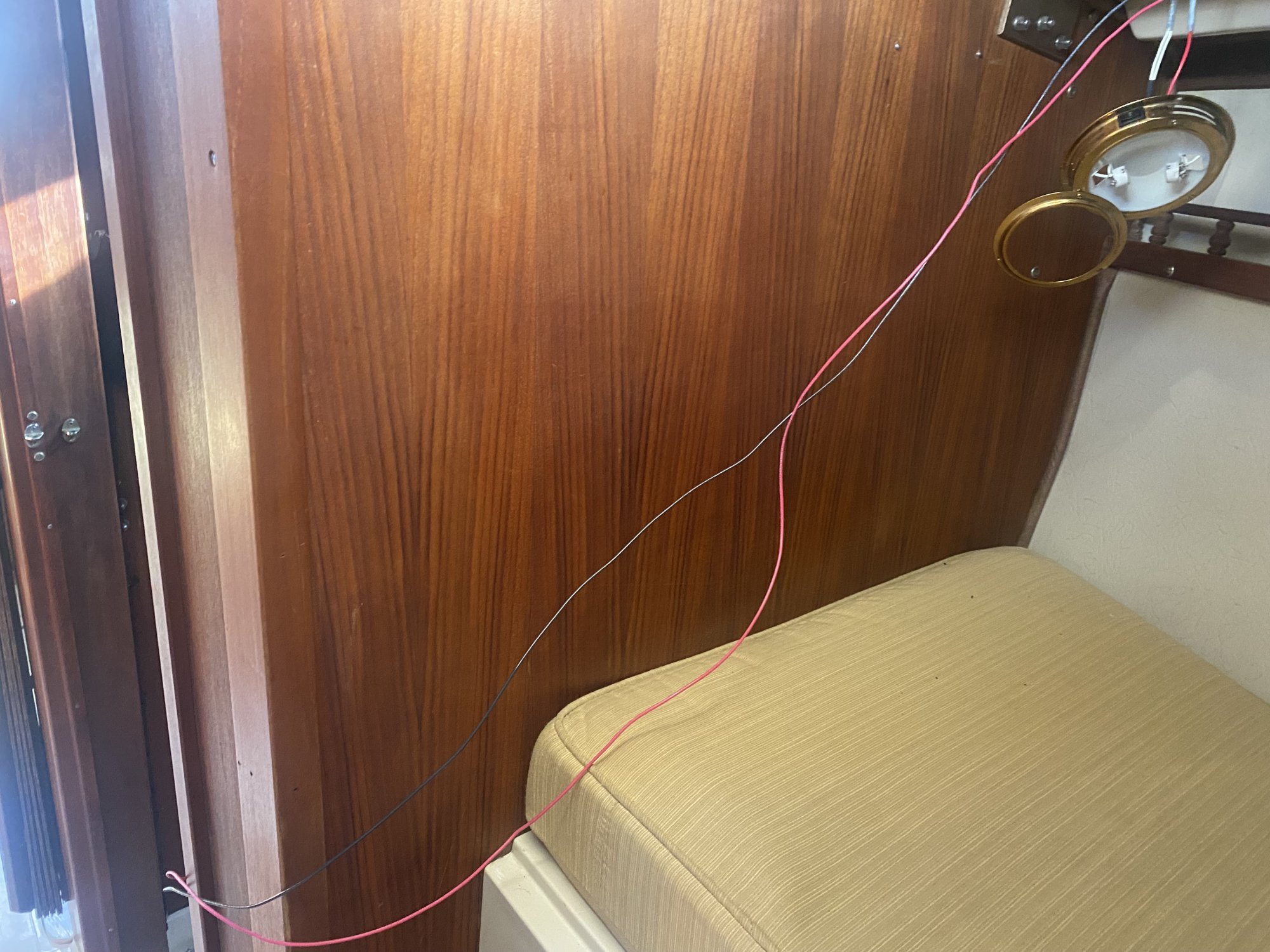

Hi all just and update. The cabin lights are in series. Used just a little common sense and followed where the last light was working and the next one was not. lights on in the head and failed in the V-Berth. So I just manually wired the head light to the port V-Berth light. Wires outside the head just to see if it worked. By passing original contact between head light and V-Berth light. All lit up!!!! Now to find an aesthetic way to wire them together. Thanks for all your help :)View attachment 225561View attachment 225562
YES - Corrosion was on light in the head---- It seems that it fried the wires between the head and V-Berth. Catalina seems to have buried wiring in the deck so it is not accessible and it appears glued in as you can't fish wire either.....
