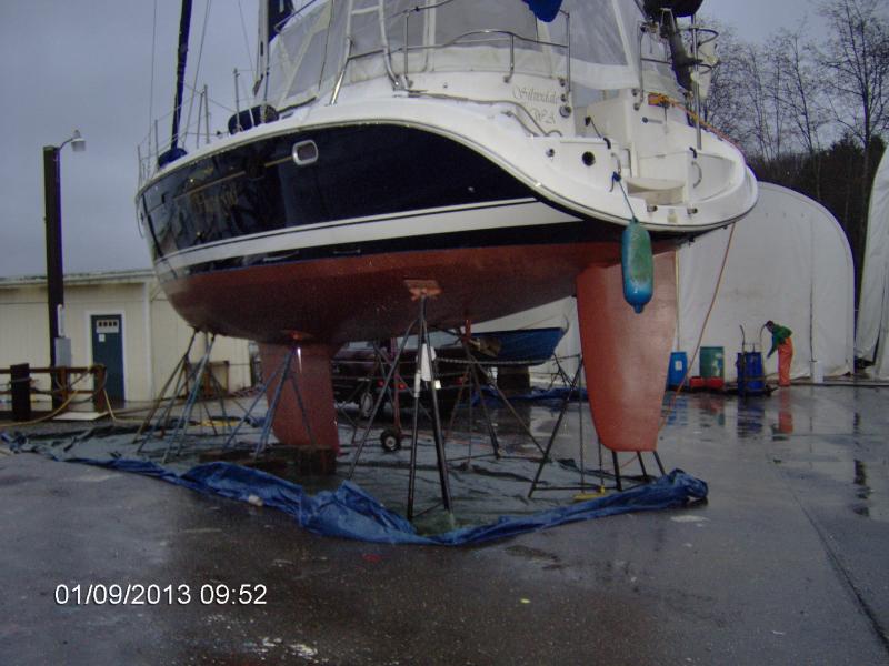

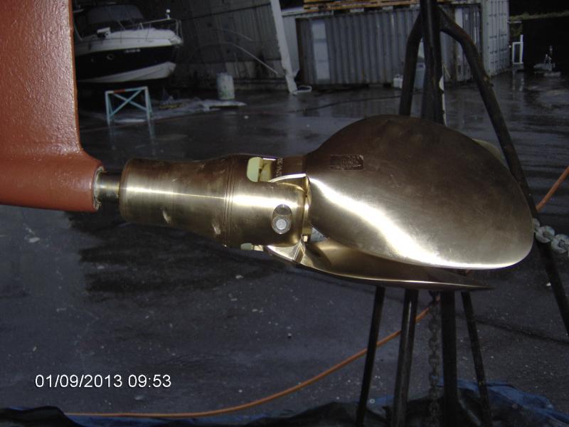

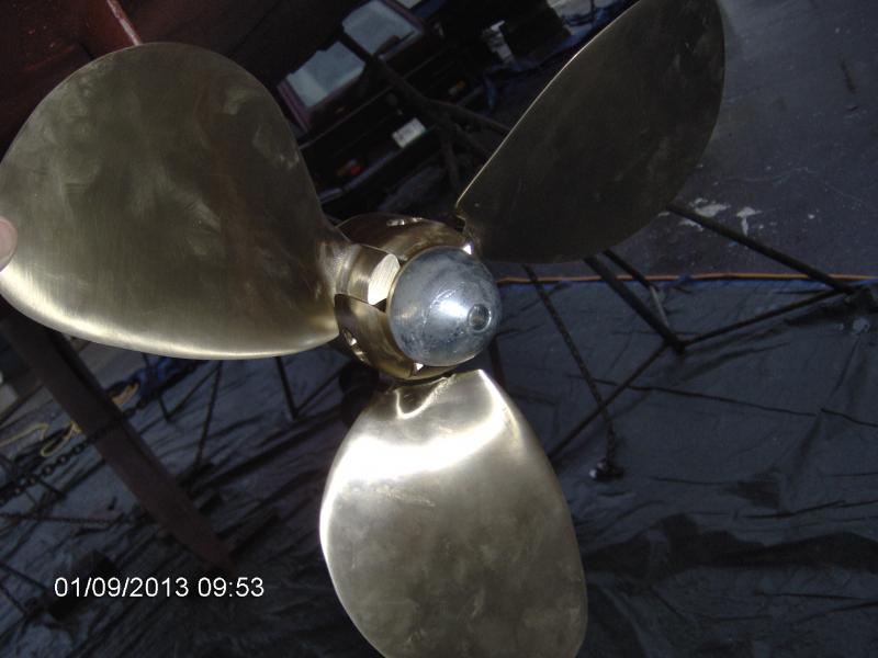

Our H466 on the hard at Yachtfish Marine, Port Orchard, Wa., with its new bottom paint and three blade 20x14 Flexofold. It looks too nice to get wet.
Looks good, did flex fold spec out your prop using your engine info? Just wondered cause I think my passage 456 has the same engine and transmission but my prop is a three blade but not as large as yours

Hmmmm very pretty! :thumbup:

Yes, they spec'd it out using the 76 hp, 2.63 reduction gear, 1.25" shaft. And an identical 460 down the dock has had the same 20x14 for three years and loves it. He went from a 3blade fixed 18x17 to a Max prop but became very disillusioned with the Max prop whengalvanic corrosion forced a $1500 rebuild. Of the three props he was most satisfied with the flexofold.
