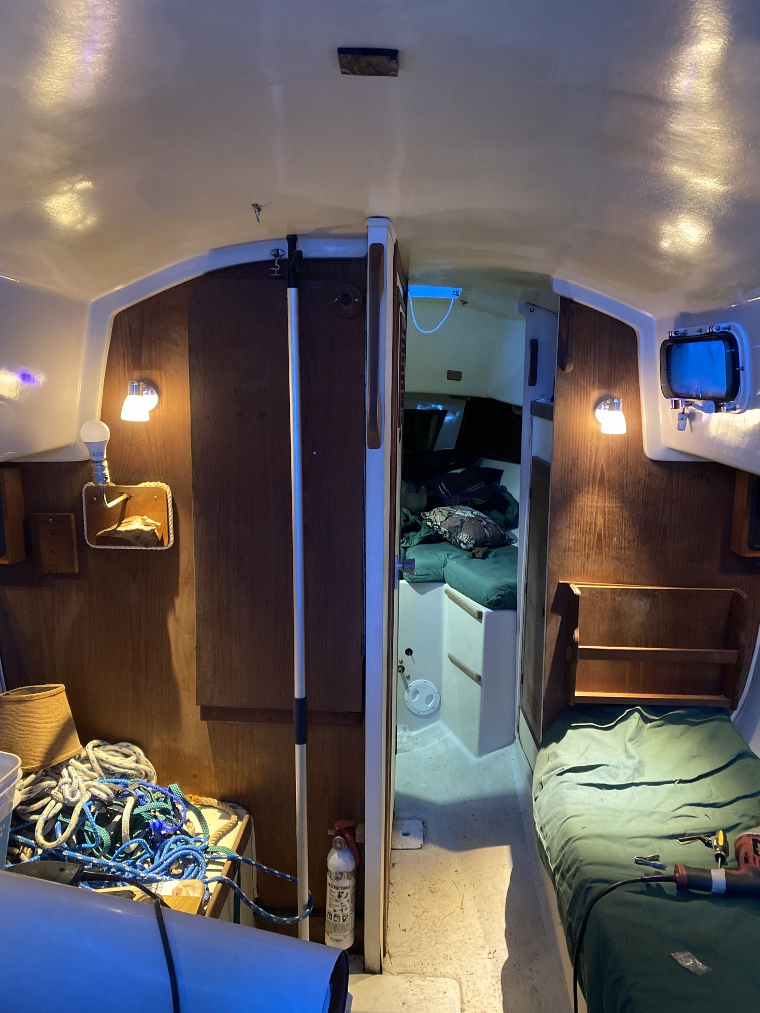

Thanks, she’s an old boat (1972) so there may be some fatigue but not in any hull integrity sort of way. The space below is about 2 inches so I’ve considered some wood with epoxy to reinforce the floor before I lay down some faux teak. The attached photo isn’t the exact location however shows the general are.

Plymouth Sailor, in the image you transmitted, I did not see a typical floor. The area of the floor visible was in the V berth. It appeared to reflect the shape of the hull (slopped sides). If so I would be very cautious drilling into that area. It may be the hull itself.
From your attached text it appears you did not show the actual area of concern.
Not knowing definitively the area you are concerned about, any suggestion would be little more than a SWAG... I would not be working on my boat based on a SWAG.
