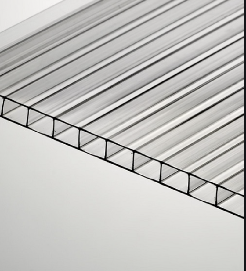

I attach1/4" thick clear twin-wall polycarbonate panels to the back of the flexible panels. You can get these at Home Depot. These are used for green house windows. They are extremely light and are almost invisible under the panel. I attached the panel to the polycarbonate using 1" bits of 3M VHB tape. The polycarbonate is flexible enough to follow the curve of the bimini but stiff enough to protect the flexible panel from flexing too much. This also insulates the bimini fabric from the hot panel. With the polycarbonate you can also run the panels across the bimini bows.
I sewed little sunbrella loops to the bimini and then simply tie the panel to the loops with thin dyneema cord. I've had no problem with the panels lifting in the wind. They just lie there even in 40knot winds. Also no visible chafe in three years on the sunbrella - which makes sense as the polycarbonate is very smooth (I did wrap chafe tape along the edges). If I need to take the bimini off for a storm, I just cut the cord, store the panels, and then retie with new cord after the storm (BTW, install some form of wire connector so you can put your panels below during a storm).
Be extremely careful handing the flexible panels. Don't let them "flop" around when installing. Bending one just a little too much will break a solder joint inside rendering it useless.
