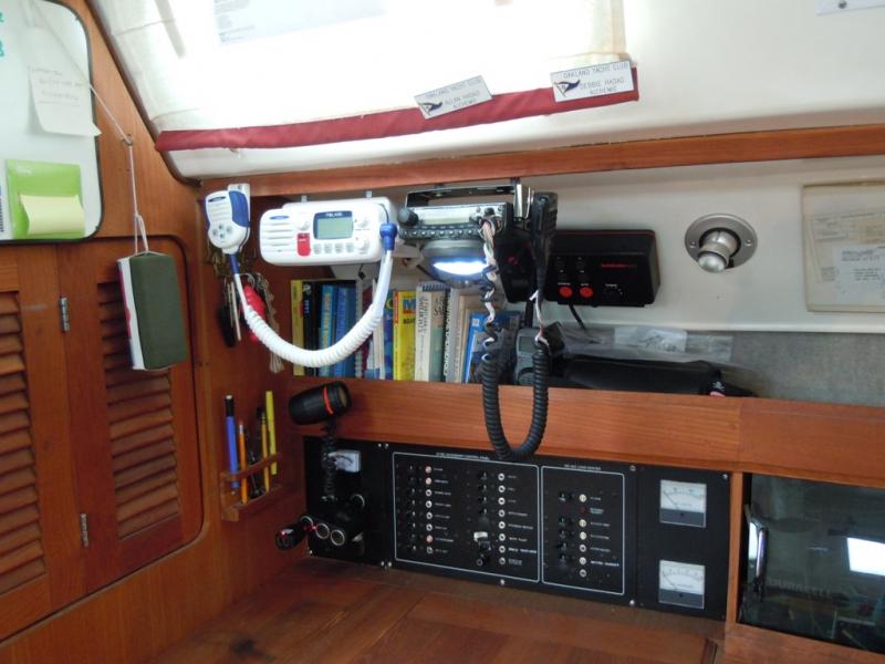

On my h40.5 I already had the best TV wall space utilized, so I used an articulating arm mount near my nav station. The advantage for me was that I can position the TV for viewing anywhere in the salon and the power and antenna connections are right behind the TV in the nav power panel area. I needed to fabricate a small piece of teak to move the TV away from a swing-down cabinet, but otherwise it was a simple "bolt it on" installation. I have a 15" 4:3 format HDTV with a built-in DVD player that all runs on 12V ship power. I've had it for 3-4 years so it is a LCD type of unit. I secure the TV when underway with a bungy cord that attaches near the back of the top of the TV, over the TV and to a hook under the bottom.
I have attached some pictures below that may give you some ideas for your own installation. I think a 17-20" TV is entirely sufficient in size, but that's my personal opinion.

Do you recall the manufacture of your swing arm? I also assume you have a backing plate (metal or wood) in the cabinet supporting the mount?
Robert,
I'm sorry, I don't remember the manufacturer of the mount. I picked it up on eBay for about $15-20. I remember that the important features were that the mounting hole pattern matched my TV and that I had freedom of movement to position the TV to face anywhere I needed.
The wooden offset piece is thru-bolted to the cabinet with fender washers, locks, and nuts on the inside. The base of the arm is bolted to the offset with counter-sunk screws and nuts. The base of the arm hides the nuts and lock-washers.
