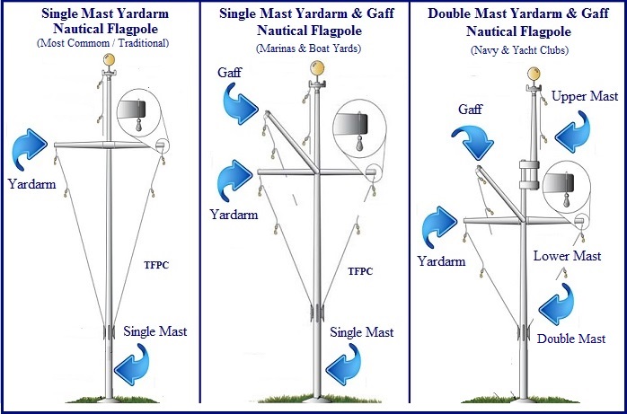

It looks like you can use one set of spreaders as a yard arm, and then you could optionally add a gaff. There would be no shrouds as they would interfere with flag movement, but halyards to the top of mast, to the end of each spreader, and to the end of the gaff (if added).
