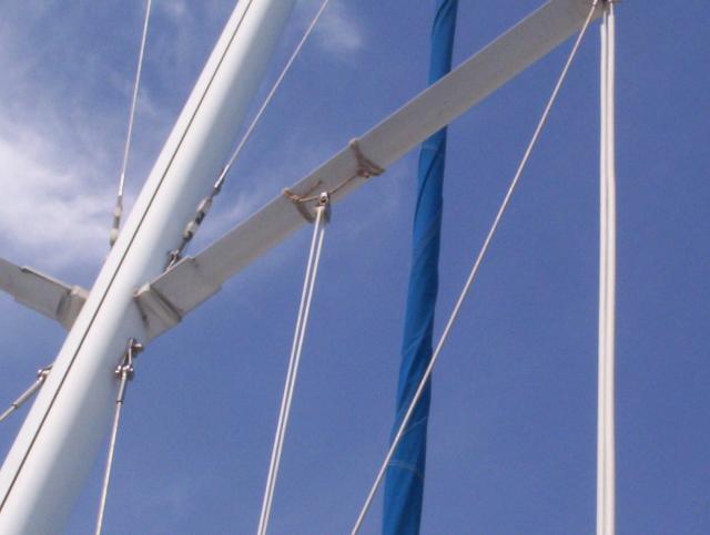

Simple job!
I lashed a small block to a spreader. Used 1/8 inch nylon braid and cheap bronze swivel shackles from home depot held to the line with lark knots. I added a shroud cleat. Otherwise, you can tie it to a cleat on the mast or the lifelines.

I pretty much did as Prime Time describes on my H28.5. When I first decided to lash, rather than rivet, a small block to the lower spreader, I did so as I was not sure I really wanted the flag halyard and this was to be a temporary install until I could pop rivet a pad eye to the spreader. I used some narrow guage Spectra tied with buntline hitches. The lower end of the halyard ties off to a small horn cleat on the inside of the forward hand rail.That was 3 years ago and it's still there and working well....
