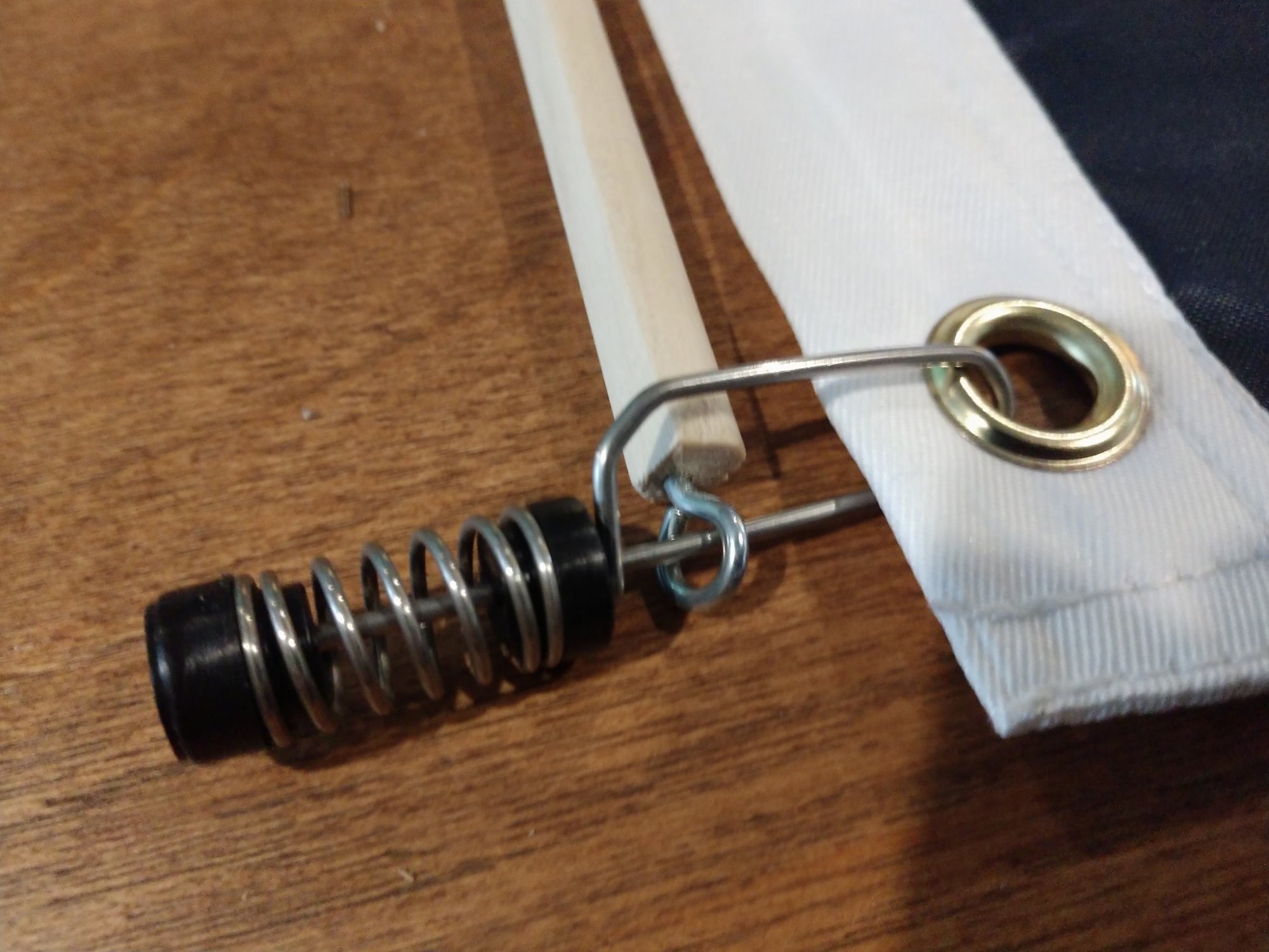

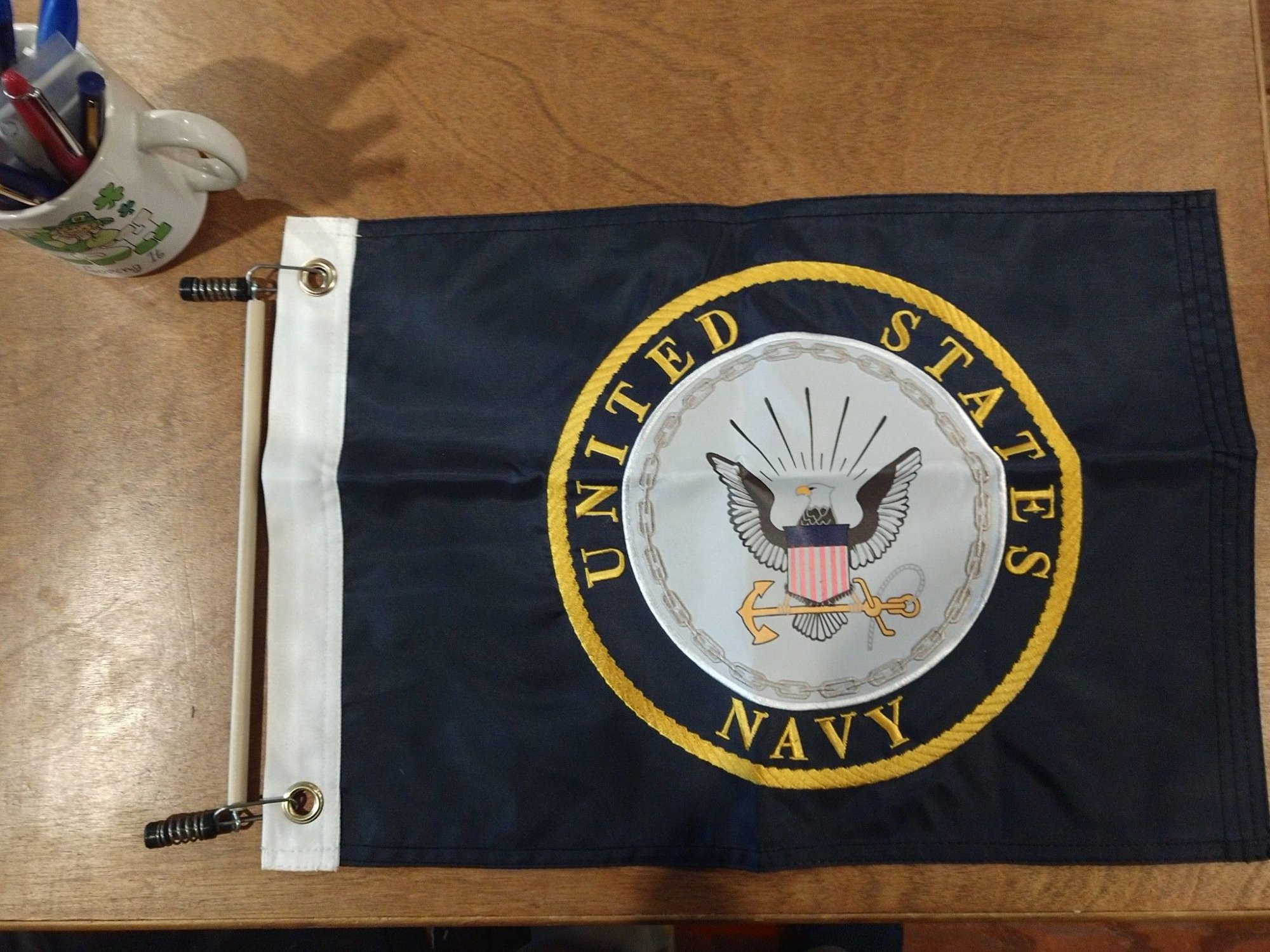

Having not yet rigged flag halyards on the Wet Dog I tried using flag clips that I purchased from Amazon ( DU-BRO Fishing Flag Clips for Halyards and Outriggers). I put them on the Starboard shroud with a Yacht Ensign. The only issues was after a time the clips would slowly come together and I would have to separate them using the boat hook. I made a spacer with a dowel stick and two eye screws. It works perfectly.IMG_20211206_082327289.jpg

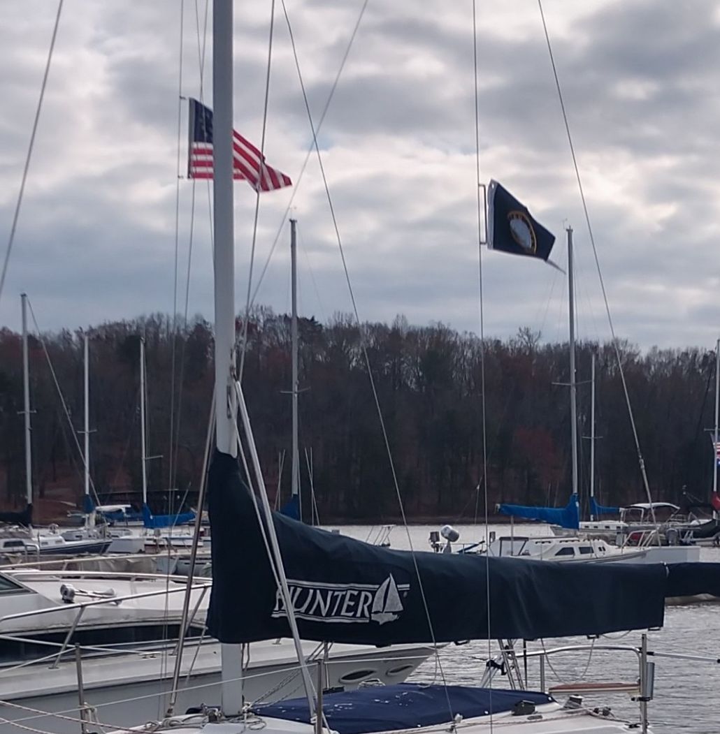

After about a month the flags have not caused any issue, even after an after noon with 15 mph winds with gusts to 20. I plan to add flag halyards to the spreaders this winter whenever I drop the mast.

Having not yet rigged flag halyards on the Wet Dog I tried using flag clips that I purchased from Amazon ( DU-BRO Fishing Flag Clips for Halyards and Outriggers). I put them on the Starboard shroud with a Yacht Ensign. The only issues was after a time the clips would slowly come together and I would have to separate them using the boat hook. I made a spacer with a dowel stick and two eye screws. It works perfectly.View attachment 200728
my clips have so much spring that they don't budge after I clip to the shroud. They are even hard to compress.

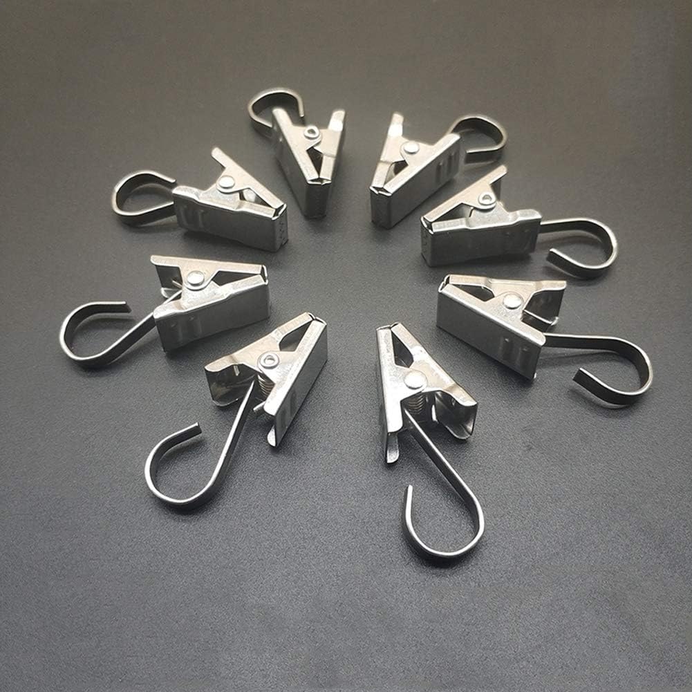

The problem with those
those
is that they are too hard to attach and detach. So when you haul down your flags you’ll curse a blue streak getting them off and hate putting them back on next time.
That's why I switched to the clips I showed. The loop goes through the flag grommet and tightened with pliers and left on. Then you just clip onto the halyard. Easy peasy. I’ve never had one come off even in very strong winds.
