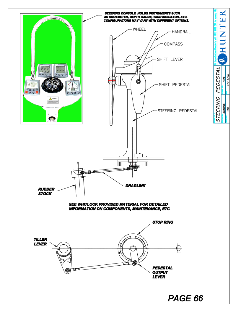

Ultimately, I pulled the wires enough to be able to reconnect them, solder them together and insulate them individually as well as the whole reconnected part of the cable using heat shrink tubing. Once I got the cables back in place and away from the steering mechanism, I made sure they cannot move out of place by wedging them in with a piece of hard insulation foam I had handy. For good measure I fixed that piece of foam with some Gorilla glue. I am attaching a page from the manual to show relevant parts of the steering mechanism

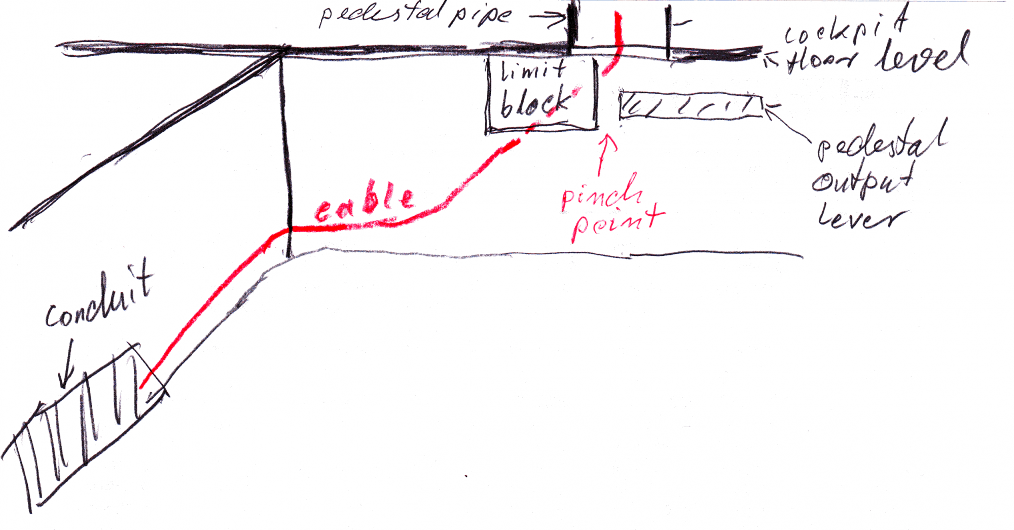

I disagree. Routing of the cables is part of the overall boat design. There is nothing under the pedestal that would separate the cables from the steering mechanism. They just come out of a flexible conduit and turn in the deep corner of the space there to the right and then up into the pedestal tubing. They are bound together with ties, but there is nothing preventing them from moving from behind the limit block towards aft and starboard and around the limit block into the pinch point. There was enough slack for this to happen. See my rough sketch below.
So unless some part preventing this movement was designed but not installed, with all vibration and boat heeling and jumping the waves this was bound to happen.
I did not create my post to indicate that the boat was poorly designed, after all it worked for 17 years, but some things could be improved. More importantly, someone with similar issue can save some time doing troubleshooting, or prevent this from happening on their boat.
