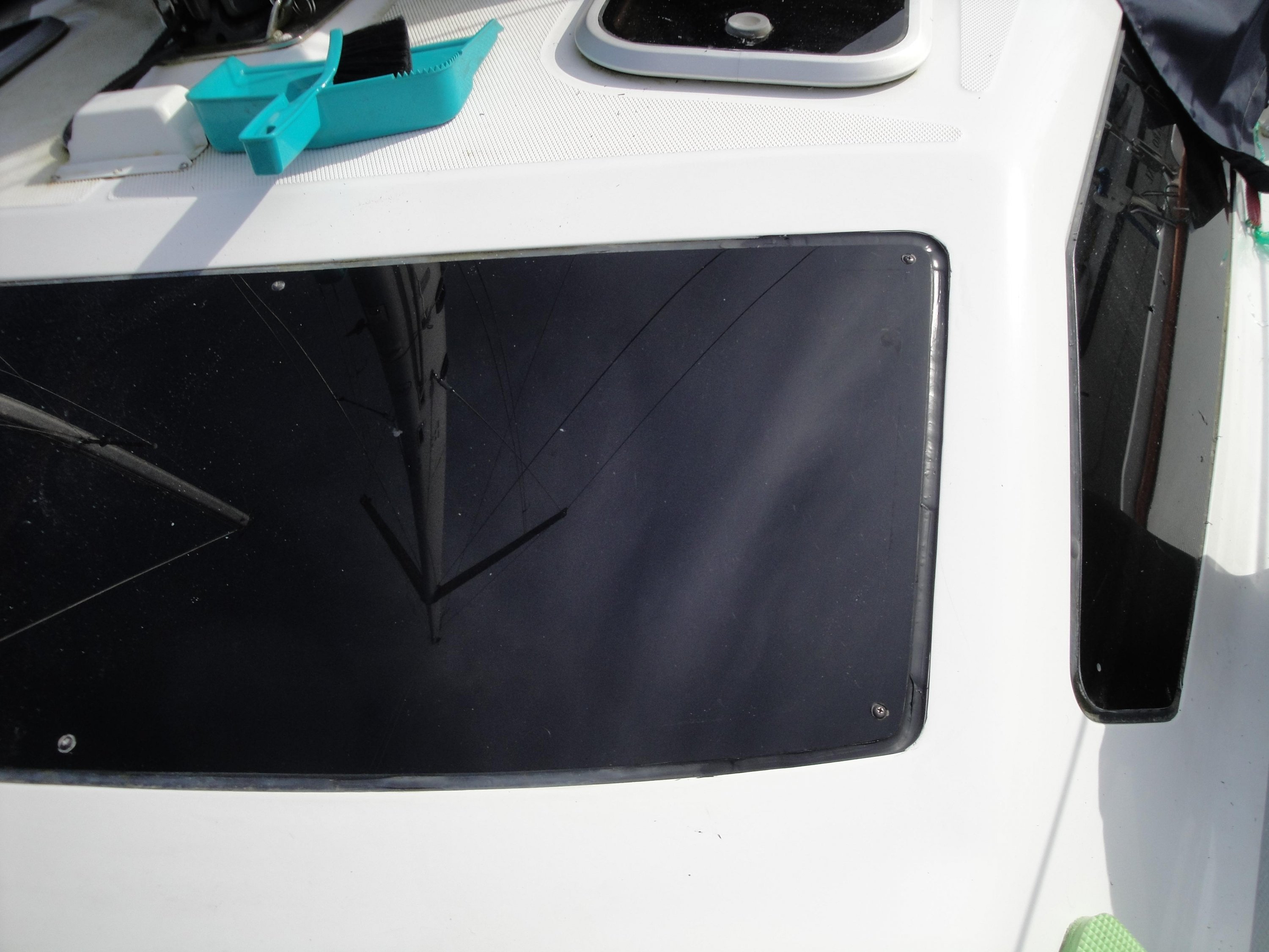

i am redoing the seals on my American 21 cabin windows. They originally had silicon around them and were riveted straight to the fiberglass cabin. It is basically a plexiglass style piece riveted to the boat with no frame. The silicon was good but the rivets were leaking so I pulled the window. I was wondering if butyl tape would be better than silicon.

I used the Sail mag article to replace my fixed portlights. They had been screwed into the sides of the cabin, and then the gelcoat spider cracked over the years, until the crack ran under the sealant and out to exposed gelcoat. Then water could get through the crack, under the sealant, and into the screw hole to drip inside. I've been happy with the VHB tape, it hasn't let go after 2 seasons. You'll really have to work to get the contaminated gelcoat off. I cleaned mine with goof off professional, which is manly some kind of petroleum distillate solvent. Then, I sanded the gelcoat to get the silicone contamination off. Resealed with Dow Corning 795. The boat looks really slick without any screw heads in the plexi. I think the article recommended painting the plexi with silicone based paint, which I used exhaust paint. However, I think it would be better to use some form of acrylic paint to paint the acrylic plexi - but I wasn't able to find an acrylic paint that seemed to be exterior.

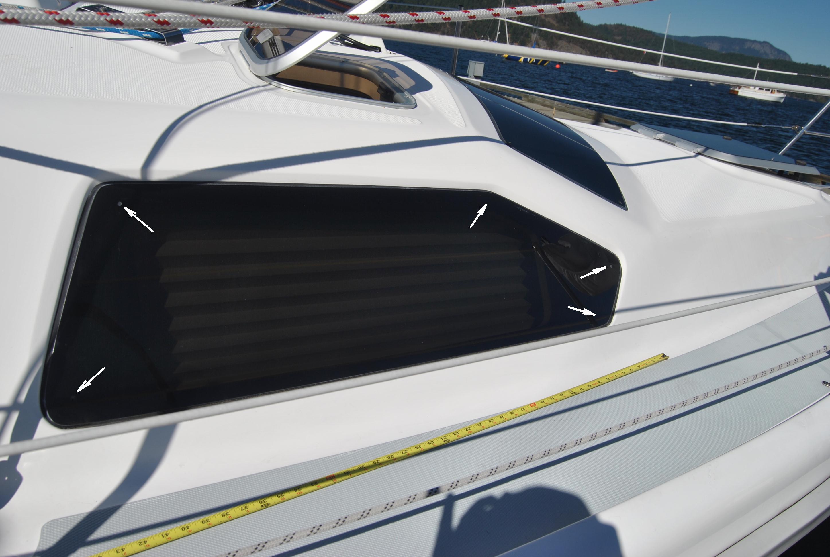

+1 on the 3M VHB adhesive tape... This is what I used when replacing my portlight windows with Lexan,... I used silicone adhesive after installing along the edges for waterproofing... I pressed the Lexan against VHB with a wooden roller but protecting the Lexan with painters tape to avoid scratches... did this last year and results are still looking as good as when I installed them. The VHB tape and 1/4 inch Lexan did the slight curvature of the side deck just fine, no issues. I have photos and will dig them up. Here is the video I used when figuring how to use the 3M VHB tape.

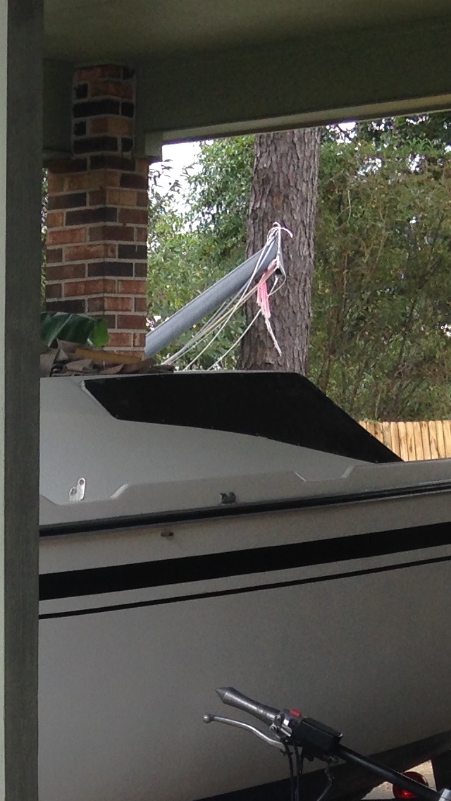

Armyaviation - did you reset your windows yet? My brother just got an American 21 and I think they are through-bolted rather than riveted - possibly replaced by Previous Owner (PO)? Will check on this in the next couple days - maybe get some pics of the rudder set-up eventually,but he has some repair work to do on it.

I did one side using exterior silicon that was black color. It was thick so I applied around window, after masking, and applied even pressure. As it set I could see through the window the silicon spreading out. I used two pegs to hold window up in location. I did not want to reuse rivets because it's another place to leak. Worked great
