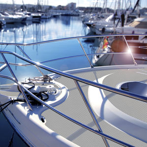

What if you went with a combonation of this stuff
and gel-coat repair.
You would only place the mats where you presently have anti-skid surface...
Like this...
This would drastically reduce the amount of chips you have to repair.
