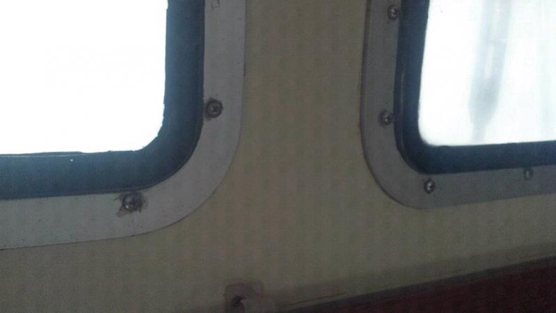

These are fixed portlights, not opening.
The aluminum frames are a 2 piece clamp, basically a trim ring clamped to the cabin side. The windows are glued to the inside of the aluminum frame. There are no screw fasteners touching the glass. There is only some type of adhesive caulk between the glass & the alum frame.
What I'm looking for, and can't find, is some guidance on how to neatly glue the windows to the aluminum trim

As pictured and described, the windows are adhered to the inside of aluminum frames.
