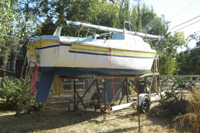

I just picked up a "Coronado 23" (Hull #045) it's in good shape, a few cracks in the interior and cockpit as well as a leaky window. It's wiring works but is a bit of a jumble, I'd like to clean that up. The "Sea Monkey" has a horrible paint job; I've all ready started stripping and sanding many generations of paint schemes. The boat has a small "check" in the bottom of its cast iron keel. I'd like to rig it for single handing and add on a rig for the spinnaker it came with. The boat is sea worthy as is, but I'm going to work on it while it's on it's trailer until spring. Any advice or information on these boats and those jobs would be much appreciated as it's been difficult to find any information on these boats through the internet thus far. Thanks!

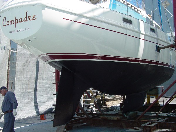

here's two pics of the "new" Columbia 30 that the Valdes family launched on the west coast at the LA boat show in 2006. Production was to be limited and not to be distributed nationally. Don't know the recent status...
PS. Here's pics of Doug Ward's Col 50 before restoration and afterward. Doug worked the produciion line in Cal and was one of those that built my Cor 27.
