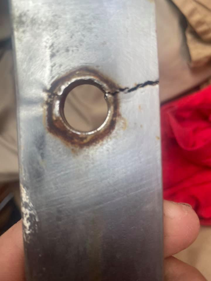

Hi all,
I’m looking for an assessment of this chainplate. It was for a backstay and looks like it broke from being case-hardened by previous work and tried to be fixed creating an even worse situation. Am I in agreement with most of you?

It can be welded and then ground flush and be stronger, but Cost versus New is the issue.

I'm with @JamesG161 - If you're doing the welding & grinding and already have the equipment, it's cheaper to DIY. I'm guessing if you were a machinist and had those things in your shop, you wouldn't be asking us what we think! If you hired it done, the honest machinist would probably offer to make you new out of stock to save you the cost. Just out of curiosity - what do you think would happen to your rig if this thing parted with the wind aft the beam?
The cracking is due to either stress cracking (from the welding) or is just a poor quality SS.
Have a good marine shop fabricate a new one, ideally from 316L, as there will be no post heat treatment and the heat affected area will likely stain badly.
DO NOT weld up the old one or the same problem will rear its ugly head again. Perhaps even worse with a larger heat affected area.

I would replace it, but keep the SS for some other job. I'm glad you identified it, as I wanted to check mine, but our backstay chain plates are about twice that big. A relief.

Thanks, I thought I was the only one thinking that this chainplate wasn’t worth salvaging. I’m surprised the sailor made it across to Bimini.

Replace them all. Not too long ago, I had an upper shroud chain plate fail while underway.:yikes: Had a machinist fabricate six new ones. Some time later the masthead plate snapped while underway but thankfully while going downwind. Again, had a new one fabricated. All out of 316 SS. Just by some quick maneuvering and a lot of luck did I not lose the whole rig. Do not put the boat and lives at risk to save a few boat bucks.
