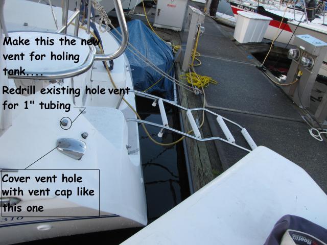

What company makes waste tank screened vent line fittings either thru deck or thru hull?

Not the type of thru-hull you want on a waste tank vent
Screens corrode and become clogged with with dust and pollen...they cause more problems than they solve. The odds that an insect will get into the vent line and block it are slim...but even if one does, it's a problem easily solved with a hose if you have an open bulkhead thru-hull instead of a "vent" thru-hull.
Screens in vent thru-hulls are only there because "vent" thru-hulls are "one size fits all--gas, diesel, water and waste...the screen is a spark arrestor when the thru-hull is used on a gas tank vent...it's not needed in waste tank vents.
A bunch of the thru-hulls shown on this page have screens, some even removable: http://www.thefind.com/query.php?query=vent+thru+hulls But I wouldn't use a single one of 'em on a waste tank vent 'cuz none of 'em allow enough exchange of air to keep the tank aerobic. . What you want is on this page: http://www.defender.com/productsearchresult.jsp #2 or 6 or 9...

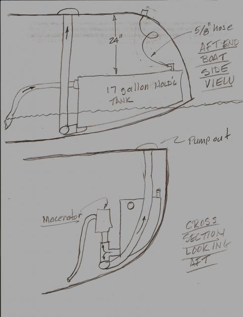

Suggestions: mount the macerator lower than the tank bottom; rotate 90 degrees to starboard so it always has a flooded suction. Put a full port PVC ball valve between the tank and the tee on the bottom so you can change/work on the macerator pump when it fails.

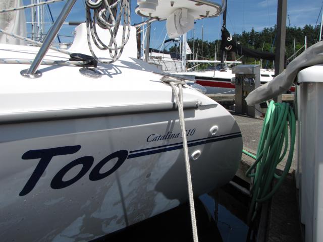

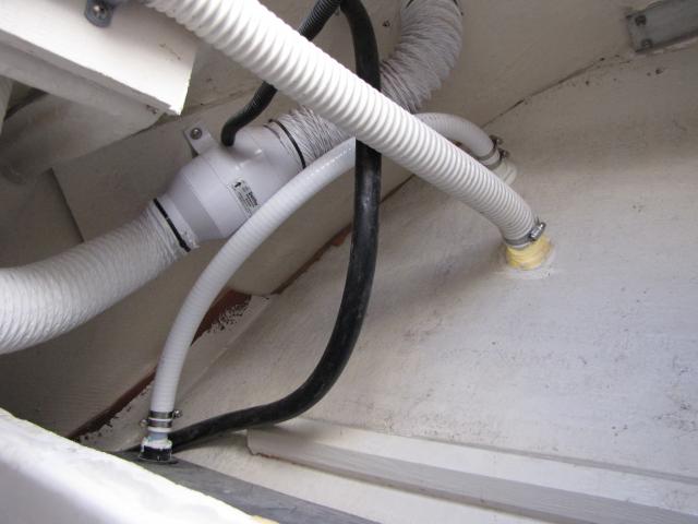

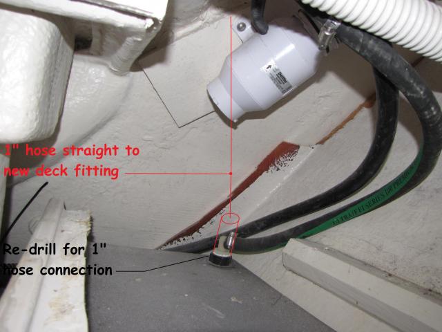

I just bought a 2001 Catalina 310 and want to improve the holding tank venting. Thanks so much for posting your designs and especially the pics of the completed fix. A couple of quick questions:
1. Does your new vent line work well / are you happy with it?
2. You and Peggie had an offline conversation about your original design where you were sticking with the original position of the through-hull. What was wrong with that approach - too long - too vertical?
3. Anything tricky about putting in the new-through hull? How about the new fitting on the holding tank?
