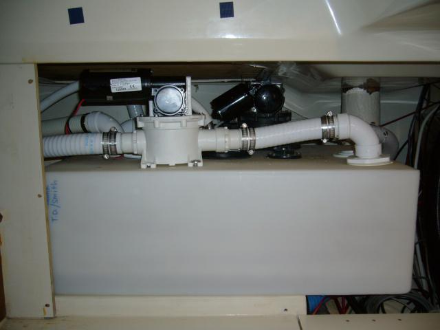

When I ordered my tank, I specifically did not have them place any fittings. That way I was able to place the tank and then decide where I wanted to run the lines to the tank. I liked the sealand fitting because it allowed me to drill the holes and then install. Worked out pretty well. Was almost finished here. Just a few more clamps, strap it down and....
