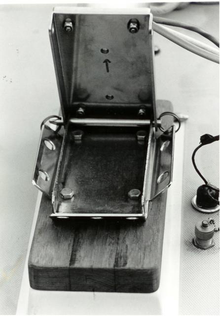

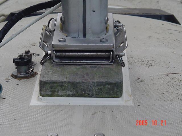

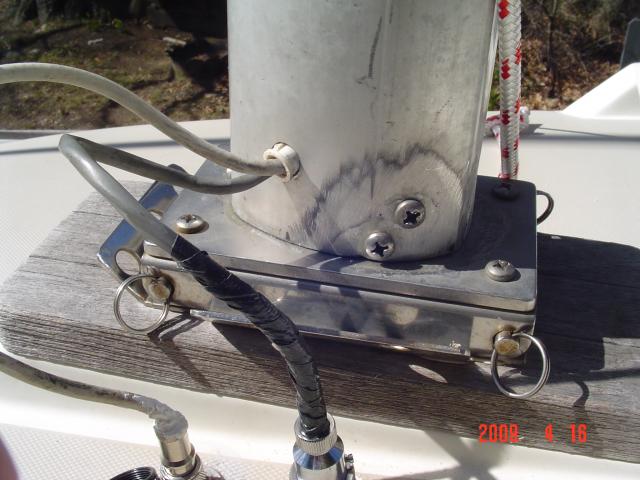

I believe that it's called a Mast Tabernacle Utility Plate. My plate and Tabernacle were made by Kenyon, but Dwyer also manufactures them. My utility plate originally had a tab on all four sides. I cut the back tab off my plate because it interfered with raising my mast mast from the lowest position of my mast holding crutch on my stern rail. I usually Mickey Mouse some kind of an attachment for my boom vang by using a rope connected to the outside plate holes. It really isn't such a big deal.Does anybody know the name of the fitting that attach's to the bottom of the mast of the Oday 25 and the boom vang attach's to it? Does anybody have a picture of one?
