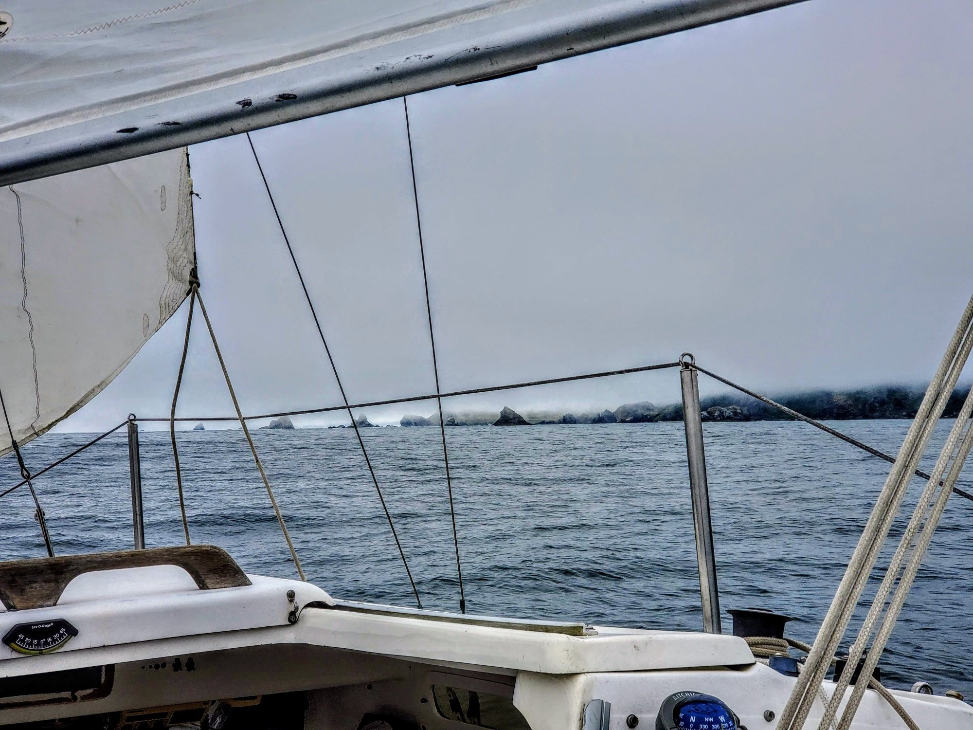

Here are some pics. My buddy was at the beach and managed to take a pic through his binoculars with his phone zoomed in!
