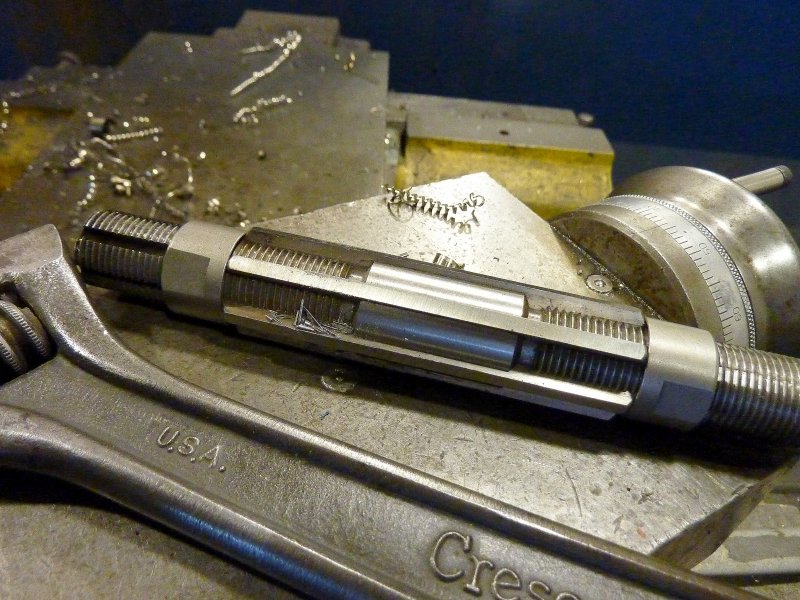

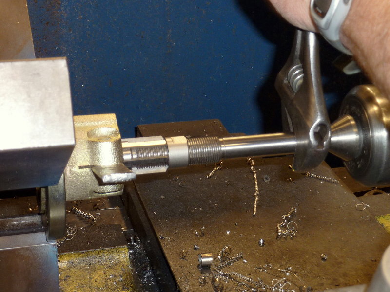

Fitting is often done by hand with the aid of a machine shop lathe to hold the coupling. The reaming tool for this is very precise and they are quite expensive. It is used for the rough fitting. The coupling is most often inserted into the head of the lathe and the reaming tool end centered so the reamer goes in perfectly straight. The machinist makes a couple of turns of the reamer with a wrench and then removes the coupling and test fits it. This rough fit can usually be done in two or three tries. This one took three fittings. Care is taken to not to go to big because you can never make the hole smaller. Multiple fittings is usually the reality. This one took about 12-15 minutes to fit to the shaft.
Because this was a split coupling it was shimmed square to maintain the "fit" all the way through. The shimming was measured as accurately as possible before hand reaming.
The reamer is then adjusted by hand and inserted & centered into the coupling. It is then turned by hand with a wrench. After a couple of turns it is removed and the fit is checked. If not good this is repeated.

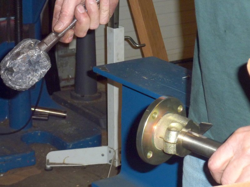

A good final fitting requires a lead mallet to tap the coupling onto the shaft.
Once it is fitted the coupling is installed on the shaft, with key or without, does not really matter, and with the set screws in place and is then ready for facing.

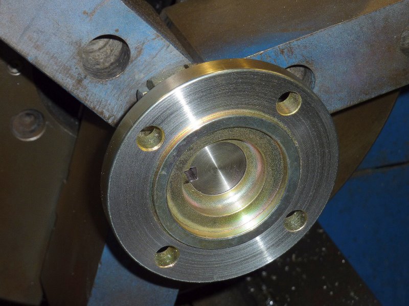

Facing: This makes the flange face rotate perfectly square to the shaft with no wobble.
Facing is rather easy compared to fitting and the video can be seen above. If you listen carefully you can hear the woo, wooo, wo as it is ground. The noise is not smooth because the cutting head was taking more in some areas and less in others due to wobble in the flange face.
Shaft flanges are aligned to roughly .001" for every inch of coupling diameter. Thus, a 4" coupling should be aligned to somewhere between .003" & .004". If the face is out .001" - .003" because it was not faced this can get inaccurate and a become a bear to align.
Gear box flanges are faced at the factory to spin true. Provided you have not bent it through pounding on it, or using it to press off a coupling, it should be darn close to rotating true. Unless your coupling is like new, with no rust between it and the shaft, I don't advise pressing the coupling off the shaft with it. Some gear boxes, like the small Hurth's (HBW-50 etc.), have very flimsy output shafts and they can easily fracture or be bent. It doe not take much to achieve a .003" or greater bend in a gear box coupling.

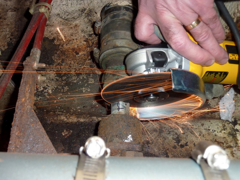

Often times with old shafts the easiest way to remove the coupling is to cut the shaft. This 1987 shaft had bad cutlass wear as well as bad stuffing box wear, and the coupling was not coming off in the boat any other way due to very limited access. A new shaft & coupling is far less costly than ruining your gear box!!
