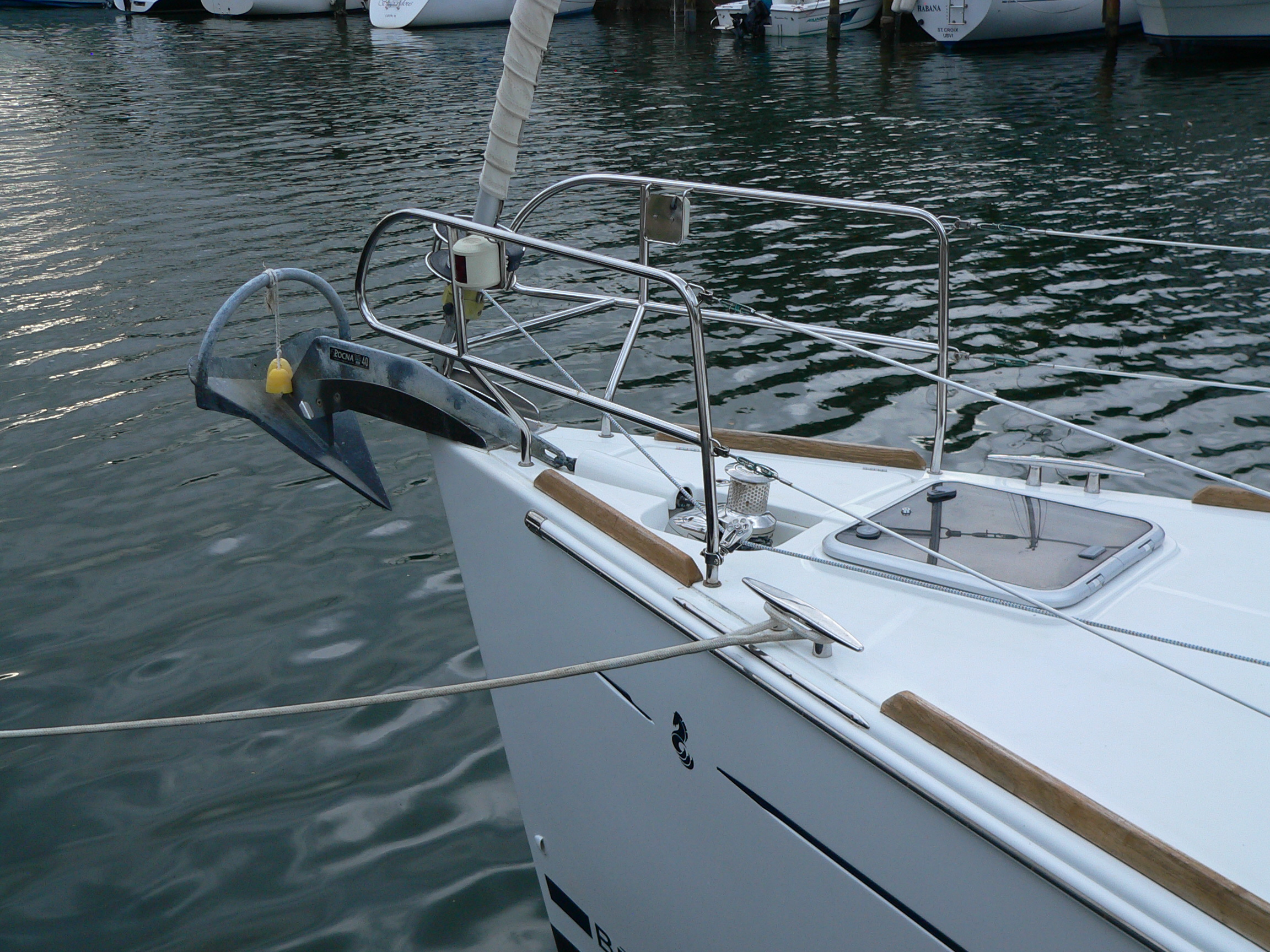

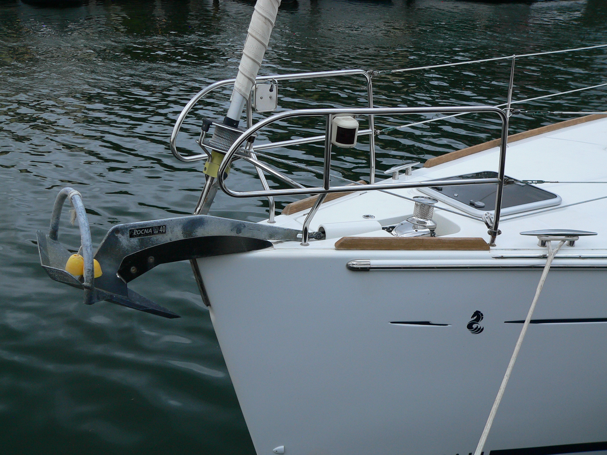

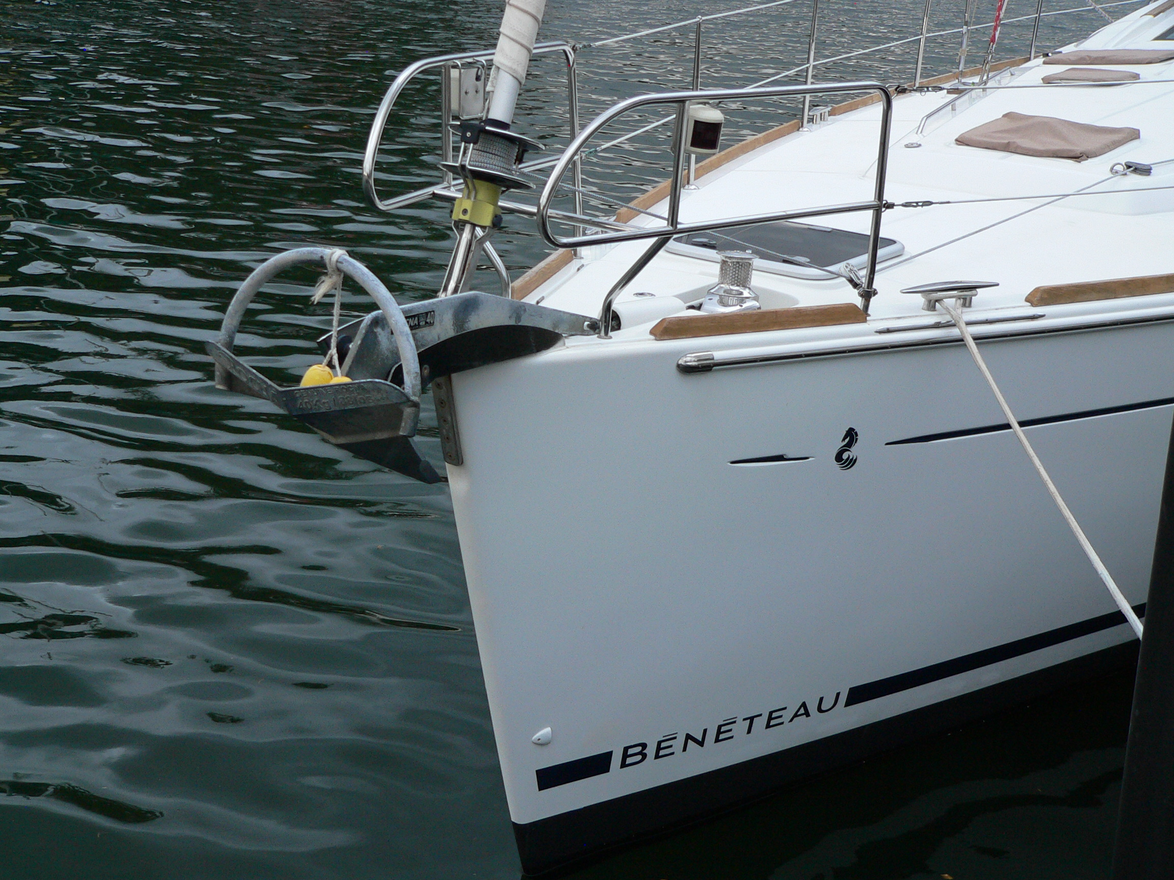

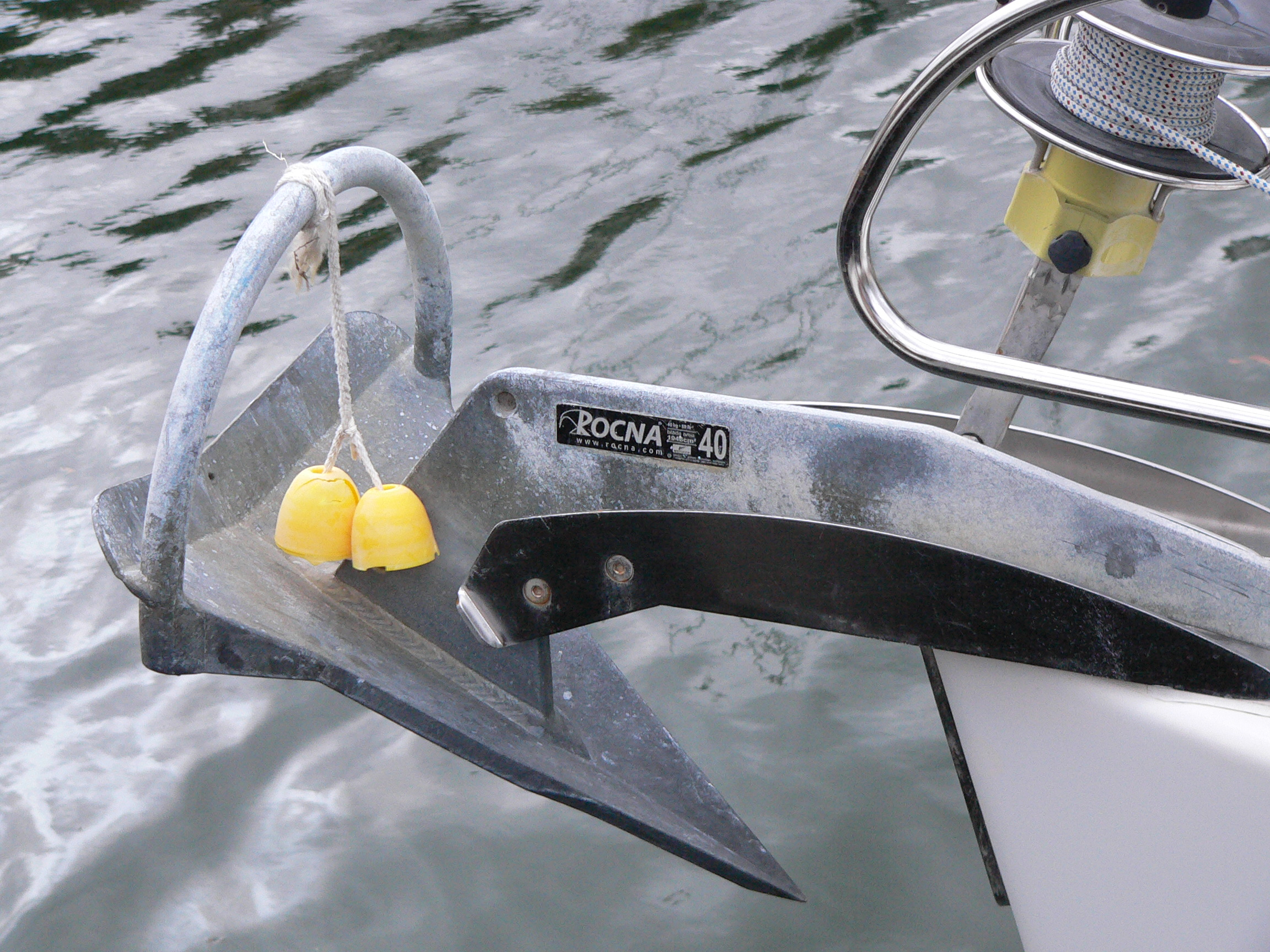

We have a B49 so not the same as the boats you are asking about but for what they are worth, here are a couple of pictures of our Rocna on Second Star:

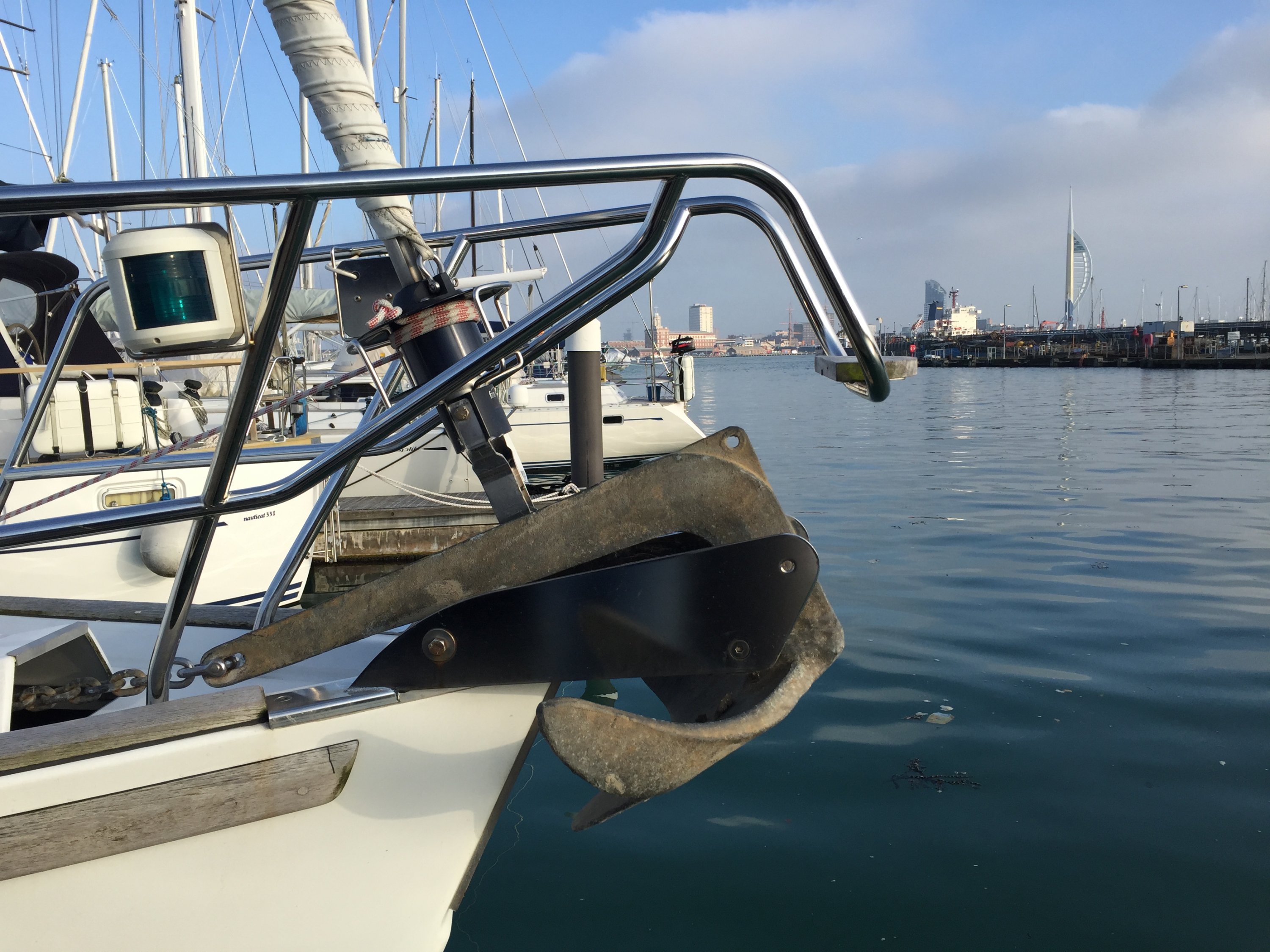

Thanks for your comments. I will follow up with the guys at Mantus and Rocna. Just FYI this is a picture of my boat - you can see the issue ! Gunni - how does that compare with your B411 ?

Pretty similar to my bow roller, and it looks like you have your anchor cinched up tight enough to bring the shank up off the roller. I bring my anchor in until the curve in the shank meets the roller, and lock down the chain with a chain hook. Works well. Deploying your anchor you will feed out the rode with tension so the shank does not rise up as it goes out over the roller. So you should have no problem. Sorry, I don't have a photo to share.
