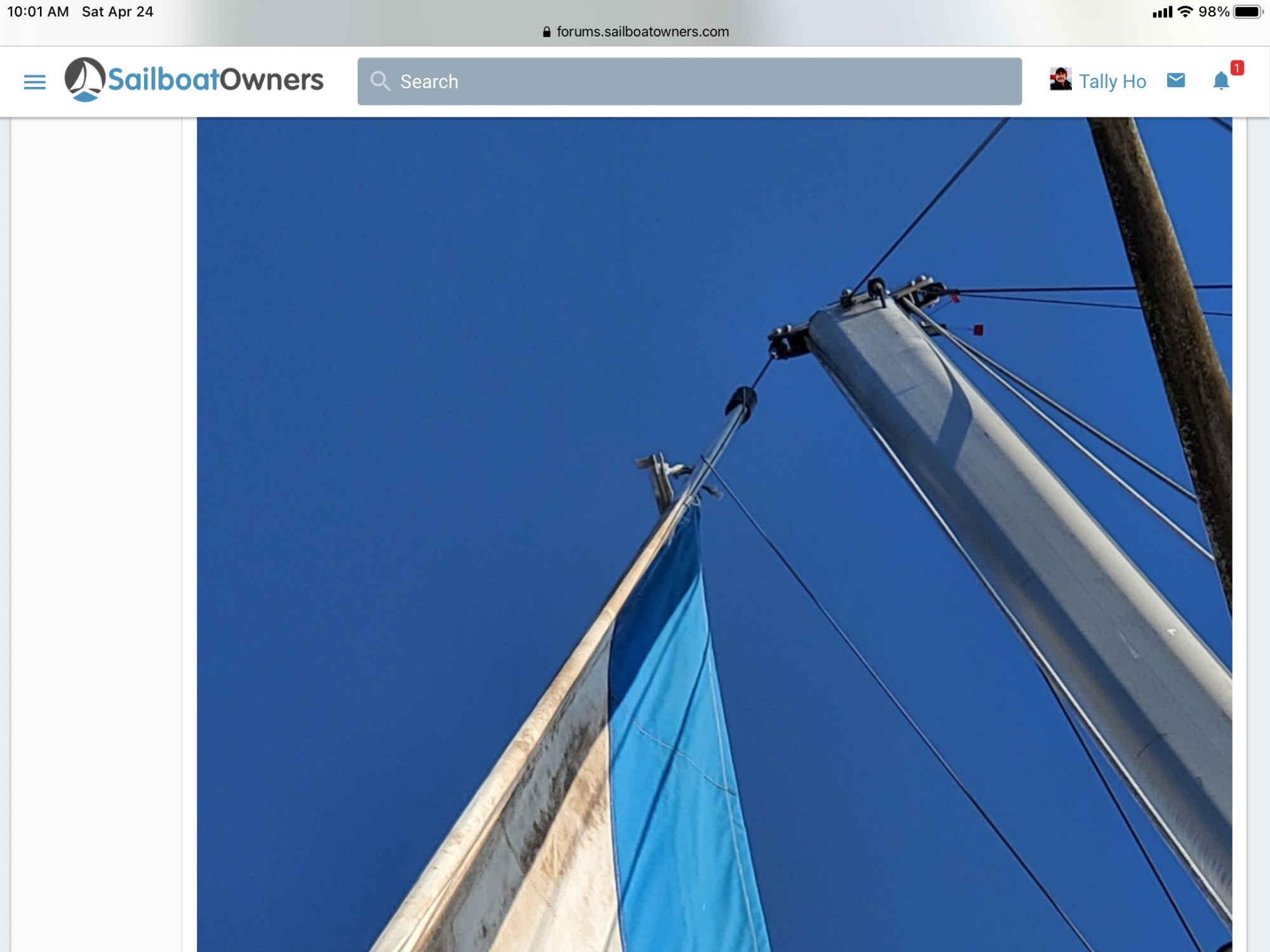

It looks like you have a line that is stopping the sail from going up the Furler. Most sails I have seen slip up the furler in the groove. Your sail looks like it is wrapped around the furler.

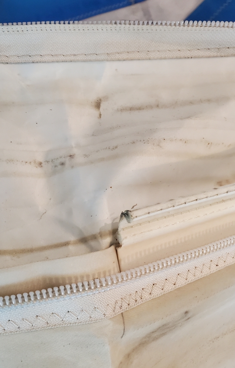

My old sail was just a simple #6 luff tape all the way. This one isn't what I expected. It has a zipper. The luff tape starts about 5ft from the top tip and the rest you zip up. Not sure how I feel about that.
It's not wrapped around the furling. Just encased as a pocket. Photo below.
But I think you're right. I just zoomed in on a mast photo and it looks like I have a little more room. Hard to see on a sunny day..
But I don't think it will be enough.

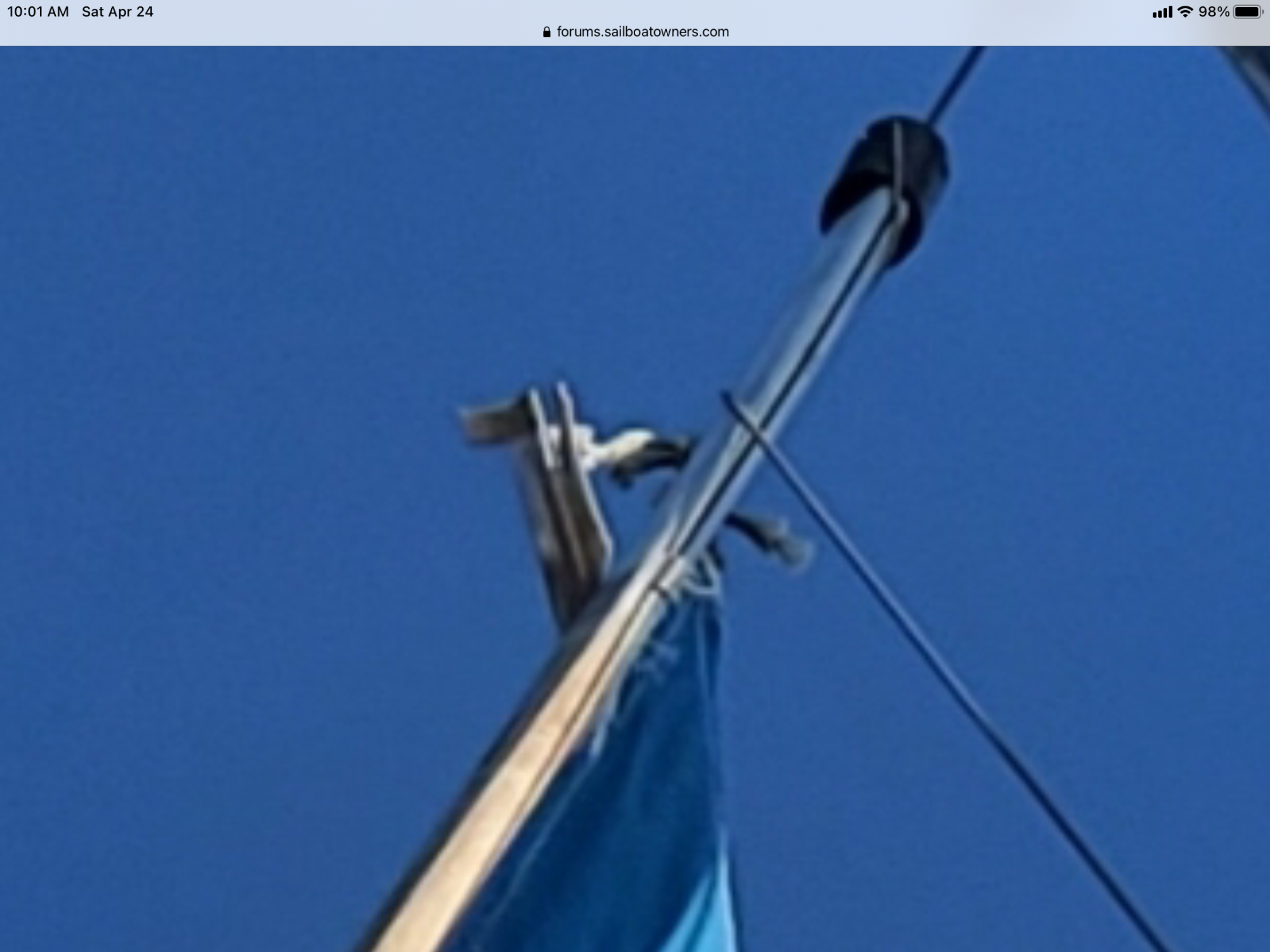

Second, the internal wire halyard is wrapped around the extrusion, at the top. That’s what is keeping you from
raising all the way. Next time you raise the sail, make sure that there’s no wrap when you start. It’s an easy mistake to make. I’ve done it myself.
And I think the amount of room you have at the top of the extrusion is quite a bit less than the amount of sail you have left to raise. One solution would be to modify the sail to fit.

As someone else mentioned, your wire halyard is wrapped around the extrusion near the top. It cannot pull the sail all the way up.
You need to unwrap that halyard to get the sail all the way up.

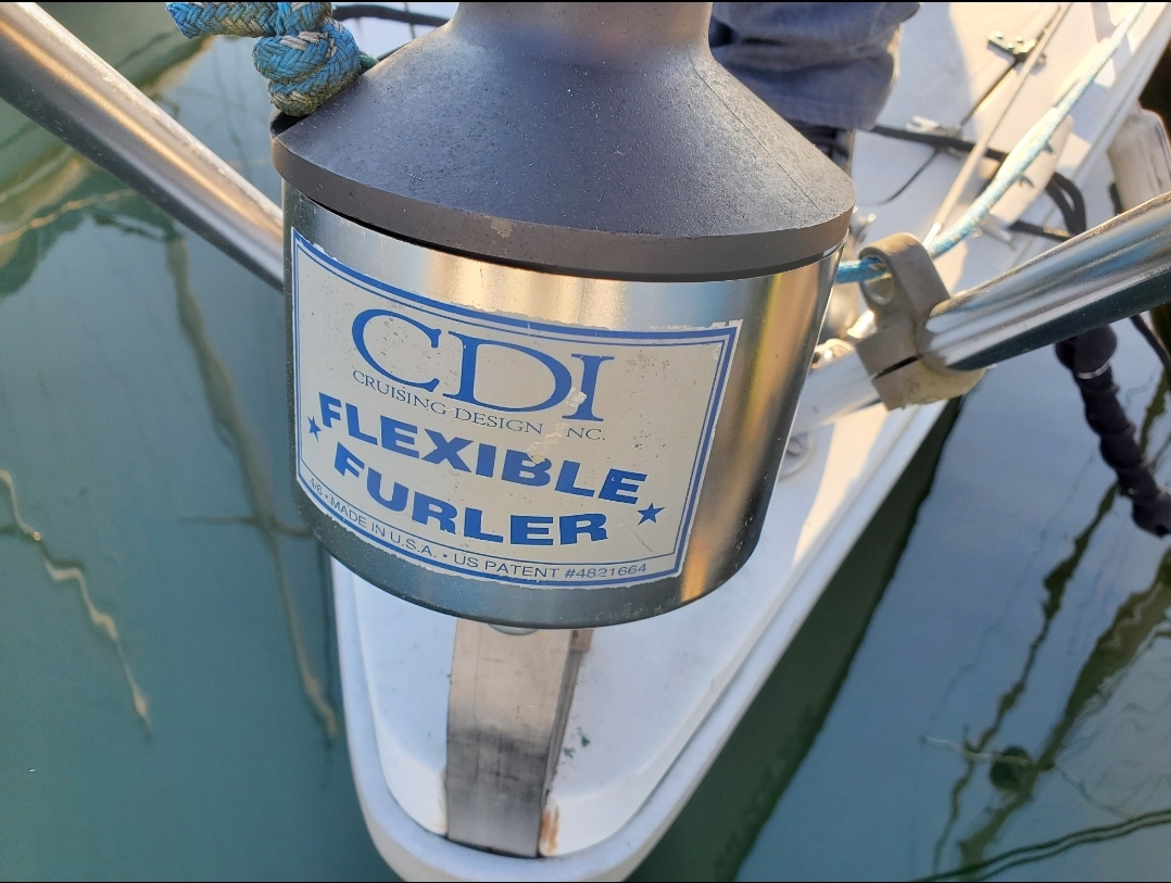

Look also at the direction your furling line is wrapped around the drum. The way the fairlead is set up on the bow pulpit leads me to think the furling line should coil in the opposite direction so that the sacrificial UV protection ends up on the outside when the jib is furled. That lead angle from the bow pulpit to the furler the way it is set creates a turn that will cause some added friction.

I do believe the line is wound on the furling drum the wrong way. I took my line off over the winter, and replaced it this spring...and wound it backwards the first time. Realized it when the UV strip wasn’t where it is supposed to be.
what is this at the top pf the sail? It doesn’t look right...
