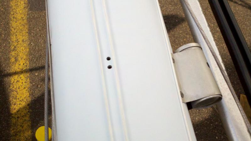

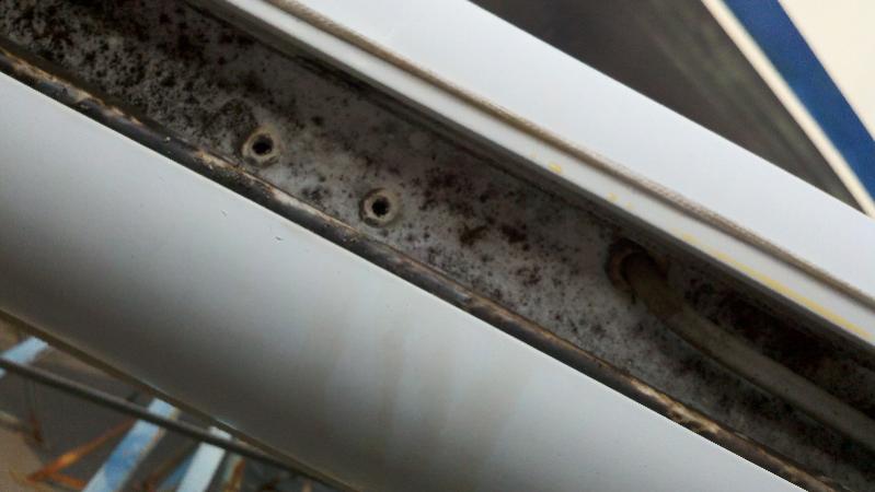

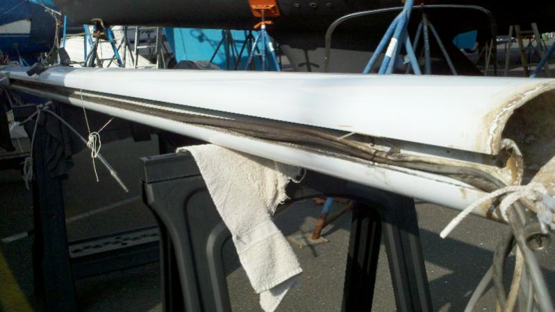

Pics of wire pocket behind track when removed for your use.
The next one is looking up through the mast.
Good luck.
Jun 2, 2004
5,802
Those are great pictures Neal. Wish I had taken those so many years ago when I rewired my mast. My track is full so I would never be able to do what Blaise described, pull a wire through that track with the cover on. With just the original wire in there it might be doable. But Blaise has a lot more patience than I do.

Glad to help: I took those three years ago when I rewired my mast. However since that channel goes all the way to the bilge it is a constant source of rain water in the bilge.
I don't know how with more than a couple wires in there how you can wire from the top.
Interesting item was that since the steaming light is on the opposite side of the mast there were two holes in the side of the mast where you can insert a zip tie (with a lot of patience) to hold the wire out of the center so it wouldn't conflict with the halyards.
