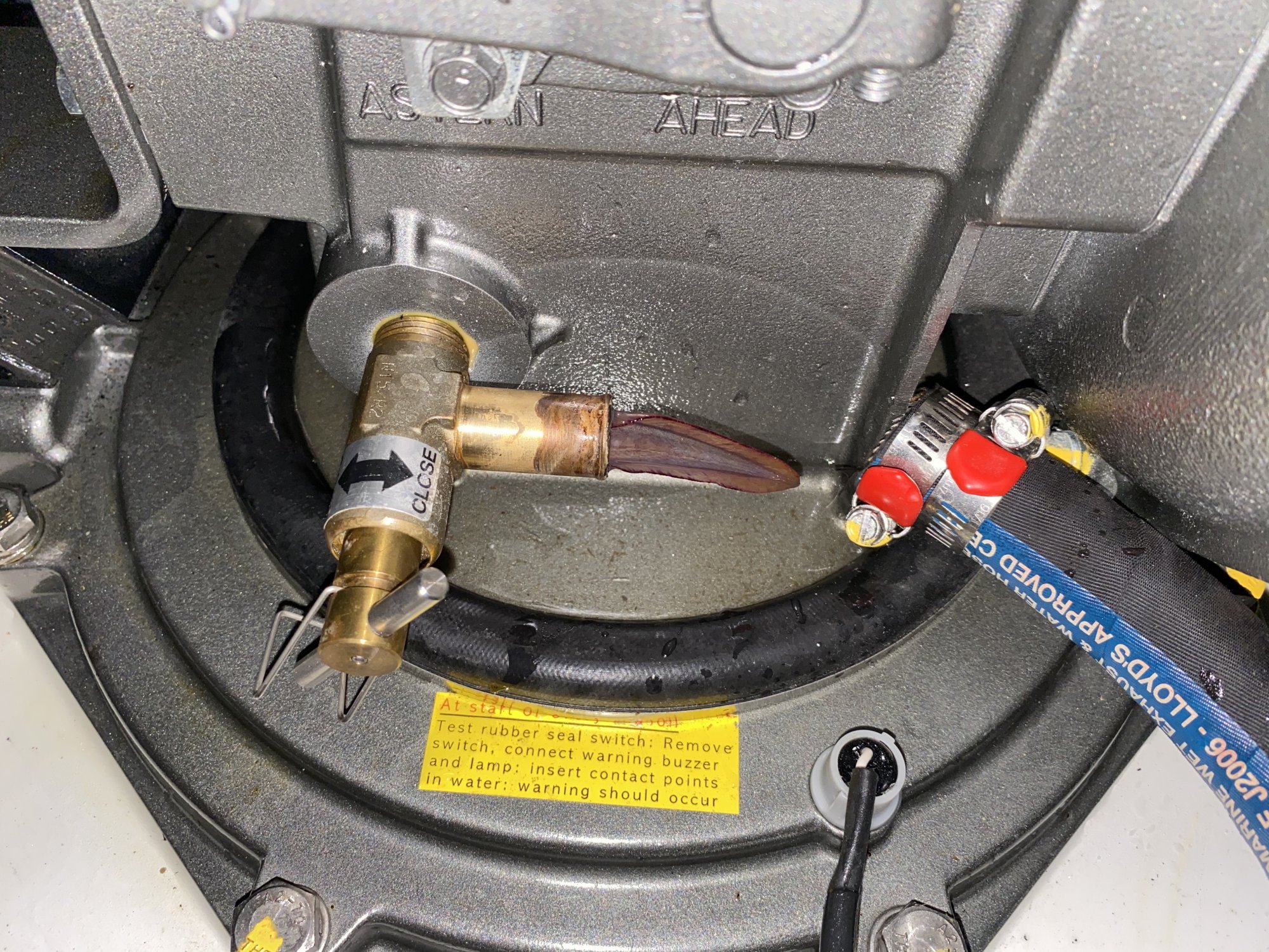

After two hours which included replacing the impeller, I found the problem. A small eel, or similar fish, was sucked up into the raw water intake on the sail drive. I removed the 2" of fish in the pipe shown below. Opening the seacock no water flowed in. I reattached the hose, disconnected the end at the strainer and blew into the hose. I could hear air bubbling around the hull, so I could get air out though the intake. But, hooking everything up showed no water flowing. It appears the rest of fish just gets sucked back into the intake when motor starts spinning the impeller.

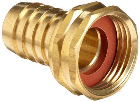

Get a garden hose connector with a female end on one and a barb end on the other that will fit into the hose that goes to your saildrive.
Put 1 or 2 hose clamps on and connect your dock hose to the garden hose connector and turn on the shore water full bore for a few minutes. Sixty+ psi will clear out pretty much anything include any crustaceans that may be there. With the water still on full, I will open and close the saildrive thru hull a few times just to give it that little extra blast.

Thanks to all. I got the dock fresh water hose and a hose adapter to get everything out. Took a couple of hours. The downside is a connector in the exhuast system melted, so that must be replaced before any sailing.
Good to hear I'm not the only one that has this experience!

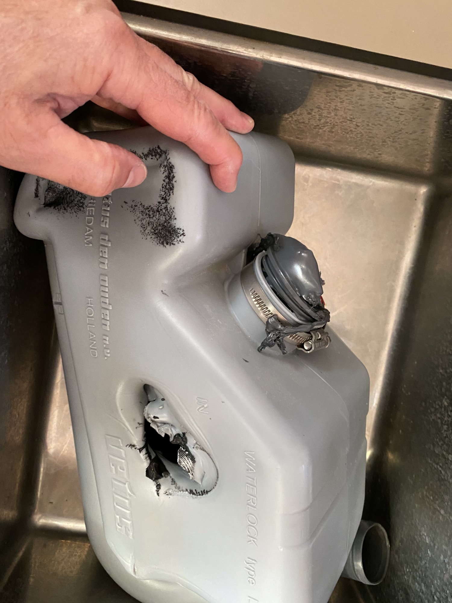

Just to complete the story: Below is a picture of the waterlock muffler after being replaced. I could see the connector had melted, but I didn't see the damage to the side of the muffler until it was removed. I guess if any part of the muffler is melted, the whole thing needs to be replaced.
