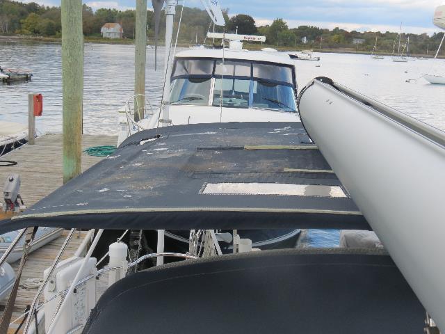

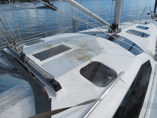

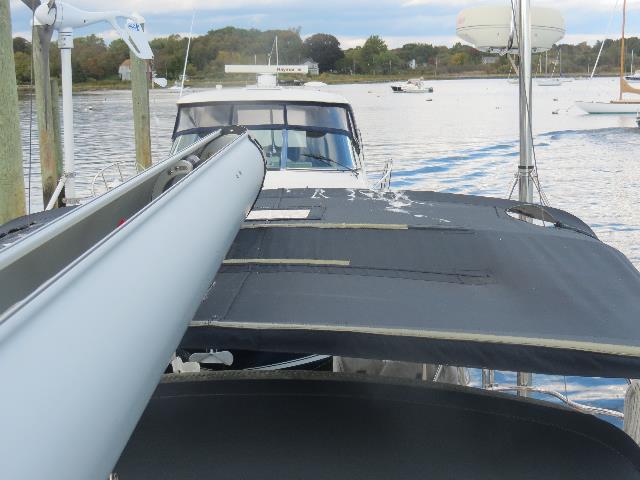

This has been a perfectly horrid year for bird damage to our boats here in Bristol, RI. Something has happened to the eco-system, and now the gulls are catching foot-long fish, dropping them on the deck and bimini's and eating them. The result is many fish carcasses, lots of blood, and of course the resulting eliminations of the birds. Since this mess is not found until days later, the stains are set quite well.
So now at the end of the season I am trying to do a final clean-up. Can anyone recommend products that actually work on fiberglass and Sunbrella? I can read the ads and claims, and I believe that most products are over-hyped. I need personal recommendations that work.
I am planning on using a power washer very gently in a week upon my return to the boat for winter covering. Meanwhile I have my canvas at home and want to clean it. Check the pictures-

I have a partial answer to the removal of the blood and fish guts. On the deck I used full strength Purple cleaner that I bought at Home Depot. Sprayed it on, waited 10 minutes or so, and then used an electric power washer with a fan tip to power off the stuff. The electric washer is only 1800 psi and I used it with about a 1.25 inch fan at 6-7 inches off the deck. In other words I didn't blast it with the full concentrated power. This process removed all of the guts and only a few stains were left. I'm not even sure if the remaining stains were from the fish; they may have been a spot of oil or grease from another source. I plan on using On and Off next Spring on the remaining spots.

An update on the blood and guts removal from the Sunbrella-
On the Sunbrella website is a chart of stains and recommended cleaners for removal. I was surprised to see "Blood (Dried)" in the list! The recommendation was to use a mix of Dawn and ammonia in water. I didn't have Dawn available so I used Ajax dish liquid instead. I wet the canvas with full hot water (air temp was 40-50 degrees outside) and scrubbed the canvas with a scrub brush and the hot mix..... twice. I was able to remove all of the solids of the blood and guts, but I still have a number of dark stains.
Since it is getting colder up here in the northeast, I have decided to wait until Spring to continue with additional cleaning. I can certainly get some Dawn, but I question if it will make a difference. I may just have to live with the stains. They are on the top and not readily visible, so the situation could be worse.
Perhaps you CSI enthusiasts have a blood stain removal suggestion?
