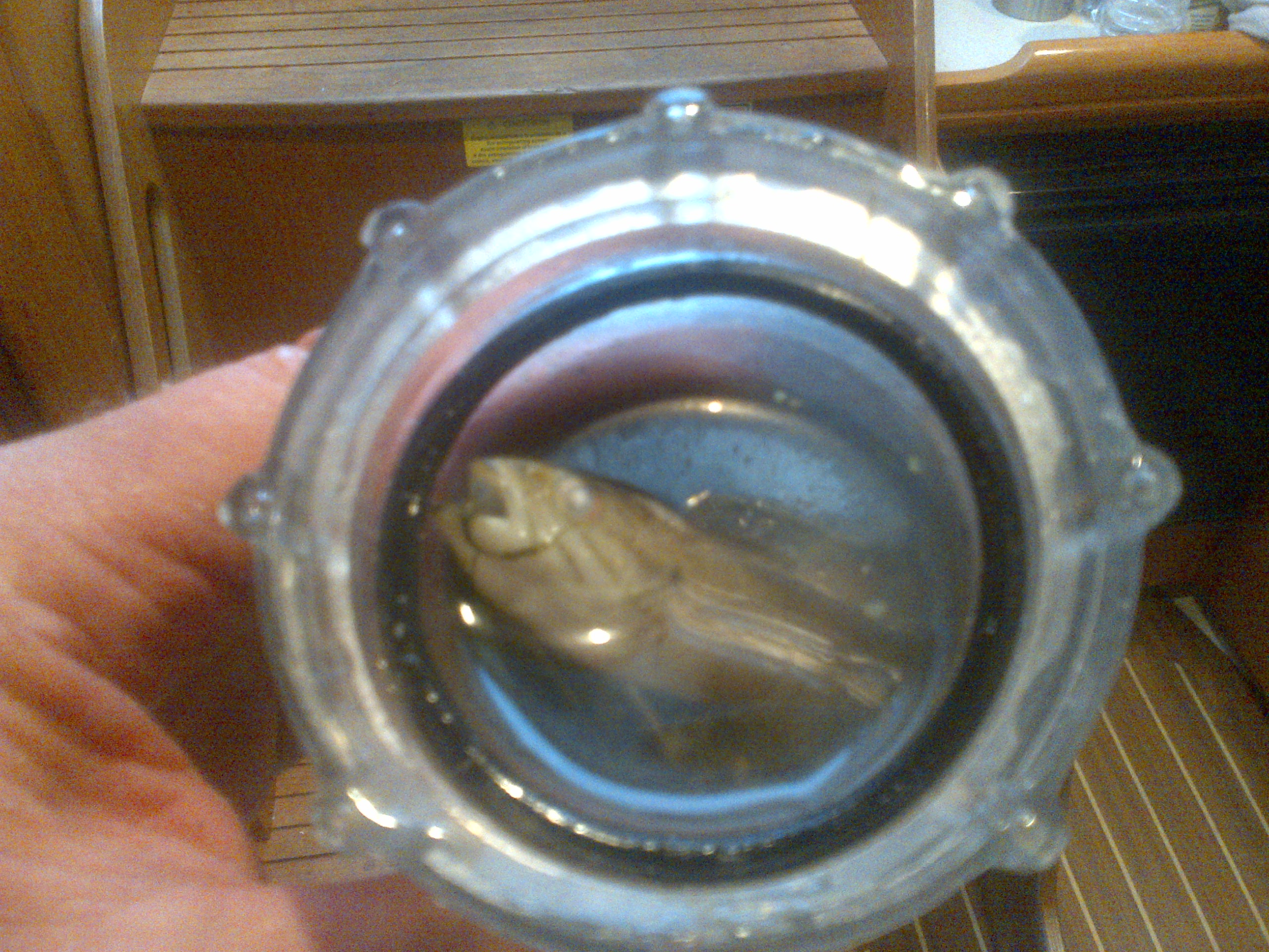

Sharing an unanticipated sailing adventure, or perhaps they are all like that. I was moving my Pearson 33 on Chesapeake Bay this weekend and arrived early to get organized. Since it was a cold morning, I started the engine to warm up, of course checking the exhaust for cooling water. As I was about to leave, fortunately checked the exhaust again and saw no water coming out. There was a bit of seaweed in the raw water strainer but nothing that would create a blockage. But I could feel what felt like a complete blockage by something rubbery where the raw water came into the strainer. To make a long story short, after multiple efforts to clear the obstruction without success, had to take apart the hose and strainer to figure out what it was. It was a small fish that had been sucked into the water intake and lodged just in front of the strainer where it was totally blocking the intake. After removing the fish, everything back to normal and an uneventful trip, albeit several hours later than planned.

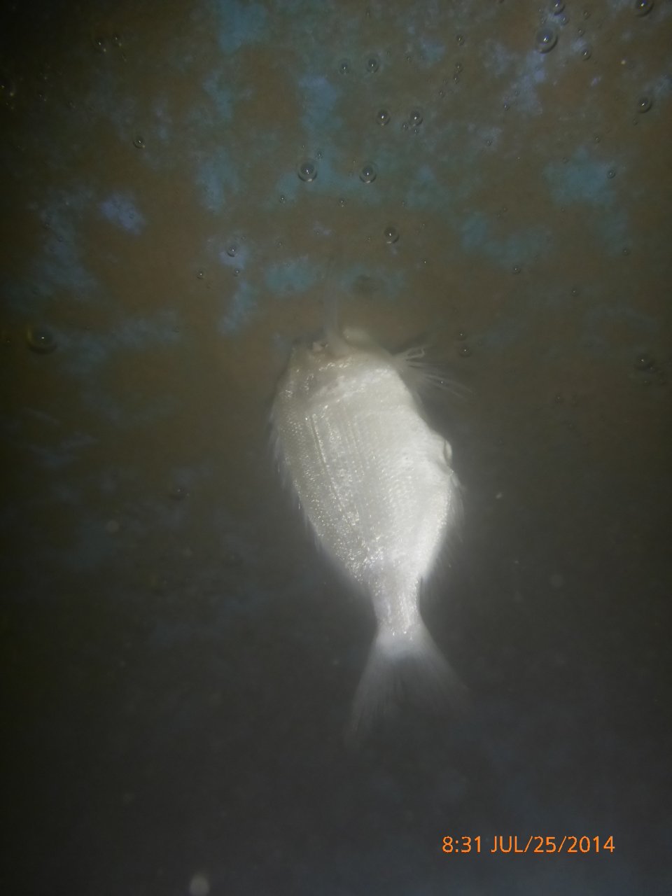

Not all fish make it into the hose. I was getting ready to clean a hull and I always take pictures of the hull beforehand so that the owners know how well their paint is holding up. I told the owner of this boat to cancel her A/C service call.
Yep, he's stuck up in there.

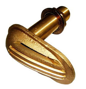

Most quality boat manufacturers use seawater intake strainers, or thruhulls with intake strainers. The only place we get the lil fishies is the head intake, because both the engine and generator have seacocks with strainers. Something to think about on your next haulout.
