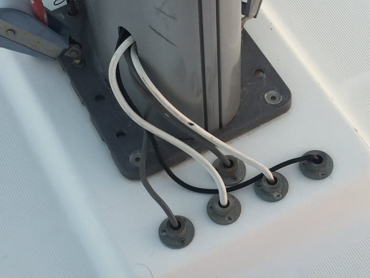

Yes, thanks! I believe there are 5 wires.........Here's a picture of the deck, however I have not explored the headliner area or the compression post areas for junction boxes yet.

It depends on who did the original wiring. I could not pass the PL259 VHF connector through and had to cut it off. Beneteau used the Euro style terminal blocks. I bought a set of numbers used to identify wires. They are probably already marked with numbers. The numbers should correlate to your manual and the Waco connections behind the distribution panel. They did some funky things jumping the grounds. It's not that bad, good luck.

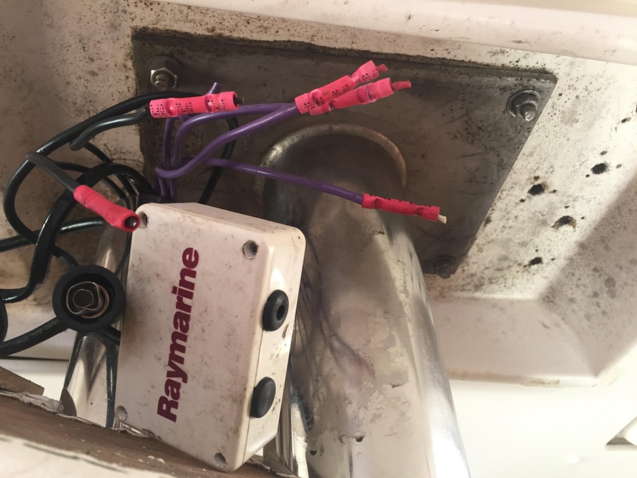

Turns out all my mast wiring was behind the access panel in the headliner, near the top of the compression post. Other than the VHF PL257 plug, the tv antenna plug, and the ST60 wind instrument Raymarine connection box, all other wires were crimped butt connectors.

So you have to cut all of them to unstep the mast?? This might be the time to install a terminal strip and add wire terminals. It looks like they used the same color wire for all circuits. Be sure to label everything.
