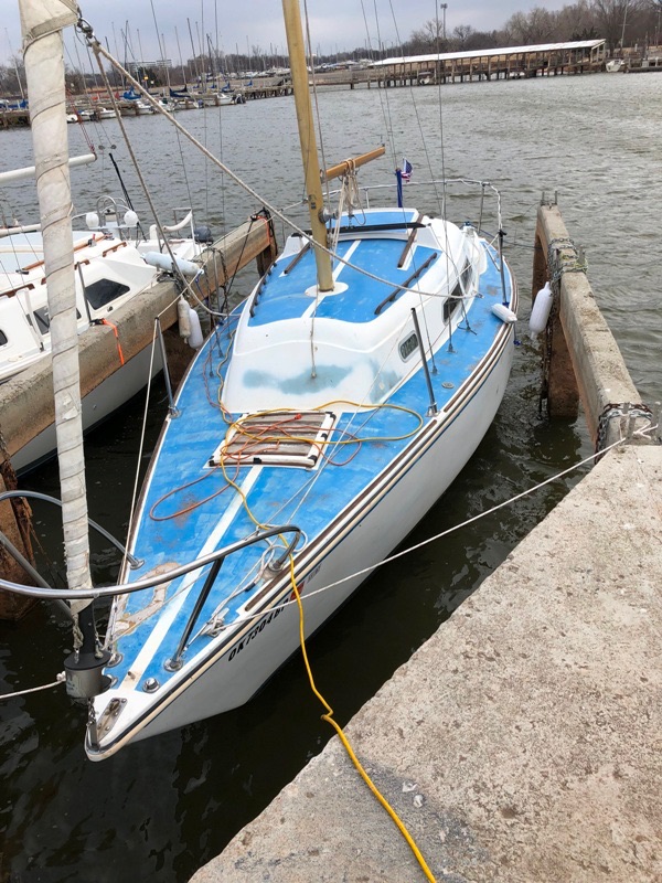

I’m going to start buying some paint to repaint the deck of my O’day 27. I’ve never painted a boat before so not sure what the average amount of paint I’d need. Anyone have any advise how many quarts I’d need to cover this? I’m going to use Pettit blue ice to cover the dark blue and then a white for where it should be white. I was thinking 3 quarts of the blue and 1 quart of the white? Another question is can I use topside paint for the deck?

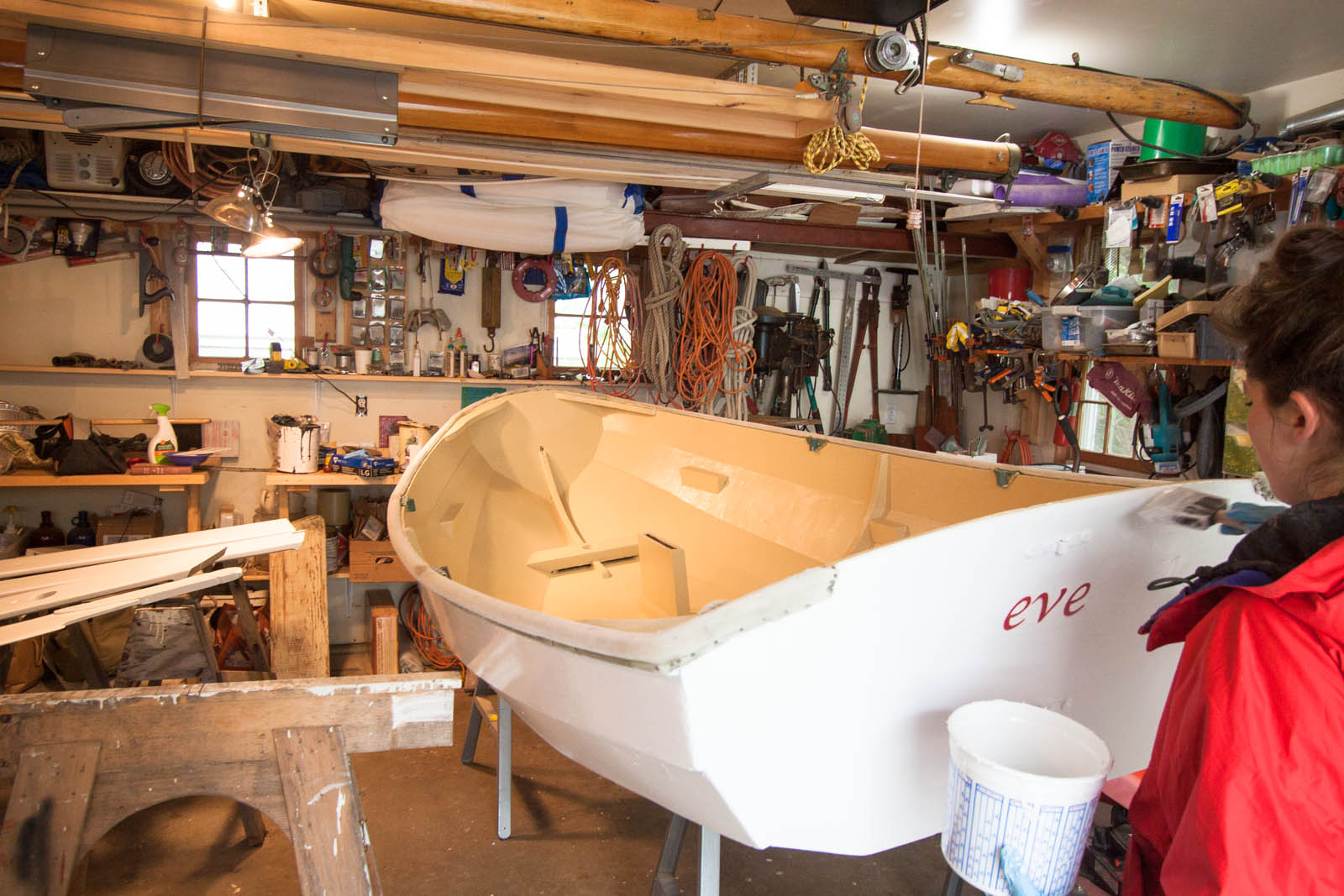

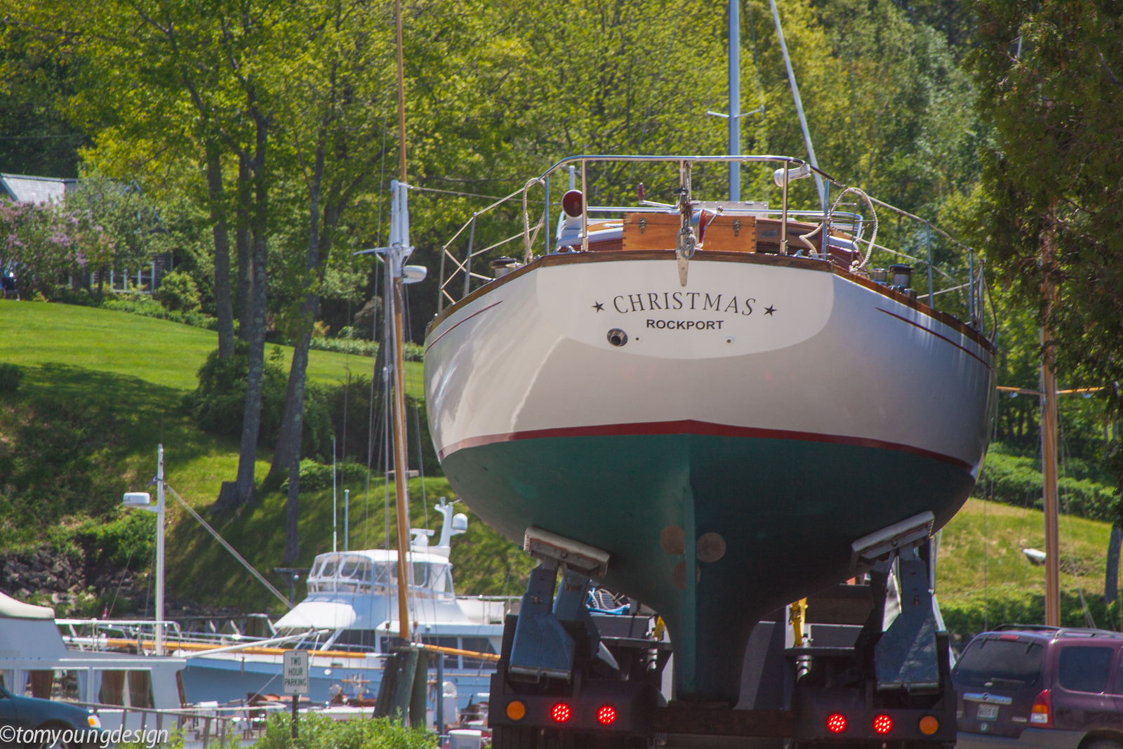

We paint the topsides of our 38' yawl every 4-5 years with 1 part enamel. I buy 2 quarts of Easypoxy or similar. That's enough to roll and tip the topsides with probably a cup left over.
This is one coat - rolled and tipped - over the lightly sanded (spot filled and primed), topsides.
Staging is key. Put your work where your hands are the most comfortable.
The actual painting, if you choose the right weather, can be pretty easy and fun work.

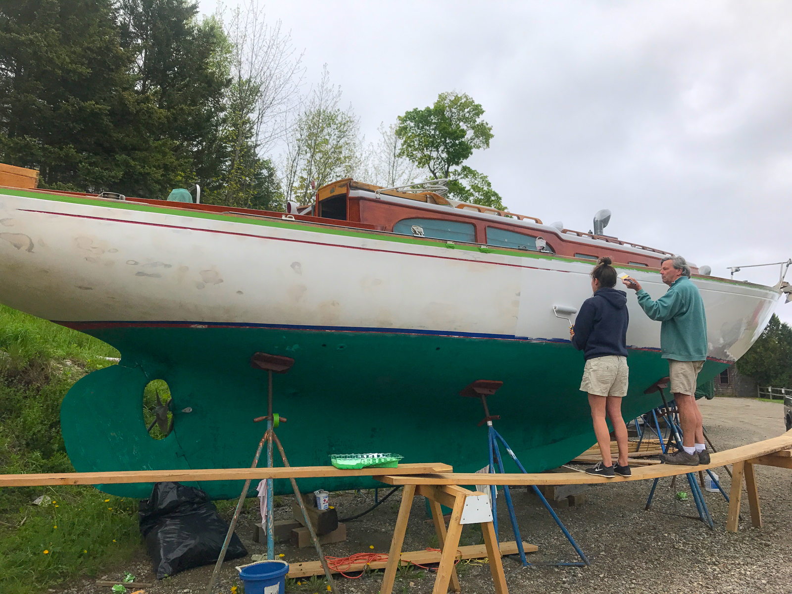

Not including prep (which can take forever - or a few hours, your call), my daughter rolled, while I followed along tipping, the hull in about 3 hours of easy work.
The left over cup, goes on the dinghy (which she, or my son usually paint for me).

Uh-oh. Wait a minute, looking at your photo, you may have said 'topsides', when you meant 'deck'.
In which case you may just need one quart depending upon what you apply and how.
'Topsides' is the area of the hull above the waterline, and below the decks.

Judging from your picture I think you are talking about painting the deck and cabin top. I would guess two quarts but non-skid has more surface area than flat sections. How are you going to handle non-skid? You would do better with two thin coats than one thick one. Use the correct thinners and solvents to clean the surface. You are going to put a lot of labor into this. Respect your time by not skimping on materials.

Thanks! I guess I figured top side meant the deck. So I’ll look for “deck paint” rather then “topside paint” correct?
I saw where people use sand over the wet paint. Is that correct to stop the slipping?

For the most part there are still groves in the deck paint. There are some smooth spots. But 90% or over still good. Would I still use the kiwi non skid paint but not lay it on as thick and use a normal roller? And then here’s another question. I’ll be doing this in the slip. How does a guy paint and then get off the boat after?

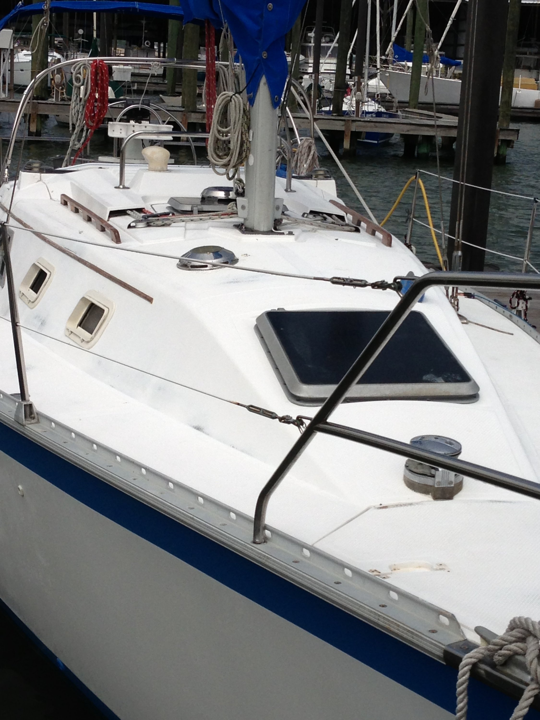

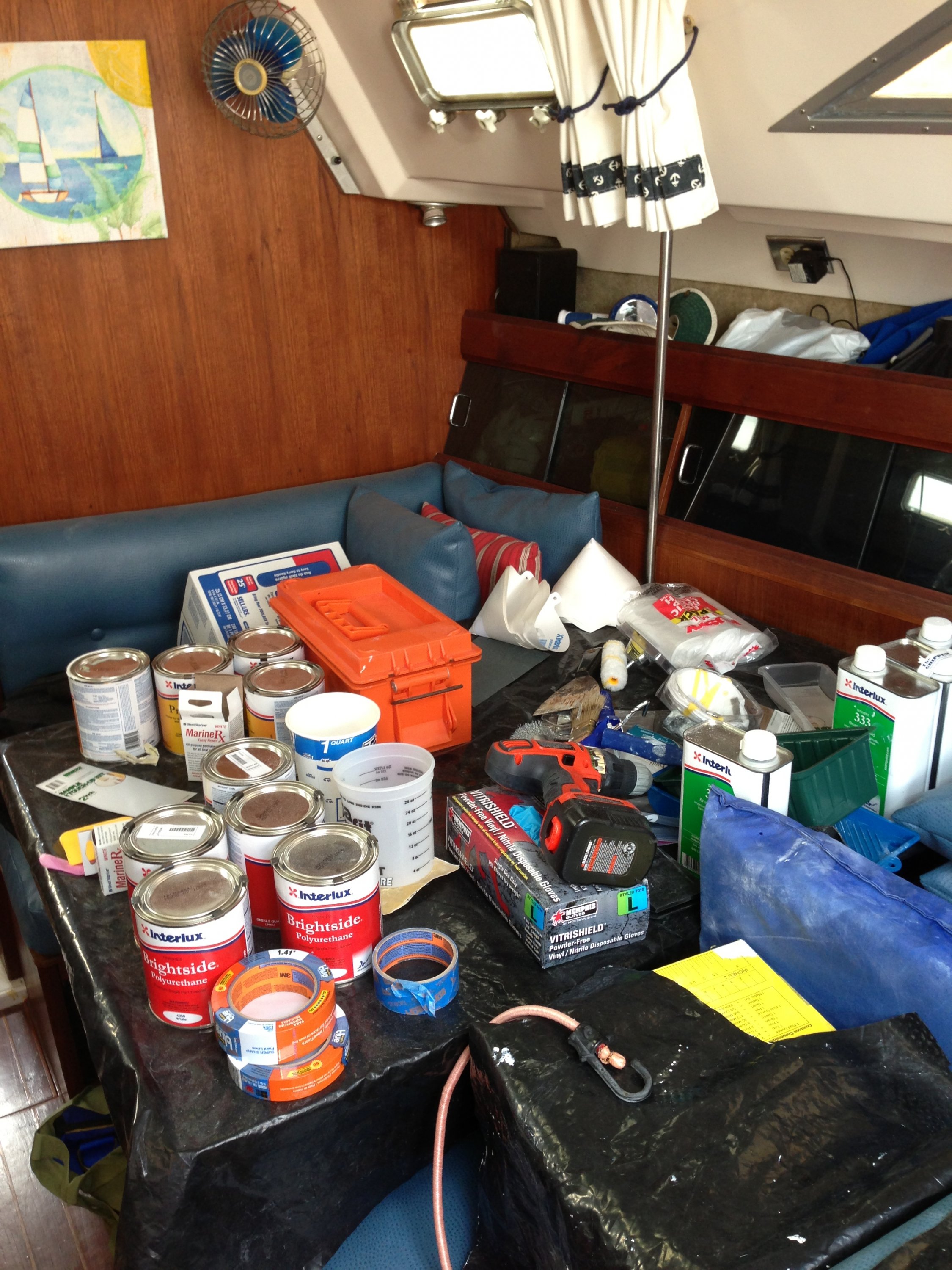

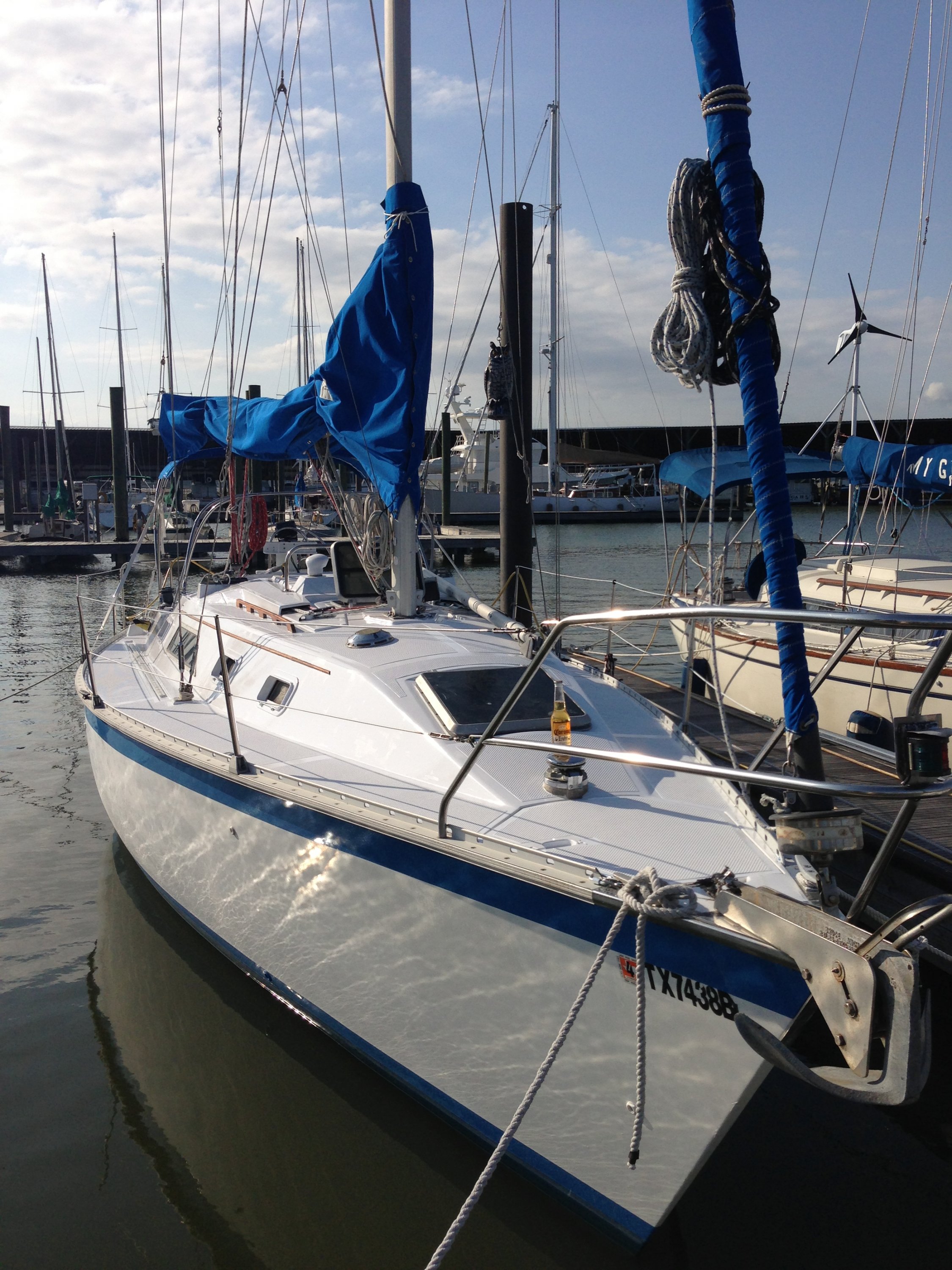

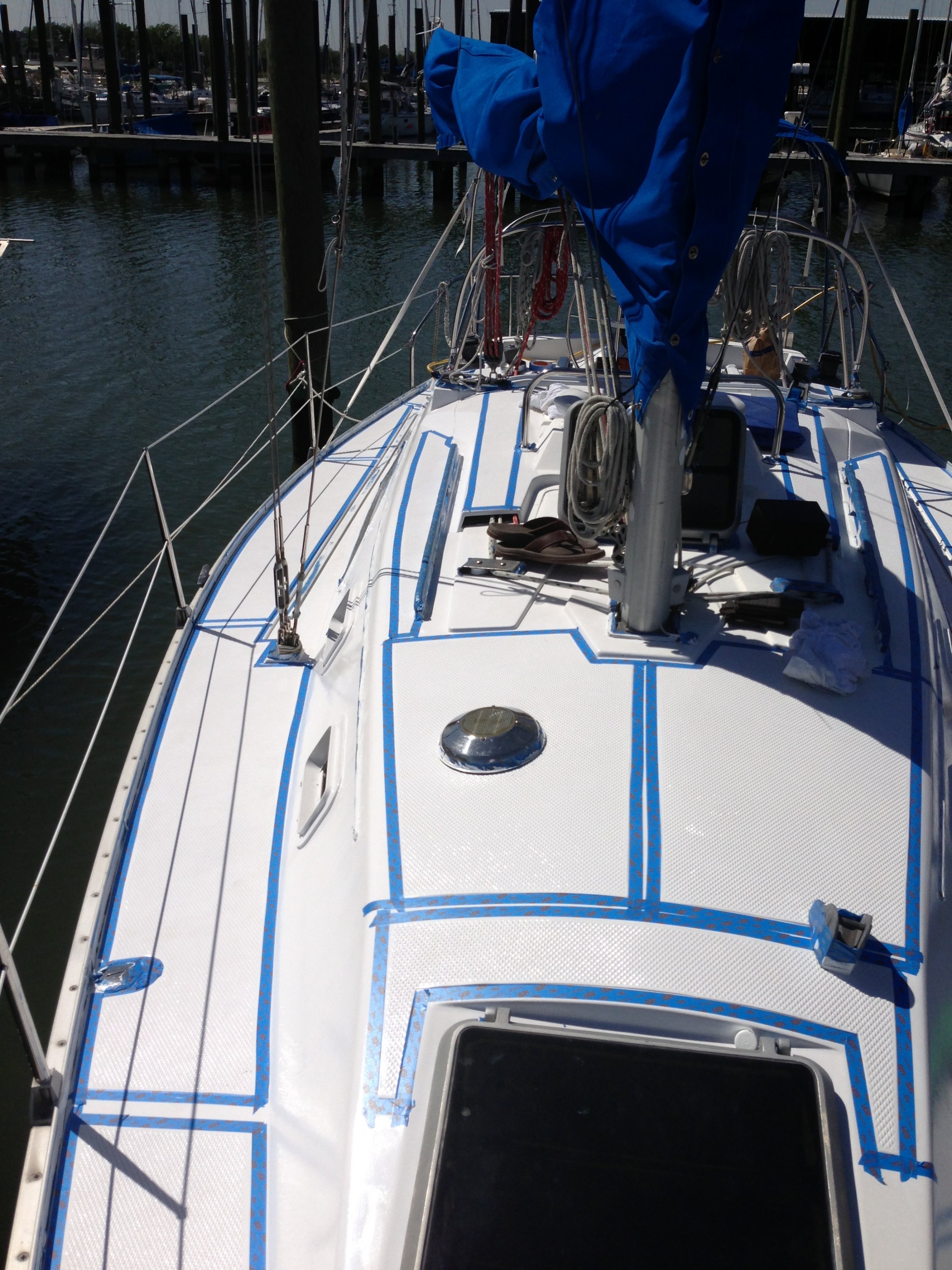

Mike, I painted mine back in 2013. Here is something I sent to someone posting about this same topic.
Tom, first Don Casey’s book This Old Boat is a great resource for any project boat. I have a copy at home and one on the boat. Also, Interlux has an ask the expert thing online, and I have actually called and spoken with some of their technical advisors and they are helpful.
Once you have committed to DIY, to paint the topsides the first thing you need to do is decide one part or two part. This was my first time to paint with marine paint or paint a boat so I opted for the less durable easier to use one part Brightside by Interlux. (Good reviews in Practical Sailor) I used white, where I live and in St. Pete even a light gray or beige can heat up. I mixed in Intergrip to the paint for my nonskid areas. This is a must, because just paint over the nonskid is super slick.
I bought the majority of my supplies at Home Depot or Sherwin Williams. You need smooth foam rollers 2in and 4in trays, tape etc. . For doing the molded nonskid you will need four inch with some nap on it. (I found the 2in very helpful for tighter spots.) You will also need lots of sandpaper, I bought a new sander that uses quarter sheets of sandpaper, the kind indicated in Don Casey’s book, it was a good call. I bought all of my primer, paint, cleaners and thinners online from a place in FL and saved about three hundred dollars over West Marine and local chandlery including shipping. Lots of foam brushes and one good badger hair brush.
Start with a really good cleaning, then remove every piece of deck hardware, hinges etc. that you can, I left the cleats. Then use Interlux de-waxing solvent 202 I used less than a quart. Wipe everything down liberally, then rinse (as directed on the can I think) I never found any gloves that would stand up to this solvent it ate through three pair of “chemical resistant gloves”. Then start sanding, you are not sanding everything off, just making it ready to take the primer. I forget but I think I went 80, 150, 220 before I primed. You do not want to get down to the fiberglass. Then fill and fair any holes or damage that you want taken care of sand those to smooth. Wash down, wipe down with Interlux 333 using two rag method. (one for wetting one for wiping). Then prime the whole topside, I rolled it on and tipped it. When dry, sand, wash wipe and paint.
I painted the whole topside with one coat, rolled and tipped everything. Did the deck one day and the coach roof and cockpit the next. Then taped off all the nonskid areas, mixed in the intergrip (stirring frequently) using the rollers with nap on them did two coats. I did paint the tops of the raised area just in front of the cockpit with the nonskid paint and I love that, otherwise that would be slick. I roughed up with a scotchbrite pad between coats on the nonskid. Pull the tape then paint the smooth areas, roll and tip. Sanding and wiping between coats. I kept the brush near by rolled a little area and tipped. I used foam brushes for all but the final coat where I used the badger hair brush.
One thing I did and was glad I did was take the tops off of the lazarettes in the cockpit took them home and practiced on them before starting full bore. It was very helpful and frankly encouraging to do that first. That way if it was a total disaster I could put cushions on them and be done.
I ended up putting some Seadek pads down in the cockpit floor, I really like them. My dad had thrown down some Awlgrip paint without prepping properly and it was coming off and I could not get it out of all the recesses so I covered it. Here are some pics. Before, doing and after.

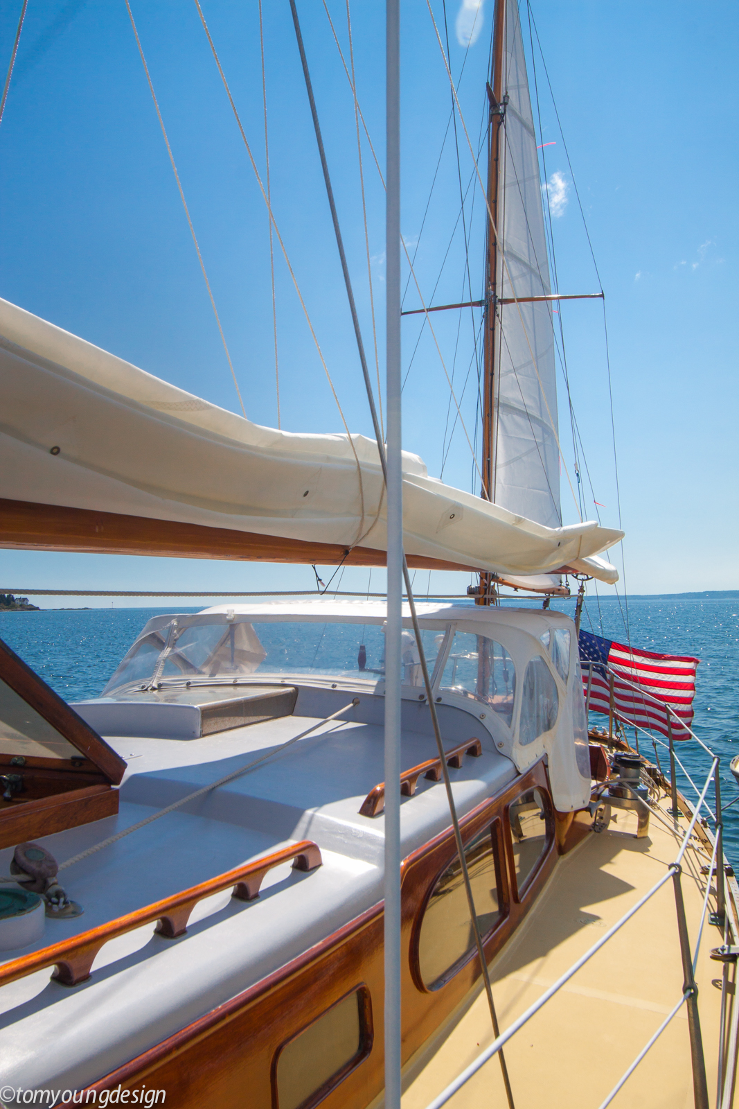

Your wife is right! 'Yacht' paints offer just so many colors, and that's what boats wear.
This is an acrylic enamel from my local hardware store. I've been experimenting with acrylic enamels on the boat for a decade or so. I like them, give me good use for one part. Although my hull and deck are fiberglass, I tend to follow the wooden boat system of one part enamels, and applying them more regularly.
I'm still painting on the original non skid pattern without grit. This finish isn't high gloss and has enough 'tooth' (with the non-skid pattern), in the paint (at least for me).
I use custom colors for the deck and house top, mixed at the store. I started with a buff and then tinted a bit more toward yellow. The house top (which is plywood with a fiberglass sheath), is a 'fog' shade of gray. Grays are always nice on deck.
