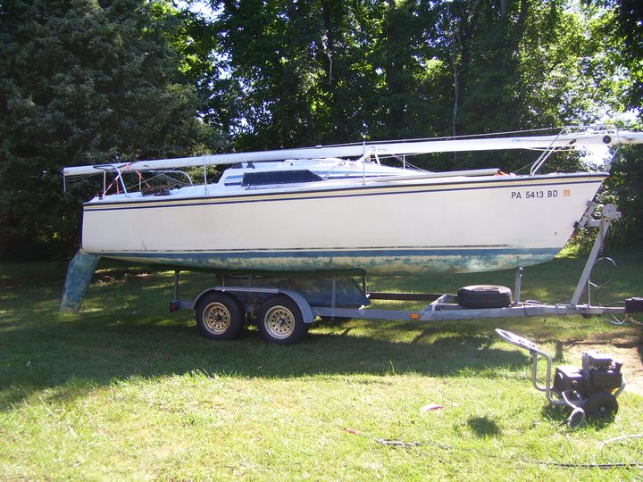

Here's a good photo of my setup. I added a second axle for highway stability. You probably don't have a rear railing; be prepared with something to hold the mast while lowered

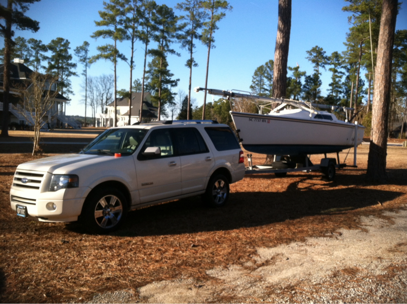

Today was the first time I EVER loaded my H23 satisfactorily! It was already on the trailer but way too far back. We used 2 come-alongs and a heavy strap around the keel to pull it forward. Thanks to BrianM for the tips!

Looking good Kermit. If you slide a piece of 1x2 on between the top of the tounge and the middle bolt of the bow roller you should be able to catch the bow. Give that bow roller a good smack with a sledgehammer, it should tilt/slide wherever you need it to catch the bow. It's just held onto the frame with friction...i'm not sure how important it is as far as supporting the boat, but it's a great reference when backing the empty trailer into the water
