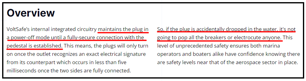

Yes, the VoltSafe Marine shore power plug is now at a “near-commercialization” stage and the one pictured on the site is fully functional and is an app controllable smart plug (however app not required to operate in default mode).

Indeed we are. Think of VoltSafe tech as a connector that has an electricity gate in place (whereas all pronged plugs have outlets with recessed metal that is always live). Additionally because our outlets are by default de-energized when not connected, there is no arcing when being connected. This also means if it is dropped into the water while plugged into the pedestal… nothing happens because it isn’t energized. It is only when opposite sides fully connect to hot-neutral-ground (and an electrical fingerprint check occurs) will power be allowed to flow 5 milliseconds afterwards.
