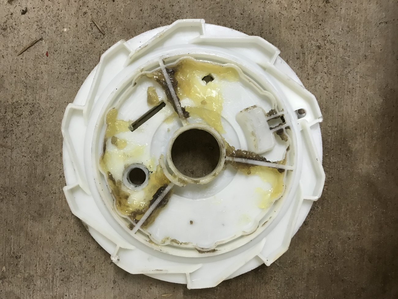

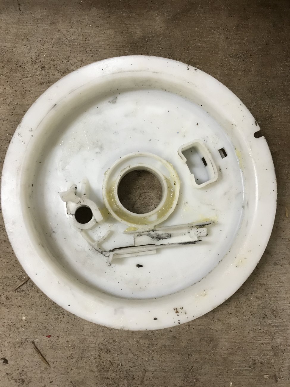

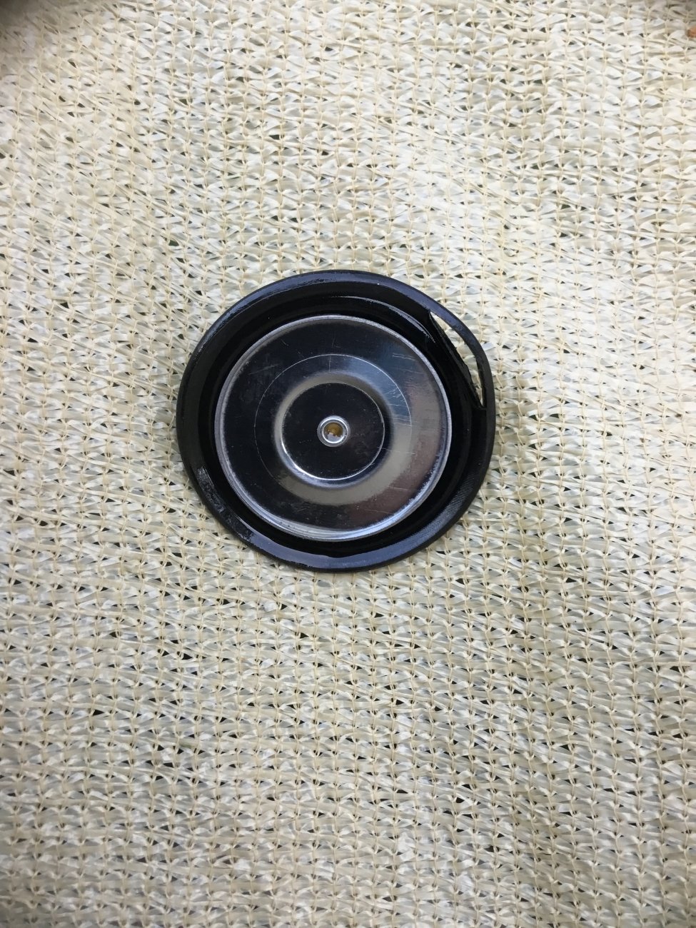

I’ll start here as a billboard for all you other LEHR suckers out there. Sorry a malcontent. Any guidance on my quandary would be appreciated. Hopefully you’ll see the diaphragm from the regulator of a 5hp purchased new in 2014 now with less than 20 hours. If this indeed is a Parsun than my Roketa which I ride on land has the same quality Chinese rubber. Yeah glutton for cheap punishment but these LEHRs weren’t cheap. Thanks for nothing West Marine bilge purveyors.
Anyway what are the chances of getting this part. Is there an any rubber diaphragm (i am sick of spell check correcting that word!) from any similar regulator in the world that would work? Gasket seal an option?

Hi there! I will resign my ID as of today since thanks to this board and further thanks to Dave K. my LEHR b___&m____ is officially over. Dave very graciously replied to my problem with hours and my part(s) are on the way. We will also replace the drum in another carburetor chamber. In addition we ordered the Heater Buddy filter for the propane supply from the two composite propane tanks that are used. Thank you MaintChief for that info since it was exactly what Dave diagnosed as the susceptibility of the Chinese produced rubber used to propane slime. Don't need any lectures there since I also own an unbelievably reliably performing Roketa 250 cc scooter since I bought it from Army Joe on Ebay during the gas crisis of '08. 16,000 fun miles later, I have replaced all the rubber on it. It does actually stink!
This Forum has been a virtual treasure trove of info and I thank all the contributors. I do have to say that whomever the principals are behind this obviously failed experiment (and I don't know about any legal entanglements) but just find a way to take down the website and redirect ever an error 404 would be preferable to the madness of keeping that zombie presence up. Its maddening! How this venture failed is also puzzling. I intend to travel with my Parsun/LEHR attached to my SOLO Skiff to the Mangroves and Snook of the Keys and would have wanted to purchase a replacement when the time came.
